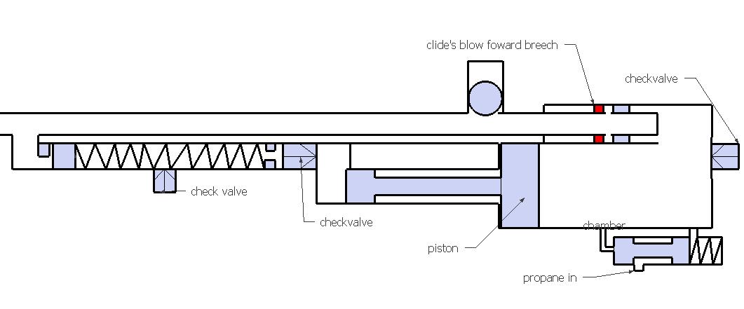

I finally drew up my idea:
sorry, you need to look at it full screen!
criticism welcome!
criticism welcome!

ramses wrote:I finally drew up my idea
I hate to be a killjoy, but I really don't think that's likely to work.
Not only is it likely to dump the new shot of propane during the combustion (however, reverse the locations of the in/out ports, that's solved - i.e. so they're exposed when the valve is the other way to how it is at the moment), and although the barrel pump idea is clever, I doubt that you will able to get sufficient pressure over sufficient time to get it to pump a full stroke.
However, the thing that really strikes me is that piston has no return mechanism.
But sort those issues, that could work as a design.
Ragnarok wrote:Safety reasons.
It seems pretty unlikely that anything would happen - how many of us have had a fueled spudgun go off without the sparker operating? What you could do is ensure a good non-return valve is fitted, and maybe include a burst disk in your reservoir that would blow out in a safe direction in case the unthinkable happens.
ramses, it has always been my contention that spudgun designs that bleed air from the barrel, especially with a low pressure combustion, will never work. Remember that automatic firearms using this system have chamber pressures of tens of thousands of psi.

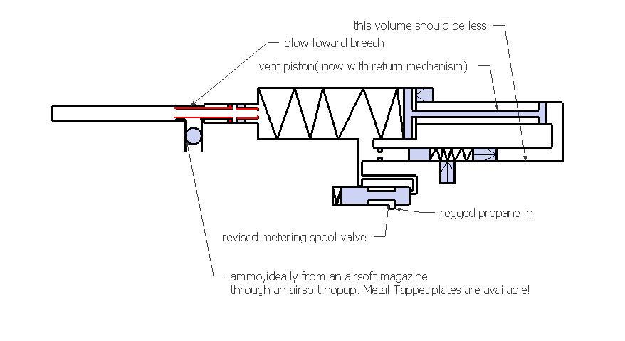

ramses
Posts: 1679
I realize the problems now and when I get a chance I will correct and re-post.
Edit: revised, and as always, not to scale, layout not final, inevitable changes will be made to allow full use of off the shelf fittings. I see that on McMaster, I will be spending over $30 on check valves alone.
once again, criticize away
slide in the breech is red for visibility
