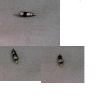

Ok i got really annoyed with all the fiddeling and just cut open the outer shell of the valve with a dremel, cooling it all the time, i now have this thing.(see pics) How exactly do i place it into my other valve now? :?:
The little thing inside my bike valve.
Valve part for replacement.jpg (8.88 KiB) Viewed 2461 times

Seriously, did you have to cut it out? its called using tweezers and all you had to do was unscrew it.....
I hope you didn't damage the core.
THINK?
We are telling you to unscrew the core, now I wonder...how would one place on?
MAYBE JUST MAYBE...you can TRY and SCREW it in.

Ok i was jut unsure, and it was obviously just rammed in, no tapping what so ever on the outer core(or the inner one for that matter) only tapped part was where it screwed into the pump.. And it is still ok, i tested it and it seal/opens when it should.

john bunsenburner wrote:Ok i was jut unsure, and it was obviously just rammed in, no tapping what so ever on the outer core(or the inner one for that matter) only tapped part was where it screwed into the pump.. And it is still ok, i tested it and it seal/opens when it should.
i can see the threads in those crappy resolution pics! you just screw it in!

I dont see them :? but i guess if you do, maybe i did not notice them. Ill screw it it and check the chamber, if it worked i will upload a crappy resolution pic of a rifle.

Ok i thank you all for the help, the sharder is ow fixed and working. Does any one know how much pressure the sharder will hold? I am planing to use a bulk tank and maybe i will need another valve altogether. If so, please tell me what valve i can use to fill the chamber and maybe even where i can get it.
