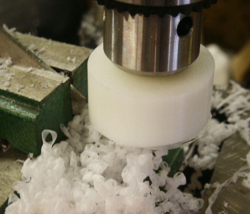

Compared to other materials, nylon is not especially light. You would be better off using HDPE. It machines well as far as I know, has an extremely low friction coefficient, and floats in water (about 80% density of nylon). It is also extremely tough and strong.
HDPE is also less expensive.

HDPE works well for me.Biopyro wrote:Compared to other materials, nylon is not especially light. You would be better off using HDPE. It machines well as far as I know, has an extremely low friction coefficient, and floats in water (about 80% density of nylon). It is also extremely tough and strong.
Edit
In smaller diameter valves, a close fit is low friction without o rings.

I can testify to that, I tried tech's HDPE method with the drill press and chisel and it works very well (remember to do everything up tight and have a firm grip, only take small cuts!)
