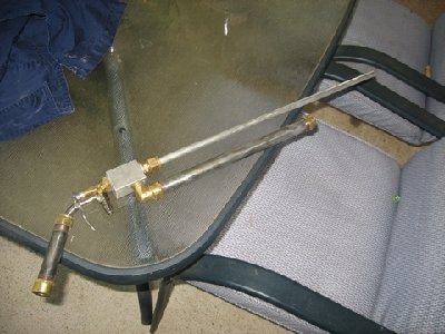

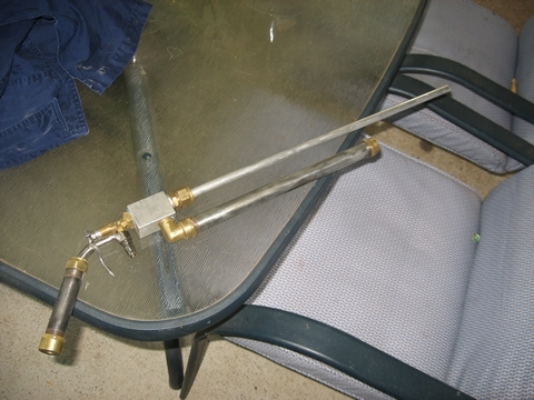

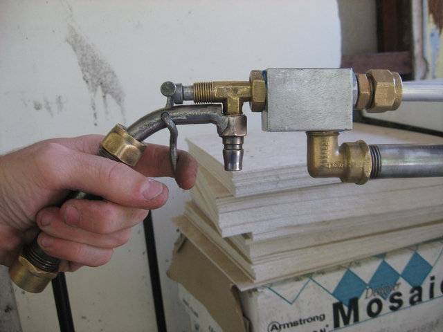

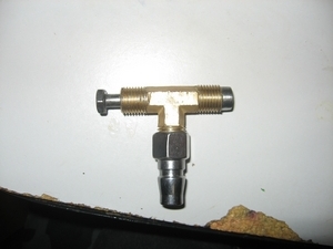

Hey guys,
I've been tinkering with the push button valve idea and this is the best I've been able to come up with. I think it's one of the best builds I've done and the most aesthetically pleasing. This push button valve has some serious flow. It actuates my marble piston gun faster than what my 1/2'' ball valve trigger that I used to use on my "whammy" and "BFS" guns not to mention it's really comfortable to hold.
My new pump is nearly complete and I'm pretty damn confident the push button valve could take around 300psi if not more.
Thanks very much :)

Wow Mitch congratulations that thing is beautiful. Your push button valve and trigger system is genius. What pressure have you taken it to? Is the trigger easy to pull?

Thanks a lot Jacob. I've only been able to max the compressor out but the o rings are as solid as my head. I have aluminum tubing behind the o rings so they have no chance of blowing out at high pressures. I'll be getting stuck into the pump tomorrow.
I found my old pop off valve so I'm gonna come up with a pilot valve that uses the same sort of fill and grip but use a sear to hold the pin to the pop-off in place. With no spring, it'll virtually explode open when the trigger is pushed and the sear actuated.

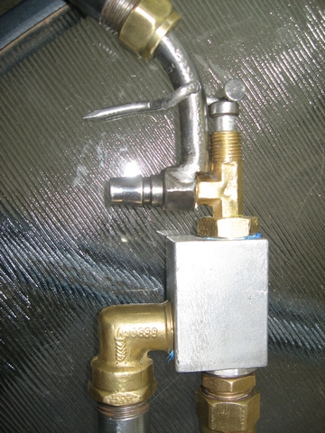

nice gun man, love the combo of brass and silvery look. how does your pushbutton release the pilot air? is there like a hole in the back?

Try the bottom... :idea:

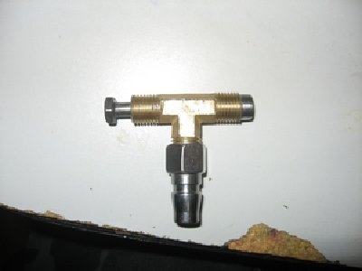

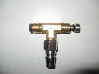

Hey guys,
Thanks very much for the kind words. I get those 1/4'' male tee's from my local hardware in the "air tools and compressors" section. Every place on earth should sell them in that section.
The gun pilots out the fill port. When I plug in the compressor, I pull the trigger the valve pushes in and allows the gun to be filled.
The bolt itself has been heavily machined down to give the give flow possible. Surprising what you can do with a drill press, a hacksaw blade and a file :D
Reactor4, this is a pic of the button pushed in. It shows the back of the bolt pushes through so that the o ring is pushed out.
Valve open. This is positioned directly behind QEV's piston so the gun pilots mighty quickly.
