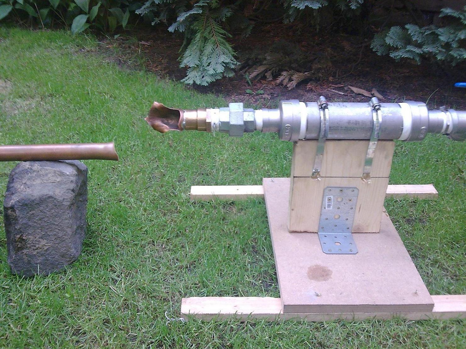

Shot at a 4mm thick Steel Plate at 20x and it went through without problems.

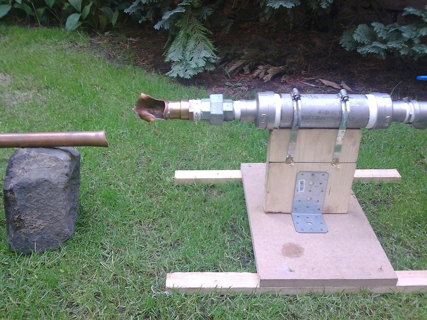

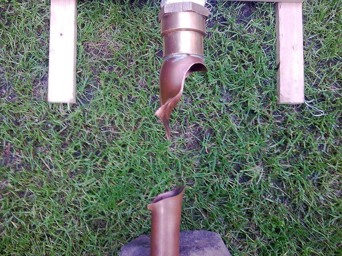

I tried to do it again (at 20x) to see if I can get through 6mm Steel and my barrel exploded :shock:

WOW :shock:
I guess that was loud. Hope you didn't get hurt.
Did you check the proper fit of the projectile (pushed it trough the barrel) before you fired?
I had my copper/brass gun in my trunk and after that only 1/3 of my ammo (marbles) were able to pass. I had to buy a new barrel because of a tiny dent.
starman
Sergeant Major
Sergeant Major
Posts: 3027
Location: Simpsonville, SC
That's some serious penetration there my man... :shock: Looks like the copper failed fairly "safely" if there is such a thing. Obviously, the copper wasn't up to 20x shock and stress requirements.
Any idea what the psi burst point of the disk was?

i can certainly place my money (and more that can't be mentioned (A) ) that you got two DDT's, i don't think just a small portion of the barrel would fail otherwise. atleast it should only make a tear i think.

and what size is the wall thickness on that copper tube,,in australia we have type a-d ( a )being the thickest wall

The round bulge before the break looks just like your previous experience. That sure is a convinving case for DDT having happened twice to you.

I used a burstdisk made of 0,3mm aluminum sheet. No idea what the burst pressure was.

Yes I pushed it through the barrel without any problems. I was standing 3 meters away and behind a brick wall so there was zero chance I would get hurt.
@MrCrowley
I live in Duisburg - North Rhine-Westphalia.
@FORE!!!!
The wall thickness of the copper is 1mm. There is a concrete wall behind the fence so don't worry :wink:

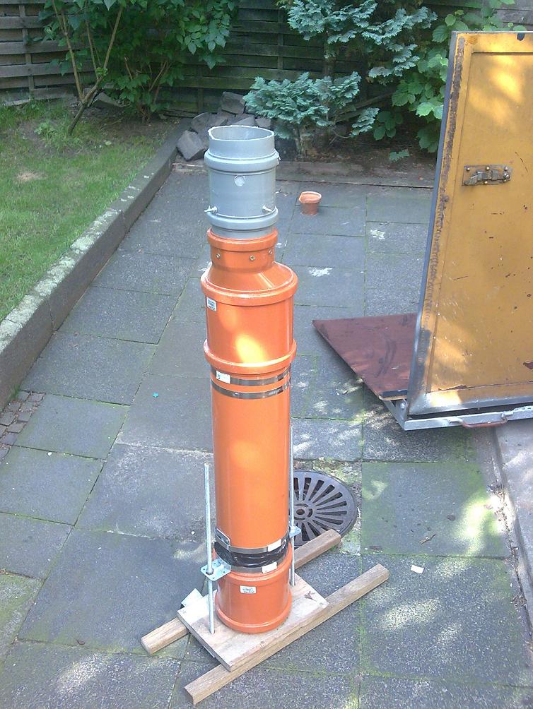

This is my new "Cannon". Its just a huge Combustion Gun without a Barrel.
I use 2-3 sheets of Paper as a burst disk and then about 1 pound of flour on top of that.
In the video it was Spray and Pray but now I got a Propane Meter + Chamber fan.
Will be nice for New Year's Eve :)

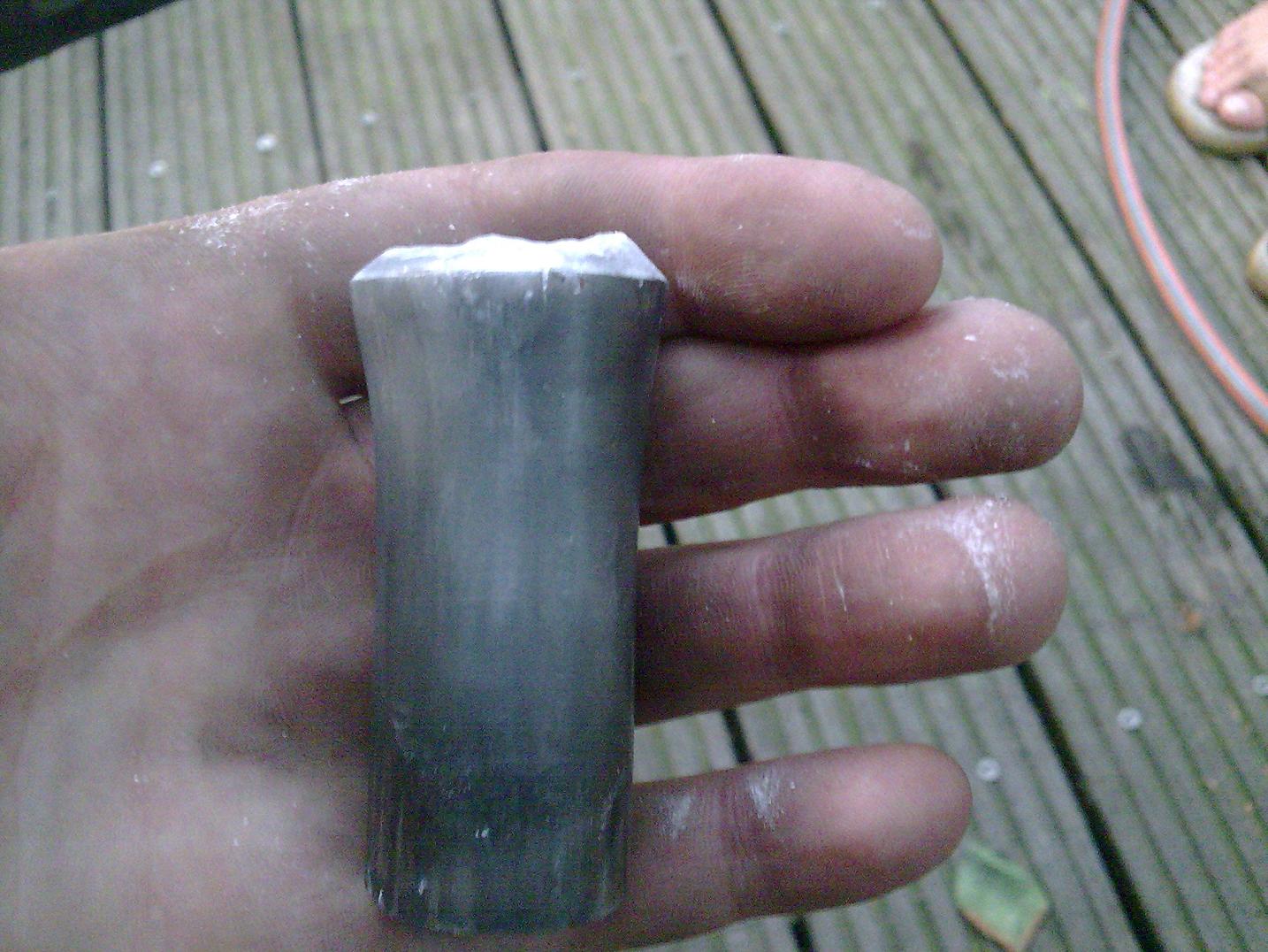

Very nice gun and that flattened lead round.Priceless,looks awesome.

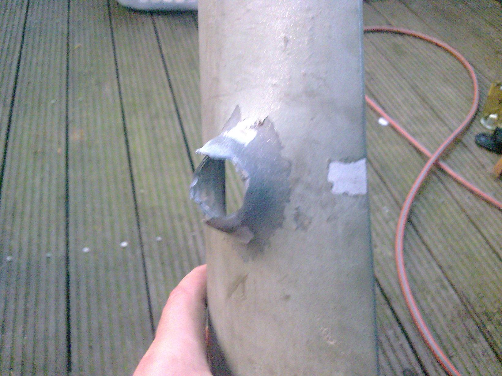

Here you go. Sorry it didn't blow up again :P
The Projectile made it through 7,5mm Steel and still had enough Energy to destroy the Stone behind it.

However, the C-beam penetration is very impressive indeed!!
