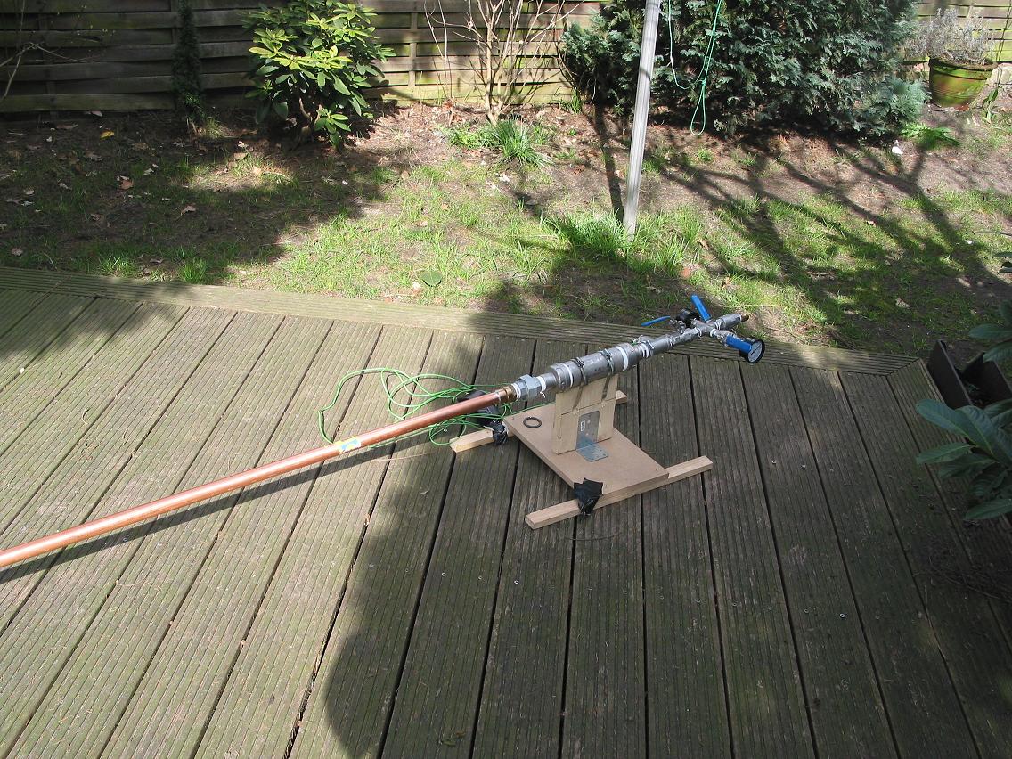

This is my first hybrid. I hope you like it.
Barrel: 2,5m long, 26mm ID, 28mm OD
Chamber: 20 cm long, 2'' diameter (about 660ml)
Ignition: Sparkplug + Stungun
Burstdisks: Alu. foil
Ammo: 200-500g lead
Mixes: 8-18x

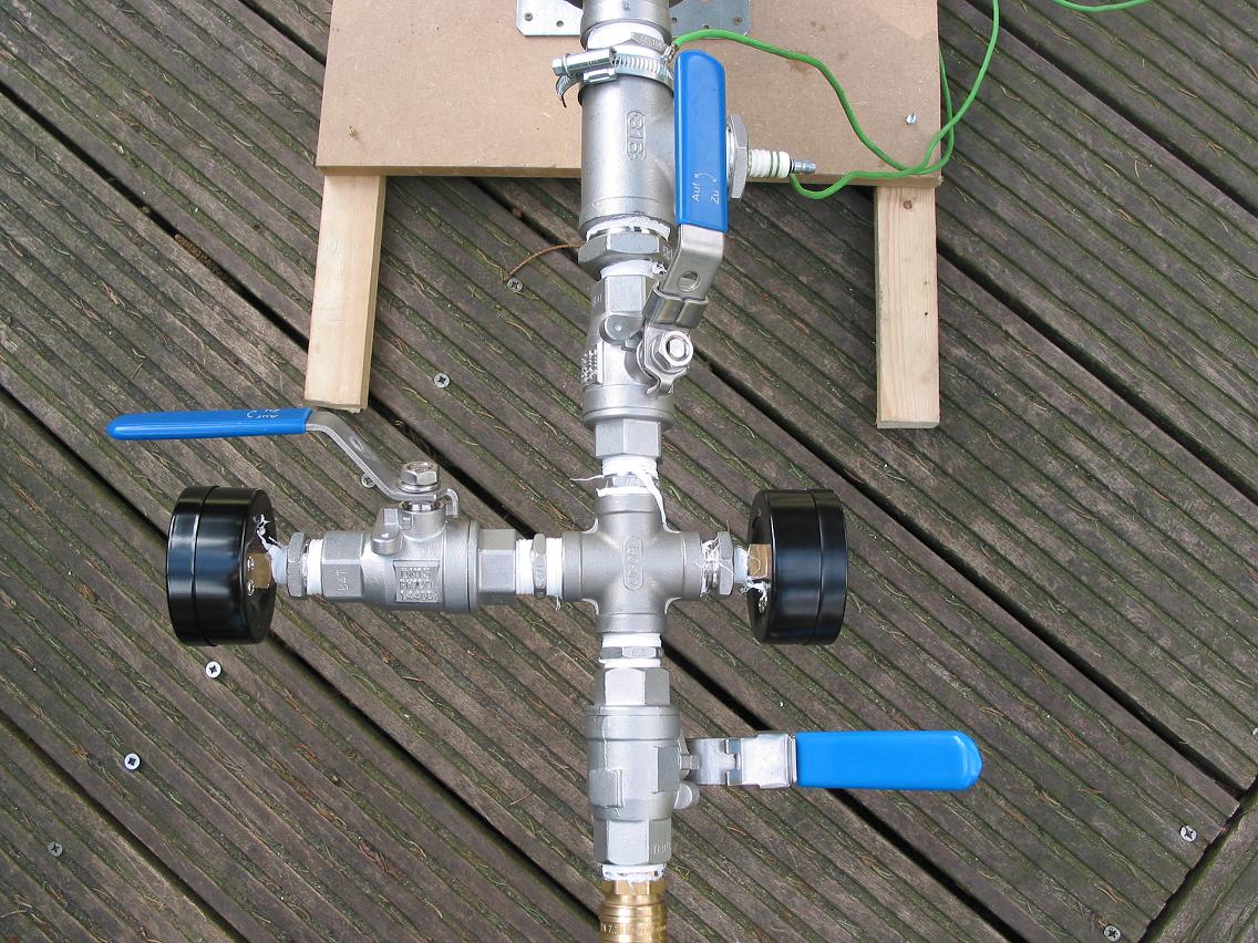

I built this cannon about 5 months ago. Back then i had to use my bikepump and was limited to 10 bar.

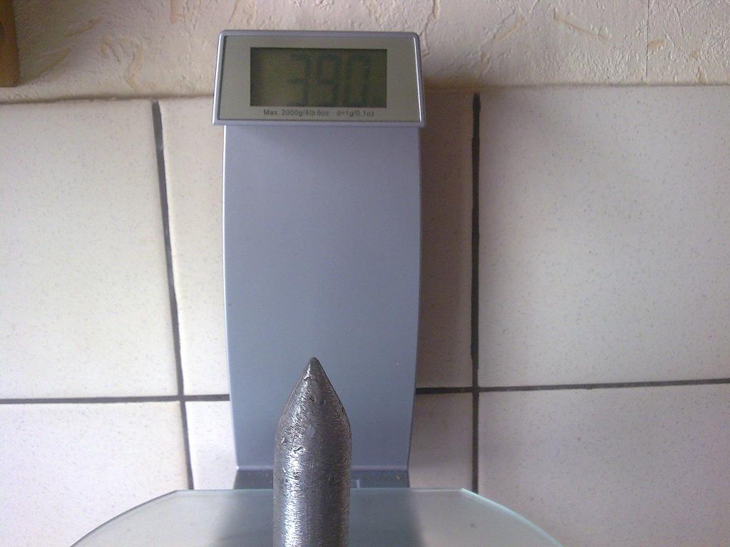

Using a 243g lead projectile at 8x my Chrony measured 62m/s which should be ~470 joule if my math is correct.
A few weeks ago I finally got my fridge compressor and now I plan on taking it up to 20x.
I was only able to fire it one time at 18x because im having trouble sealing it above 16bar using Alu. foil as a Burstdisk.
Maybe I will try soda cans or something else next time.
Greetings from Germany

390g lead projectile

vince wrote:Using a 243g lead projectile at 8x my Chrony measured 62m/s which should be ~470 joule if my math is correct.
Your maths is correct, but that sounds very low for an 8x hybrid with a barrel of those dimensions. As an off the top of my head guess, I'd expect 3 to 5 times that muzzle energy.
This may be indicative of either a problem with the chrono (possibly how it's being used) or a performance inhibiting factor in the cannon, like blow by in the barrel, slow burn rate, bad fuel mixes or a poor C:B ratio.
On the note of C:B ratio, I have to say that from the pictures, that doesn't look like a 730 ml chamber - it doesn't look like it's 30 cm long.
This is impressive, but I'm sure you can get more out of it.

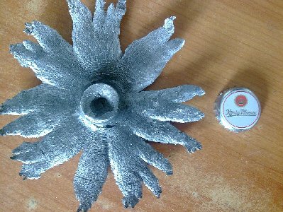

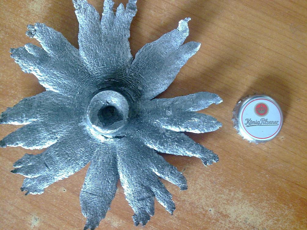

That is one beautifuly splattered lead round! Put that little guy in a shadow box.

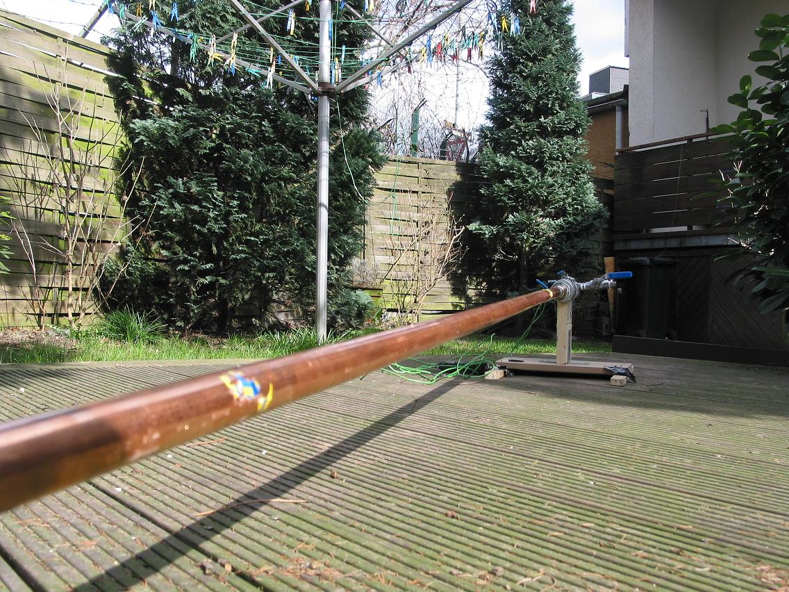

You should look into making a stand that can absorb the recoil with a set of springs or something similar. I'd hate to see that thing fly back and do something unexpected.
so many muchness

@Ragnarok
You are correct. The chamber is in fact only 20cm long and has a total volume (with the T with the Sparkplug in it)
of 660ml. Im sorry I got it wrong and I edited my original post.

Yeah I already thought about something like Larda uses on his beautiful hybrid to absorb the recoil.

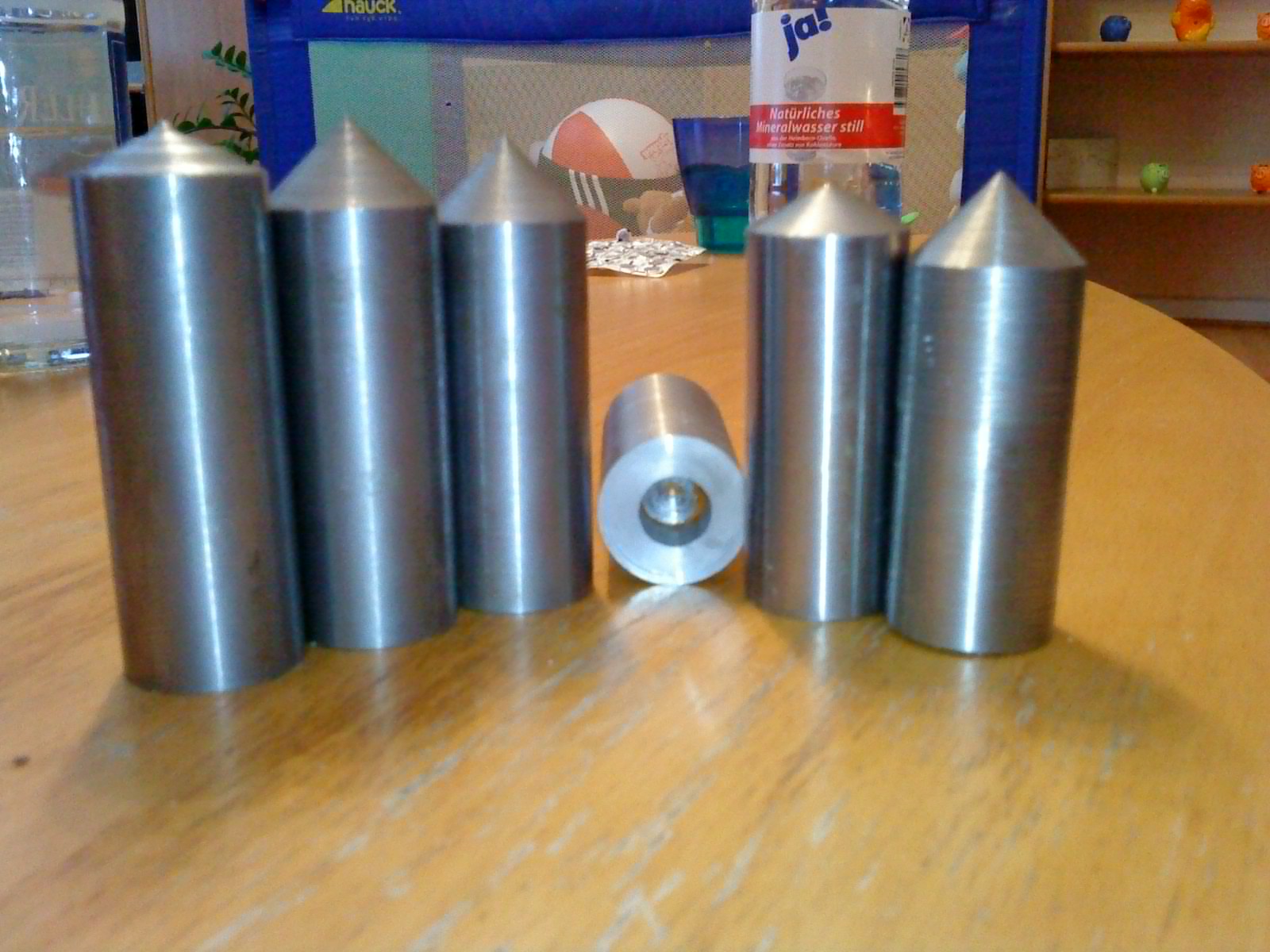

I will use a Steel Barrel as soon as I can find one that is smooth on the inside. It would also be nice if I can find one that has the same ID as my Copper Barrel because a friend just sent me a Picture of some
sweet 26mm Steel Projectiles he made for me :)
They are between 70 and 80mm long and weigh 250-270g.
