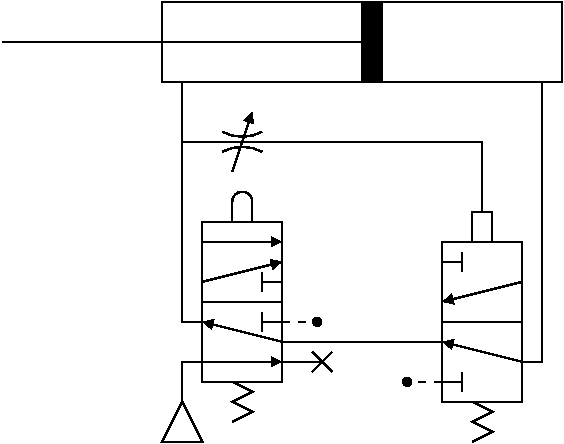

Here's the basic setup of the water gun:
I'm not going to explain the symbols so Google for "pneumatic symbols" or something to that effect if you're confused. Clippard's catalog also has many of these.
The air cylinder pushes a piston which in turn pushes water out of a nozzle.
The cycle is broken into two main parts, the first of which has two parts as well:
Filling: (1) The trigger is not depressed (the DCV on the left is the trigger valve). High pressure gas flows from the right of the air cylinder to the left such that the air cylinder retracts, pulling water into the water chamber (water chamber and associated water valves not shown). The two chambers eventually equalize. Getting a full stroke requires exhausting the right chamber... so... (2) the needle valve should provide the right timing such that the air pilot valve exhausts the right chamber when necessary.
Firing: The trigger is depressed. The left side of the cylinder exhausts and the right size is pressurized, which in turn pressurizes the water and the stream is shot.
Not too complicated is it? Maybe it is.
Further modification of the design might be necessary if the air cylinder doesn't exhaust quickly enough. Small QEVs will solve this problem.
This water gun has a number of advantages over other designs, namely...
- No pumping
- Water can be stored in a non-pressurized tank
- Gas use is more efficient than other piston designs as still pressurized gas left in the chamber is recycled for the filling stage
- The only limits on performance are budget
The biggest disadvantages of course are the relative complexity of the circuit, the cost, the potentially difficulty getting these parts used, and the check valve that must go in the water nozzle assembly.

if I understand it in the right way you want to use the air cylinder to retract and fill the chamber with water (not shown in the pic) and then extend rapidly to 'fire' it
right now there is nothing that causes air to flow from the right to the left of the air cylinder in filling stage...
also it seems that you could achieve the same result with a 5 way valve only...
The check valve does screw things up a bit. Thanks for pointing that out. It was a last minute addition not fully thought out. I'm fairly certain a 4-way pilot valve would work... I'll check... (No it wouldn't--it would separate the left from the rest of the system and not allow it to be vented when it needs to be vented. Back to the drawing board.)
And while I could achieve the same end result with the right valve, it wouldn't be as efficient. See point #3 in my list. I want to use the high pressure gas from the right of the cylinder for the pumping part. This would increase the number of shots you could get from a gas source substantially.
Edit: It might be easiest to make a separate button to vent the right and separate it from the left... or that could be piloted...
Edit again: I think I figured it out. Replace the pilot valve with MMA-41PAS, put it in the right location (where the check valve used to be) and the system should get the desired functionality... I will post it later to verify.

the check valve stops air air flow to the air cylinder so it won't extend ever... I didn't notice that earlier...The check valve does screw things up a bit
I was reffering to the fact that simly joining the right an the left side of the aircylinder doesn't help... the cylinder would stop right in the middle of its stroke
or is there something I am missing??
EDIT
ohh right... chambers A and B that you've mentioned before are both sides of the air cylinder...
I think that what you want to achieve could be done in a much simpler way but I need to think about it
EDIT no2
ok this is how you can simplify your design... but IMO that could be much simpler

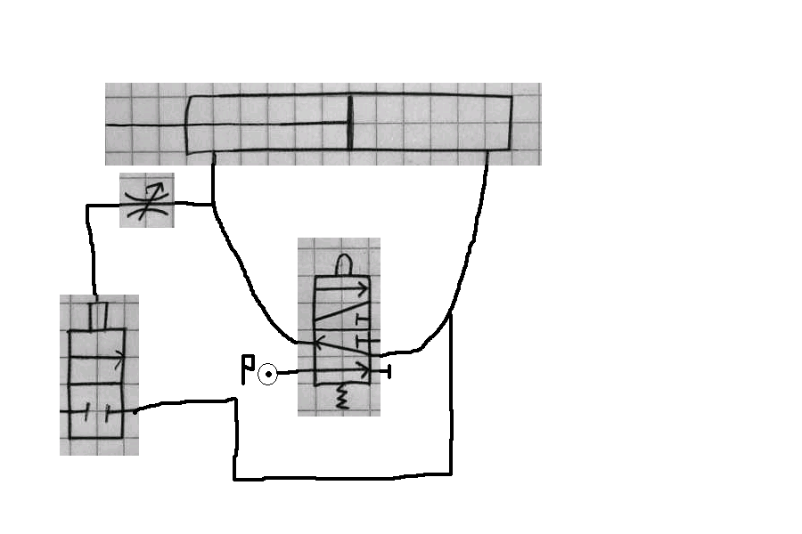

I must have been tired this morning because the check valve wasn't even what you were talking about. Heh.the check valve stops air air flow to the air cylinder so it won't extend ever... I didn't notice that earlier...
The stopping is what the pilot valve should fix, as you've figured out by now.
Your drawing has a problem. When the right side of the cylinder is vented, so is the left. My new design is essentially what you have drawn with a different pilot valve that'll stop the left from venting when the right does. So that's how to do it and be more efficient.
If you can think of any simpler way to recycle the air in the right chamber, I'd really appreciate it.
I'll put a new drawing (perhaps one made on a computer) tonight.
Edit: See the attachment. Xfig's gif output is fairly crappy so if a smoother file is preferred let me know.
- circuit.gif (3.98 KiB) Viewed 2447 times

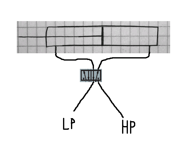

- POLAND_SPUD
- Posts: 5402
here is how I would do it...
LP is low pressure source... use as low as can do the job in order to save air
HP is high pressure source
my idea will waste some air.. but so will yours and it's much mroe complicated and will be much more expensive
I've been thinking for about 2.5 hour about possible solutions to this... my brain hurts and I need a brake now

I think you are trying to overdo it... I couldn't find one commercial design that does what you want to achieve... I am not saying it's not possible but probably it's not practical
there are other things that you have to concentrate on in this design...
you'll really need a valve with very high flow if you want the air cylinder to extend fast enough to fire water... IDK how large your launcher will be but 1/8" valve seems to be too small
you could probably use a QEV but that would make things more complicated

See the edit in my post before this to see my circuit. Your solution is one that'll work, but it'll need two regulators at the very least, and it'd be wasteful as you've noted.
Any single chamber piston water gun inherently wastes gas... putting any of the gas leftover after expansion into another job is an improvement.
High performance is not a goal. The cylinder will be moving on the order or 5 to 10 inches per second (to get a water flow rate of about 250 to 500 mL/s). I don't think a particularly high flow valve or a QEV is necessary to do that.
And as I intend to use 200 to 250 psi in this (due to force division--the water will be under less than 70 psi), the mass flow rate will be higher due to changes in density. Regardless, even if the regulator, etc. couldn't keep up, what air is in the cylinder should be able to expand (most water guns operate from a limited amount of high pressure gas expanding nearly completely).
I'm not really too concerned about cost... I've been able to find things for fractions of the new cost used as you have. I think a water gun like this would be neat, but if it cost is near or above $300 it probably isn't worthwhile.

so I was right that you should buy MMA-31PAS
yeah this will work.. at least I couldn't find any reason for it not to work... good job
I found this pdf. document... covers most of the basic stuff... right now I am downloading a free CAD programme for drawing pneuamtic circuits... once I test it I'll tell you if it's useful
maybe it would be a good idea to write an article on directionally control valves and pneumatics on wiki ?? or just a page with links to most informative documents on the net... I think it would be better if it was written by a native speaker of english...
yeah I know... what a lame excuse
EDIT
here (6mb)
it's nothing special but allows to draw neat diagrams... it can export them as .dxf or .emf files... I've never hear of them but irfanview could open them... I'll try to find something better later

Well, it's not MMA-31PAS, it's MMA-41PAS. Same thing; the one I'll use is 4 way.
That's a pretty nice document on pneumatic symbols. It's a shame I didn't have that a few days ago.
I was initially excited about a simple program to make pneumatic circuits but sadly Wine on Linux won't run it... Xfig does a good job so there's no serious problem.
Now the issue is finding these valves or something compatible on the used market... I can find big pneumatic cylinders without too much difficulty. 1 to 1 1/2" cylinders with decent strokes aren't too expensive ($40 at most). These valves are awfully specific though. Good thing I don't intend to build anything for months.
Edit: I'm also going to start thinking about ways to make this fully automatic. That'd be nice.
