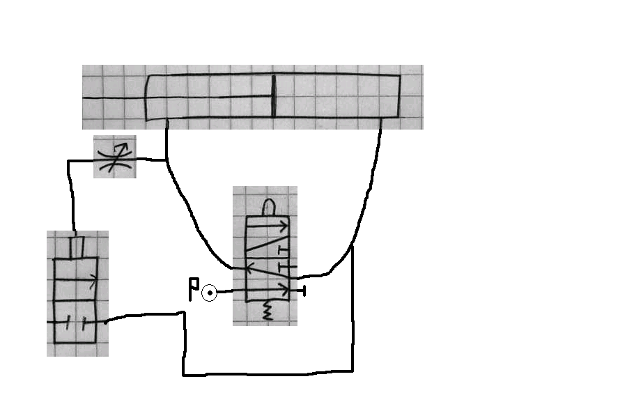

I need a valve as described is all that's necessary to understand. I'll make a diagram later today of the setup, but the explanation of how the water gun works will likely complicate matters further. This basic cycle isn't too complicated; the problems come from attempts to make it more gas efficient.
I'm not looking for a regulator. Pneumatic cylinders actuating a valve would do the trick, but it is more complicated and bulky than an air-pilot valve and an orifice for timing. (Note that the similar approach of a valve with a small pneumatic cylinder opposed by a spring with the position of one end set by a screw with the cylinder pushing on a spool valve is how I'd make one of these valves if I were going that route. Sorry if that's hard to understand.)
It's less about pressure and more about the position of a piston. But, the piston will stop due to a pressure differential; so by extension it's also about pressure. Making a switch that notes the position of a piston is far more complicated than measuring the pressure of a chamber.
I suppose the valve I want doesn't exist (yet). I'll get an explanation up later today anyway. Maybe someone can make the design avoid this problem completely.
