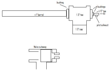

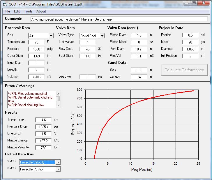

Just wanted to run this by you guys before I buy the parts. The fittings are steel rated for 3000psi. The chamber is as small as it is to keep size, air consumption and noise down. It will be run off hpa regulated to 1500psi, although I'm sure there will be a few full power shots :lol:. I'm not sure of the valve specs in ggdt, I tried to put in what made sense. Also, what would be good to pilot the valve with, I was thinking a pressure washer valve because they're rated high enough?
I can't seem to find too much info on higher pressure cannons when I search, so any input is appreciated.

Novacastrian
Posts: 1603
1500psi Holy crap :twisted:
Edit: why use a 20 grm projectile? Also inner dia shows 0?

Well I'm sure I'll end up using different things, but I'm designing it (especially the breech) around saboted arrows and I think that's roughly what they'll weigh. Inner diameter is 0 because the chamber isn't around the barrel it's off to the side so to get the volume right I had to do that.
Novacastrian
Posts: 1603
With a decent length barrel that ggdt you did is B.S.
1500psi should be supersonic at least :?
Edit: With a lighter projectile.

Novacastrian - With a light projectile I think it should too. The consensus here seems to be that you can't go supersonic with a pneumatic, but some commercial pcp air rifles do, which says to me it's possible with a fast enough valve and high enough pressure. If not, it will still make for some sweet damage pics :D

As for the barrel length, there seems to be diminishing returns after 2-3' because the chamber volume is so low, and I don't want the cannon to become too awkward. One of the nice things about high pressure/low volume is that you can make things more compact for the same performance. It will also help with silencing too, I hope - there won't be much pressure left after it expands in the barrel and a silencer that's much bigger than the chamber. Yeah I'm definitely going to work the pressure up, I have no desire to lose a shoulder. Do you know how the kinetic energy in ggdt compares to that of a rifle in terms of recoil? Like would a rifle with 3000ft/lbs have 3 times the recoil of a pneumatic with 1000?
Recoil is a question of momentum, ie velocity x mass.
Let's take a typical 7.62x51 NATO rifle firing a 0.0095 Kg projectile at 840 m/s. The recoil forces will be around 16 times higher for this rifle than for the performance projected in your GGDT model. Note that "felt" recoil is also a variable, ie the heavier your launcher, the more recoil it will absorb and the less it will be felt.

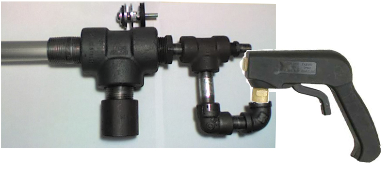

Finally parts arrived! 3000# sure are solid :P . Don't have time at the moment to build it but I mocked it up to see what it looks like. Don't have the pressure washer gun yet but that's the style I'll get. Ended up getting a 1" tee due to costs, the barrel is aluminum 1"OD, 7/8"ID...I may have to sleeve the first bit for strength. Decided to go with a bolt/washer piston for strength, as pictured it weighs 62 grams minus whatever portion of the bolt I end up cutting off. I think the barrel will be sealed in the nipple with orings so that the projectile can be as close to the piston as possible and by not notching the barrel in half and using a sleeve over it sabots will stay together better. I'll probably end up putting it together soon and just testing with a bike pump and then do high pressure tests and build the shell/integrated silencer over winter break when I have more time/money.

Posts: 980
Ok of the few things Ive messed with and never posted high pressure pneumatics are something you want kept nice and simple. Use a decent ball valve as a pilot and DO NOT use it hand held if your running it at 1500 psi. 500 psi blew out a tripod I made. Make it like a big artillery cannon. Thats all I can say.

those triggers are rated to 1500 or there abouts, dont worry on that one twitch, let it be.
