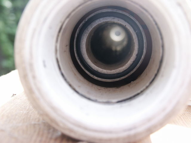

Mouse musket breech with the o ring.

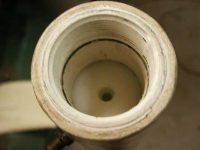

Close fit works well.  Piston in the new home.

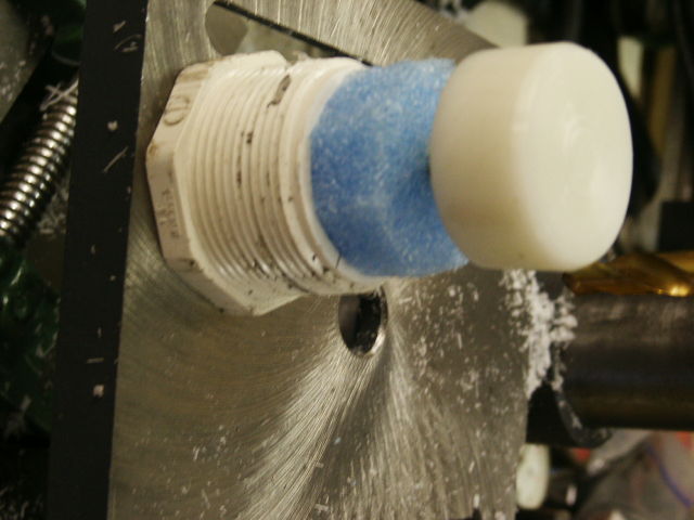

Breech parts with piston, bumper, and pipe plug.

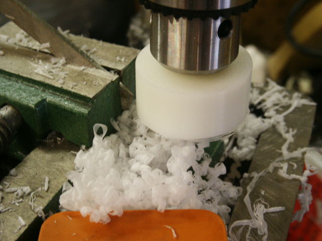

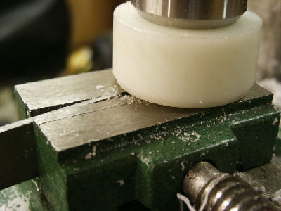

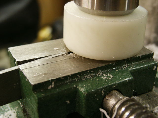

Cutting the piston face true and smooth.
Turning the piston with a drill press

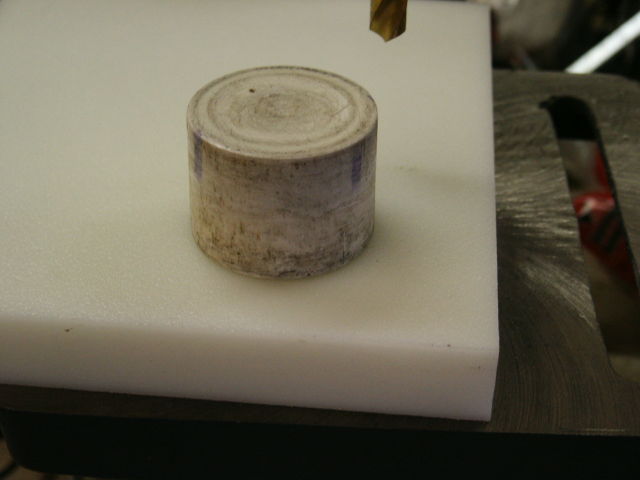

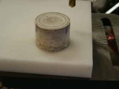

Sheet of HDPE  7/8ths inch thick.  The old original PVC pipe cap piston is sitting on it.
