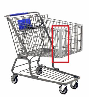

I used the bumper from the corners of shopping carts the make the piston in my 2" valve.

I used the rubber corner piece on a cart, I had one that I took apart for my tricycle.
the corner piece
the corner piece
lolz how did you get a shopping cart

haha what teenager hasnt "acquired" a shopping cart for various activities. Or you can just find them in junk yards or recycling centers.
