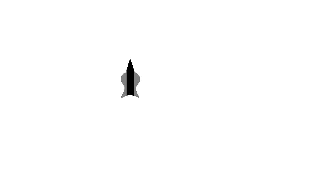

How about a diagram?
sure :)
This would be simpler to make and fly straighter:

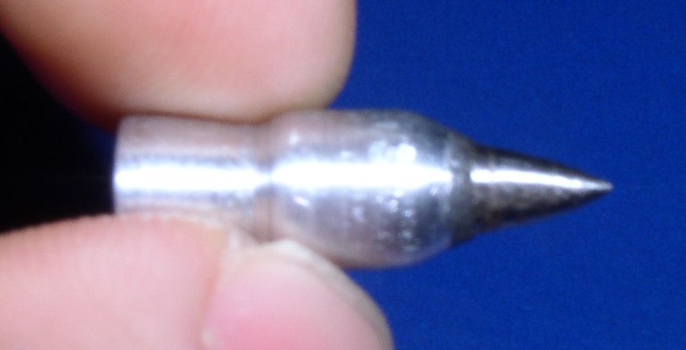

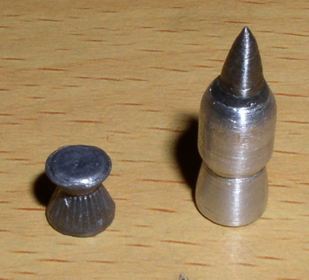

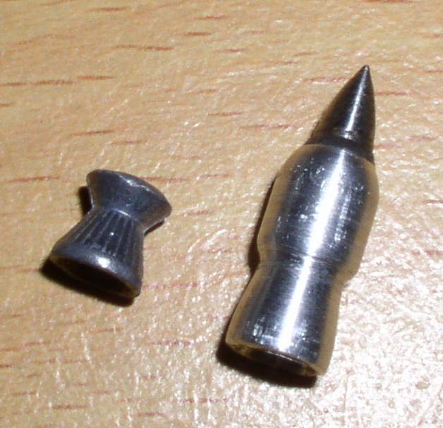

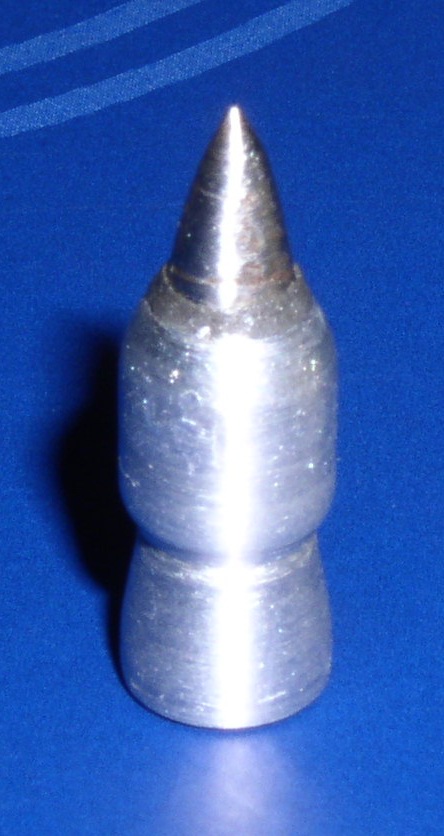

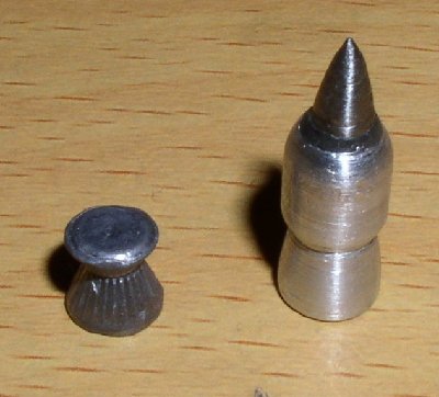

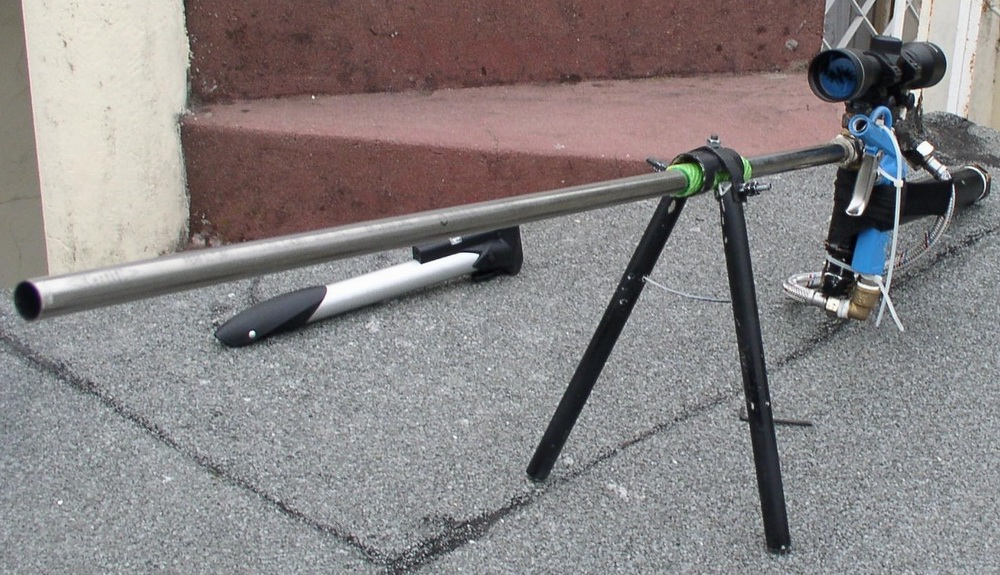

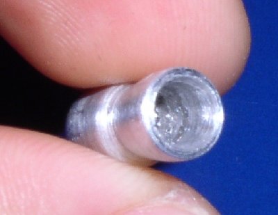

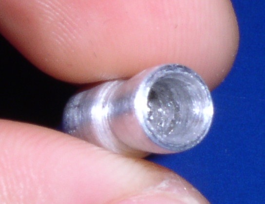

Here is the finished product :P a smaller version of the real one(6mm not 8mm), a bit longer than the original design. mass concentrated in the front. Going to test it with the best air gun I have(the most accurate and has enough power to have a long range in this case 100m with normal air gun pellets) this weekend. Then i will make the real pellet of 8mm :D
compare with a normal air gun pellet
the gun
the gun

Sectional density. Want more sectional density in the front half. The way I understand it is if you decrease the inertia and increase the drag on one end, it's a lot easier for the projectile to pivot on its center of mass so the tail points back.
I may not even bother making the first one... but that's up to you. It'll certainly look awesome if you can make a design like that work. :D

Looks a bit like the JSB Predator, weird.

saefroch wrote:Sectional density. Want more sectional density in the front half. The way I understand it is if you decrease the inertia and increase the drag on one end, it's a lot easier for the projectile to pivot on its center of mass so the tail points back.
agreed. I will improve the design and take out some section density of the back. @JSR I did have in mind some similar ideas as that pellet when i designed it
