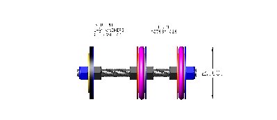

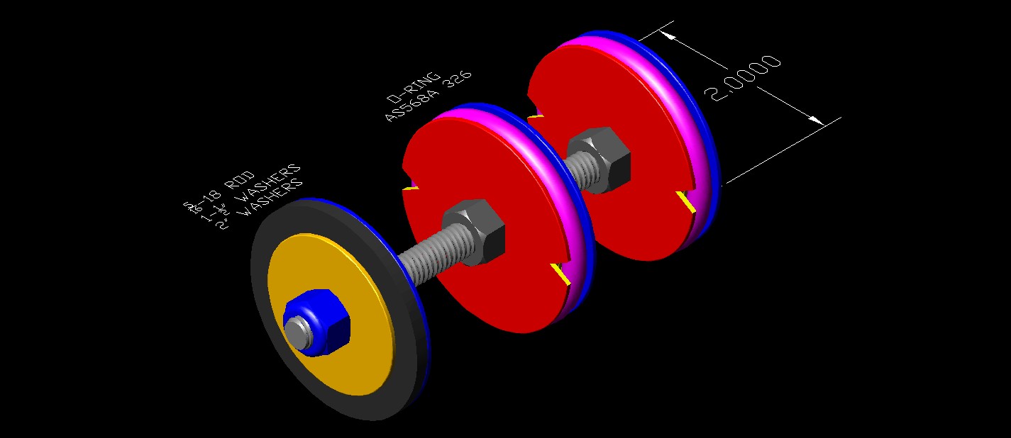

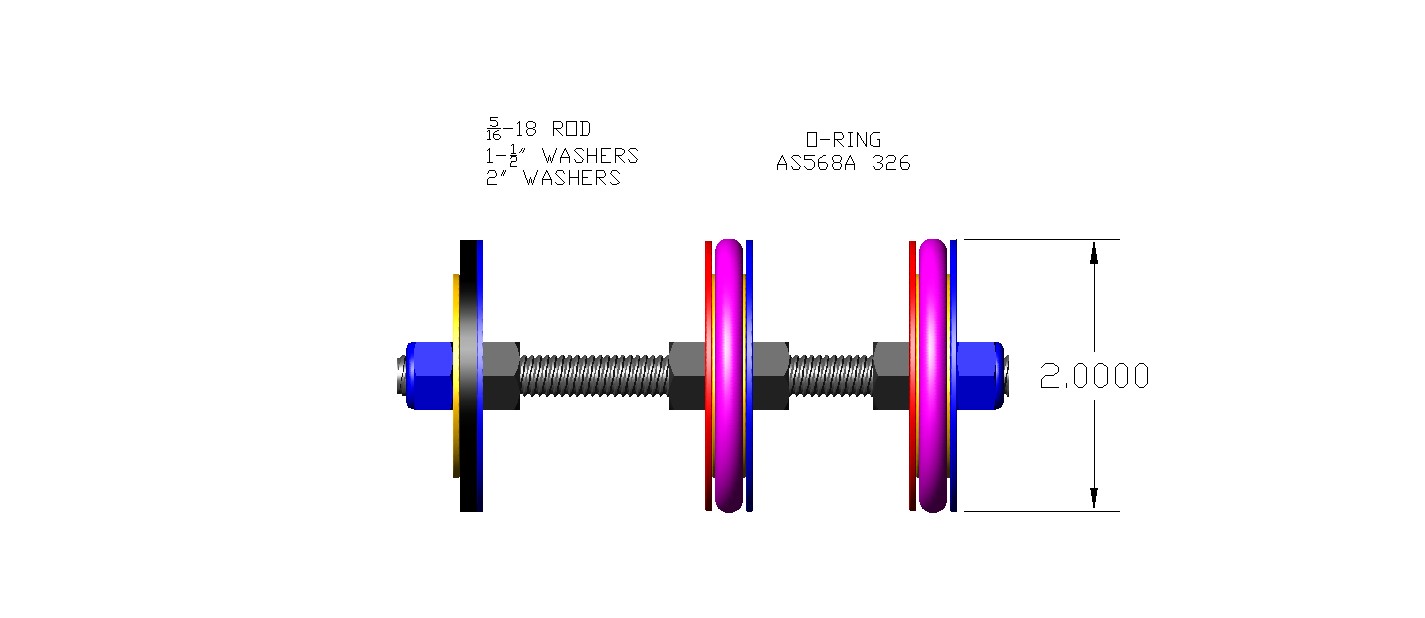

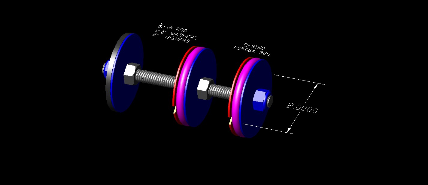

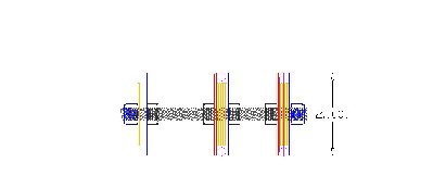

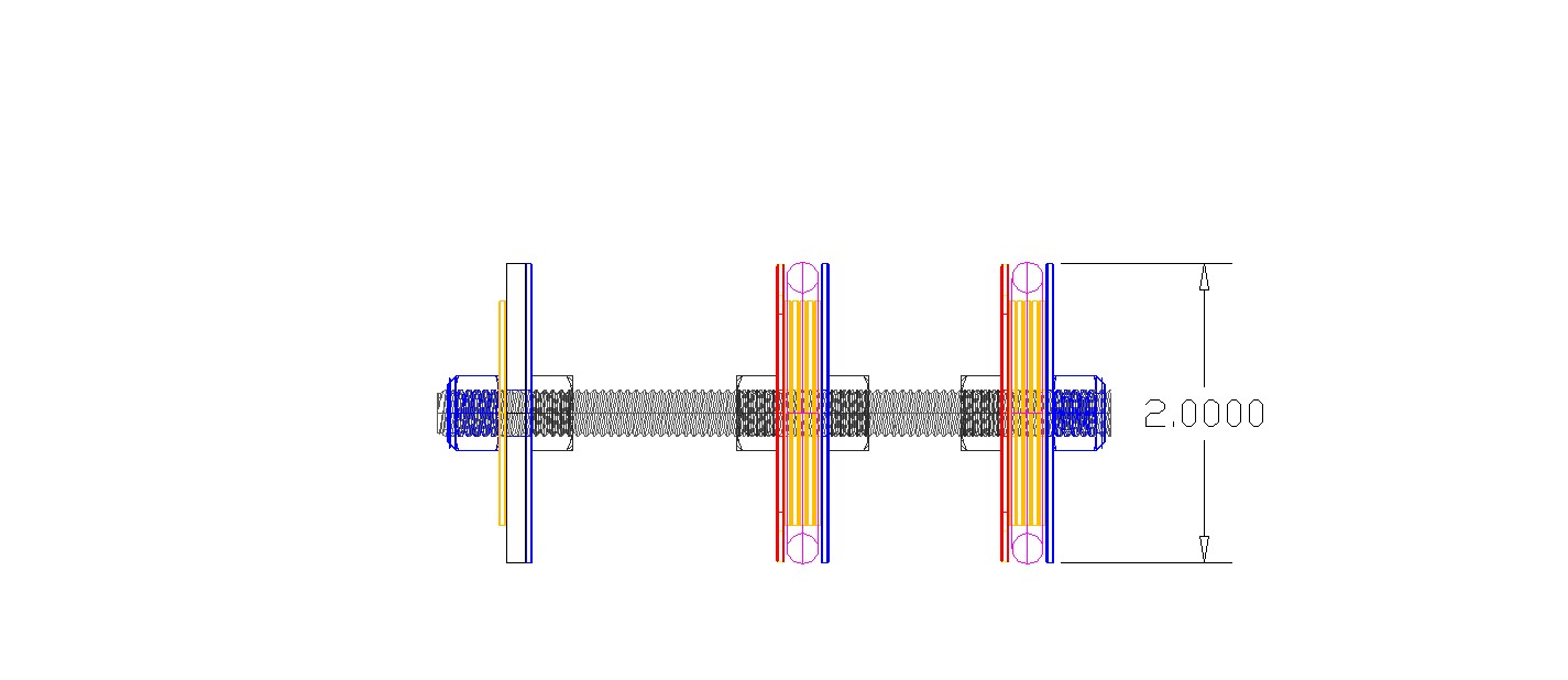

I can make a 2D/3D CAD drawing for you if you would like.Gun Freak wrote:Primitive piston plans![]()
If you want it, we can discuss some dimensions on PM. Let me know.
It can also be posted in the Sketchup Model library.
Here are some "unprimitive" plans of Gun Freak's nut and washer piston.
Any problems let me know Gun Freak.
