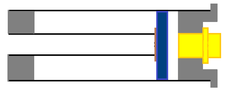

I've drawn up my final designs. Tell me if anything should be changed to make it work better.
Black = Main cartridge
Grey = End plugs
Gold = Schrader Valve
Blue = Piston
Brown = sealing face
To me it looks good. It probably might need a little work on the piston to make it move better but I'm happy with this. All end plugs and the schrader valve will be epoxied into place. The picture here is actually my design for my shotgun version. This cartridge is the same size as a 12 Gauge shell which is 7cm long and 2cm in diameter. The rifle cartridge will look the same as that but it will only be 4cm long, 2cm in diameter but it will have less pressure and the barrel will be 5mm. The shotgun will have a 1 or 1.5cm diameter barrel.
The shotgun cartridge will take 1000 psi and the rifle will take 800 psi.
Tell me what you think guys! :)
That looks like it would work well.
You could mod it slightly as attached in order for the schrader to not be so exposed.
Don't cut from the schrader threaded part, otherwise it won't seal against the pump attachment.

Thanks Jack, I might put the schrader like that but in real life that will be quite small and I don't think the pump's hose will fit in that gap.
On the piston I might make it thicker on the outside so the piston wont flip because it's so thin. Making it thicker on the outside and making the sealing face stay thin it will add stability the the piston might even glide more smoothly.

I was working on my accurate drawings of my plans for the shotshell cartridge. (I have decided to make a lever action shotgun first.) I have come across a problem. My shotshell dimensions is 61mm x 24mm. The end plug that houses the schrader valve is 20mm long. The end plug for the barrel is 10mm long. The barrel is 30mm long and 10mm diameter.
I have gone with the design where the schrader valve is hidden inside end plug (JSR's modification to my original cartridge.). Behind the piston there is a 5mm gap where pressure builds up. Infront of the piston is a 12mm gap.
The problem here is that there is barely any room at all for pressure to build. I don't want to decrease the barrel's diameter because my type of ammunition is buckshot. Which in this case is 12 bb's that are 3mm in diameter. I cannot decrease the length of the barrel because that would create more pressure behind the piston and less pressure in front of the piston which means that when I open the pilot valve, the piston will move backwards very slowly. Another problem is these are the dimensions of the cartridge WITHOUT the wall thickness drawn into the design.
So, would anyone be able to help me? I want to have 1000 psi in this cartridge. Do you think it will be able to propell 12 3mm Steel BBs at 300 fps? Lastly, what would be the recommended wall thickness if I want 1000 psi?
Thanks.
DerpWithAGun wrote:I was working on my accurate drawings of my plans for the shotshell cartridge.
Let's see them :)

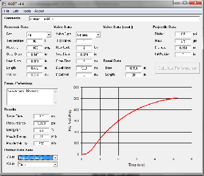

I put in all the info I knew onto GGDT and I got this:
Travel Time: 8.5 ms
Pressure Drop: 957.9 psi
Muzzle Energy: 0.3 ft*lb
Muzzle Velocity: 27 ft/s
I probably entered in some of the information wrong but I'm glad you can do it for me :)

DerpWithAGun
Posts: 144
Joined: Sat Jul 30, 2011 10:11 am
Okay, Here is the design! :D
EDIT: Laptop was about to die I couldn't write anything else.
The parts that are clear white that don't have any pattern or shade on them are the areas where pressure can build. I forgot some dimensions; The piston is 13mm long. The gap where the piston meets the barrel is 4.5mm. The end plug on the right of the picture is 10mm wide.

hmm, seems like you right about it having practically no chamber volume... Even for 1000 psi thats pretty small... :? Are you sure you cant make it just a bit longer? That 27 f/s actually sounds about right.

Well I don't know. That is about the right size of a 12 gauge shotgun shell and I wanted to base my designs on that.
Since I'm building a lever action shotgun with this, increasing the size would cause many problems. I guess the lever action will just have to wait. I'll start designing my cartridge for the rifle tomorrow. That will be a lot easier. to make.

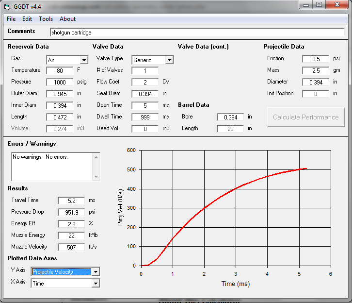

Assuming a 20 inch barrel, 10mm calibre and an extremely thin barrel wall inside the cartridge (:roll:) for 2.5 grams of BBs and sabot I got around 500 fps, pretty healthy.

aha! So my design did work after all? but You said 2.5 grams of BBs. Try it with 10 grams. 12 BBs that are 3mm in diameter is roughly 10 grams. I might just increase the length of my cartridges by 10mm - 20mm just for a bit more power. Thanks a lot JSR! And 500 fps! That's heaps! I think I read on the Farco Air Shotgun website that the Farco got 300 fps.
