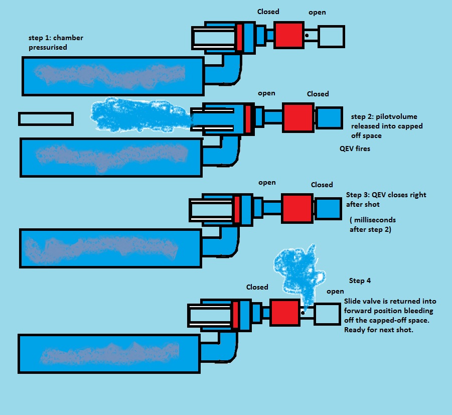

BTB, can you perhaps post a diagram of what you meant with the whole reversing the slide valve idea? If i'm understanding it right, are you saying you fill from the chamber? Just a little confused, and I'd like to figure it out as I may use it on my current gun, flipping the slide valve would make my trigger setup alot easier. thanks

I think hotwired originally came up with the idea and made a diagram, but I just cannot find it. I've tried it before with a QEV, but I didn't have a constant air source, so I just got progressively weaker shots

The idea Hotwired posted about was this one:
http://www.spudfiles.com/forums/copperh ... t9916.html
And that was operational on a cannon made 9 months earlier.
You're almost certainly thinking of something else since it was before you joined.
Sorry Hotwired I had completely missed your links.
It deserved more attention.
In a QEV gun it should look something like this.
(The valve does step 3 by itself, no action required..)

Ohhh I got it now. The red block right before the slide valve is where the air is inputted right? Makes sense, and seems very efficient. This could work pretty well with my piston valve gun in progress.

I think the red block is supposed to be the slide valve...
