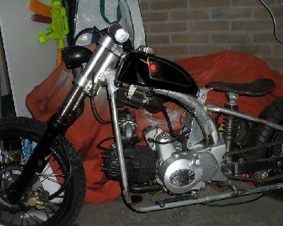

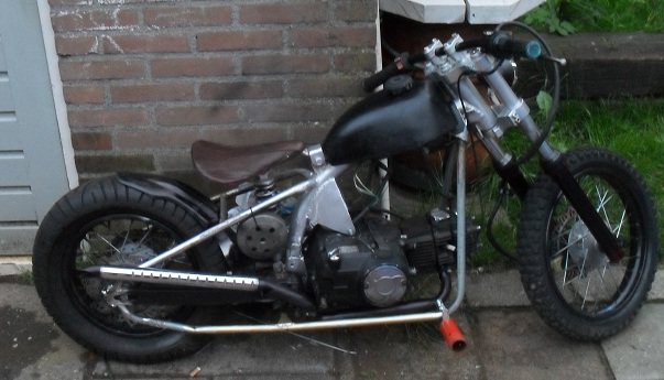

Update:

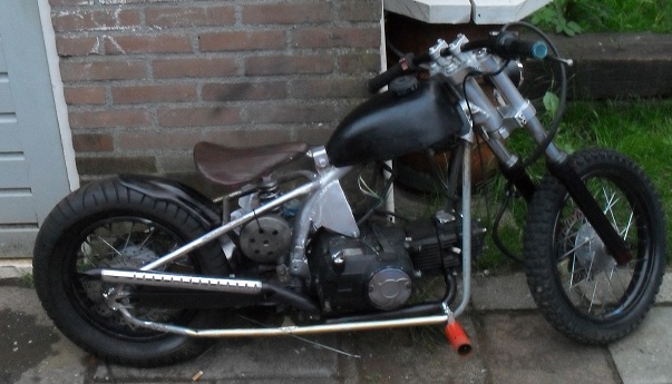

Hmm..I made a custom exhaust..
I wanted it to go underneath the block and pop up behind it so my kid wouldn't burn himself.
And I made a slashcut turnout tip and cut up a pipe I got for the chrome showpiece.
I swapped the rear tire for a fat one ( over 5"wide) and noticed the wheel is far from straight..Now I got even more work to do.
let;s hope I can adjust those old rusty spokes.
I also boxed up the enginemounts..Solid as a rock now.
With a lot of effort I managed to fill up the voids between the inner and outer tank with some old polyurethane caulk stuff..
It was a female dog squeezing it out of the tube..but it still sticks like hell.

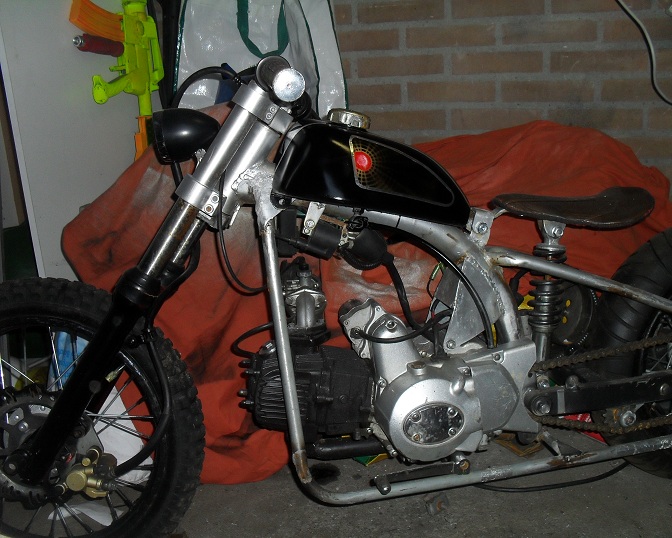

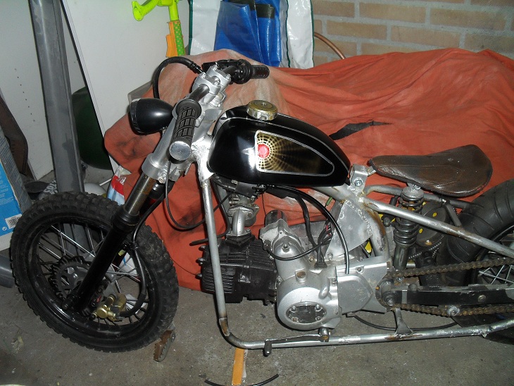

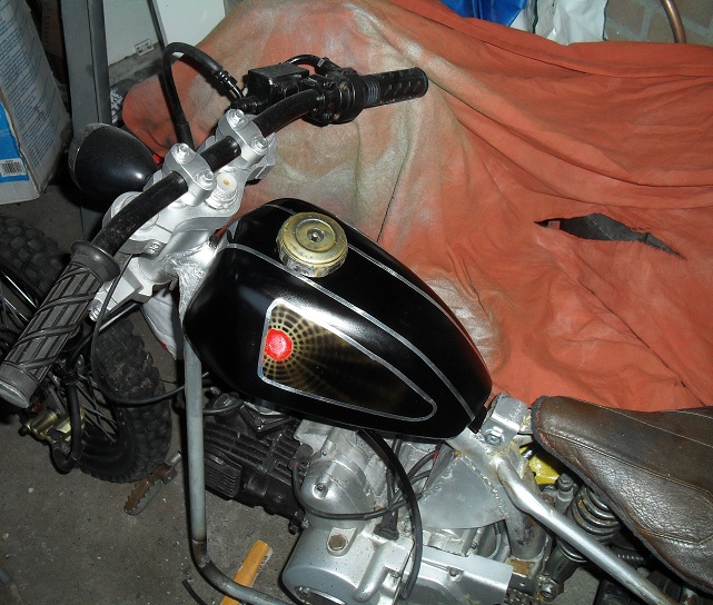

I rebuilt an engine, carb is on, redid the wiring completely.. etc... hopefully ready to run soon.
But that is not interesting perhaps so...let's look at the tank.
I melted a bottom on so you can no longer see it is just a cover over the actual tank.
I tried to replicate the eye of a terminator for the paintjob.
It still needs clearcoat.
Hopefully, if the engine lives I can start finishing up the framework, controls etc.
Hope someone enjoys my buildlog...
Anybody?
Anybody?
