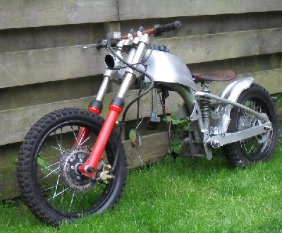

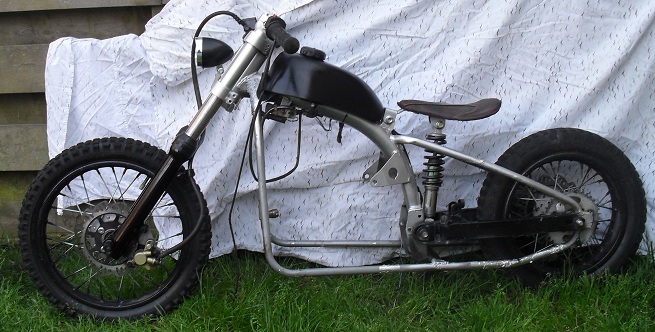

I decided it was best to start my own "mini chopper"topic as I will be updating with pictures quite regularly.
For those of you who missed it, I used a pitbike as a base and took out the shock.
Then I welded the hardtail after removing several unwanted frameparts.

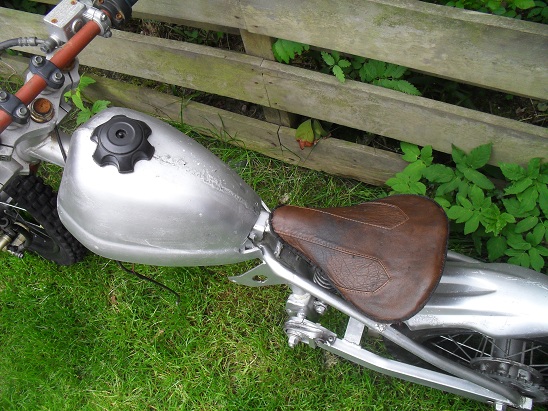

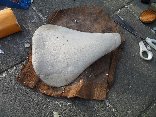

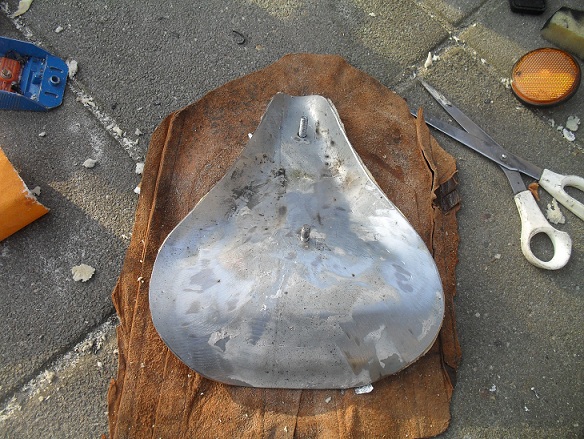

I formed a seatpan from flat sheetmetal and over the weekend I glued and sanded a piece of foam.
Then I made the leather cover and started with the needle and thread.
Looks like it was custom made by a bikeshop if you ask me. 8)
I also cut the ( plastic!) sides off a scootercase and "welded" the two parts together using a flathead screwdriver and a stove.
I amazed myself...never thought it would work that well!
It is now a single piece and is used as a tankcover.
I could make a complete tank this way, but I'm not sure it is gasoline resistent.
I'm hoping I can "weld" an inner tank from the original pitbike tank in a similar way.
If that prooves impossible I'm stuck using one from a minibike.
enjoy the pics so far!
:D

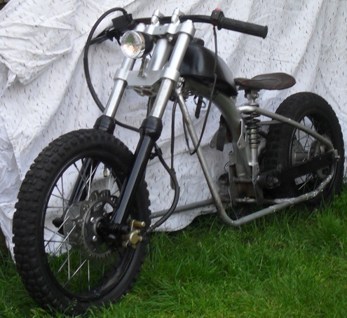

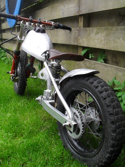

Nice stance..
Nice stance..
Tight as a drum!<br />And it feels very comfortable.
Tight as a drum!

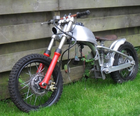

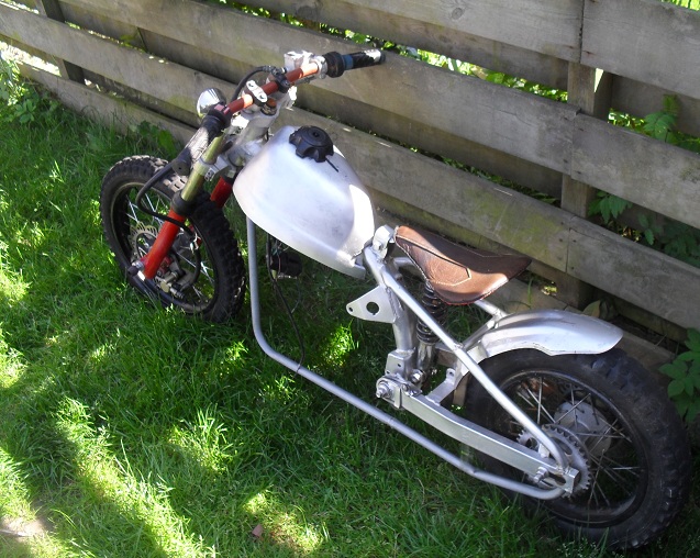

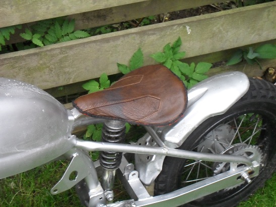

Seat bracket.<br />It swings on the custom hinge welded to the frame and is supported by the re-assigned mono shock.
Seat bracket.
No picture of the finished foam after sanding but take it from me, it is perfect!
Flat steel becomes superb bobber seat!!

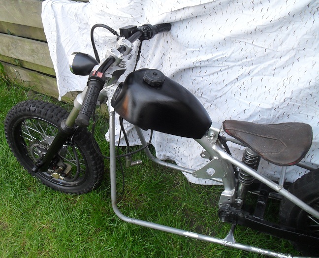

Small update as Fibromyalgia is popping up pretty bad due to the sudden heat...
( not a pleed for sympathy BTW, I am slowly recovering...I used to have some good days, now I just have some bad..)

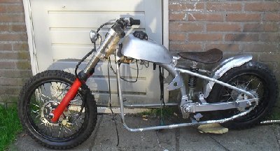

After I took the pics I saw I had misplaced the tank, causing it to hang off a bit..Looks a bit weird...I did manage to solder the inner tank together wich is now watertight.

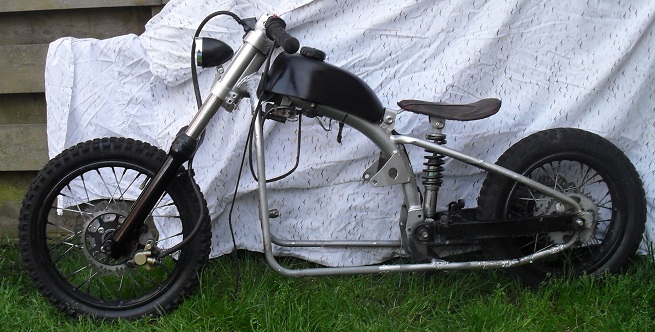

Haven't done that much to the bike but I wanted to share the planned frame addition.Temporarily suspended with Scotchtape offcourse.. :roll:
...just to see where I'm going...
Looks about right.
Some tweaks and I'll weld her up.
Crossbraces and stuff will be added afterwards..

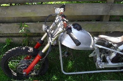

I bent the dragbar in a slightly more ergonomic way and took it from being just a piece of 1/2" gaspipe to being actual handlebars.. :D
A nice sidenote is that this pipe has served as a spudgun chamber before..
It has held around 60 bar...so yeah...I'd count that as a spudgun part.. :wink:

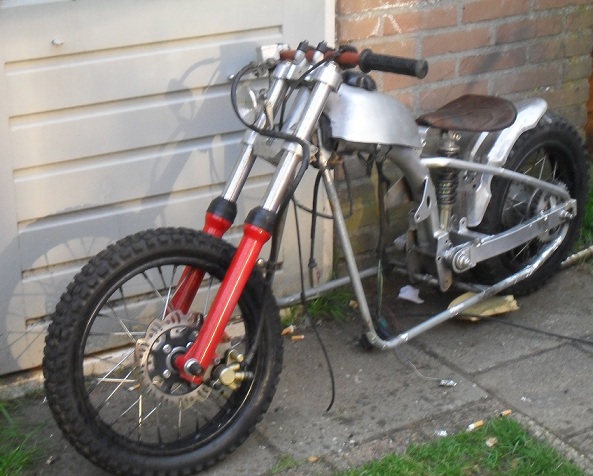

Last but not least..I got a headlight for it..
Netherlands
Posts: 3497

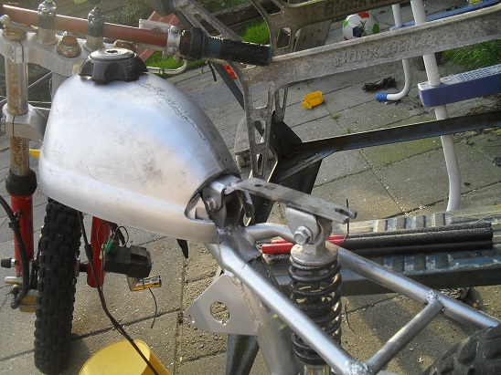

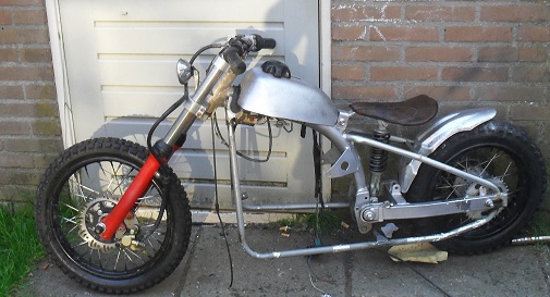

All secured in place...
Tank trimmed and front mounts welded on...

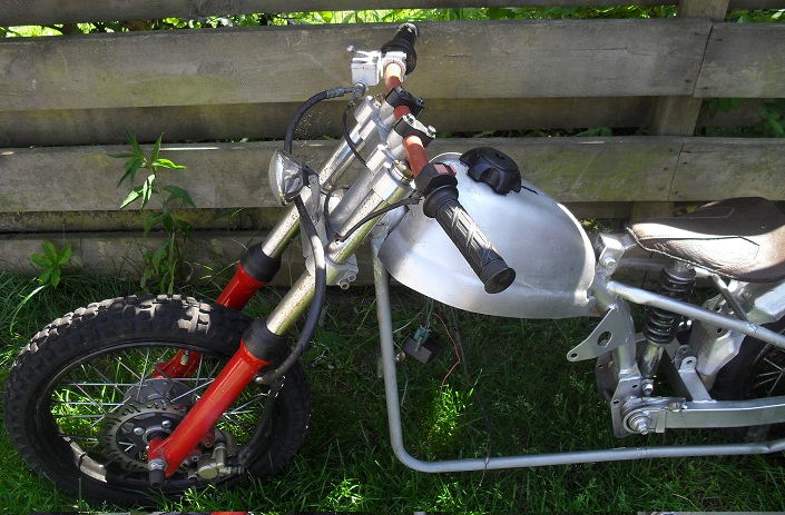

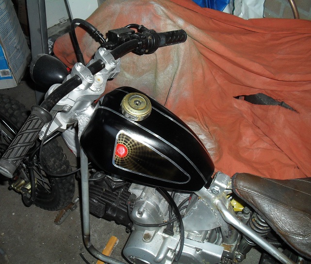

Anyway,...I welded ( I seem to like saying that..) the innertank to the outer tank and cleaned it up.
Stuck on the last bit of plastic sheeting in the back to finish it off.
I trimmed down the gascap ( making it shallower) so it would still seal with all that extra material inbetween and I started planing it into shape ( simple and round).Still need to complete it.
Already looks better than the original wich screamed "pitbike!"
Once finished I'll spray it gold....Maybe gold and worn black over it...
If I can find some I'd like 3 chrome spikes to top it off..
I cleaned up the front end in a hurry. Quick sprayover to see how it would look...and put on a battery powered led headlight I found amazingly cheap BTW.
Still a heap of work to do but I can see it all coming together..it will be so cool once I start her up later on!!

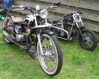

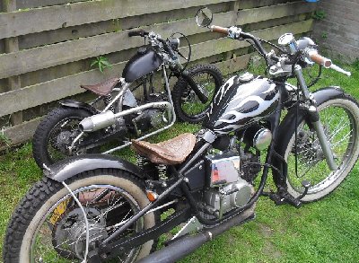

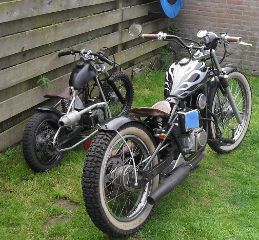

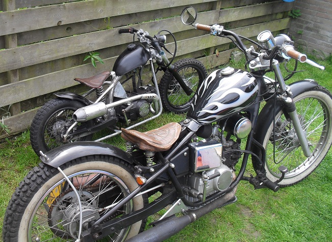

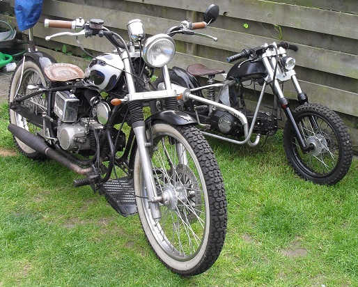

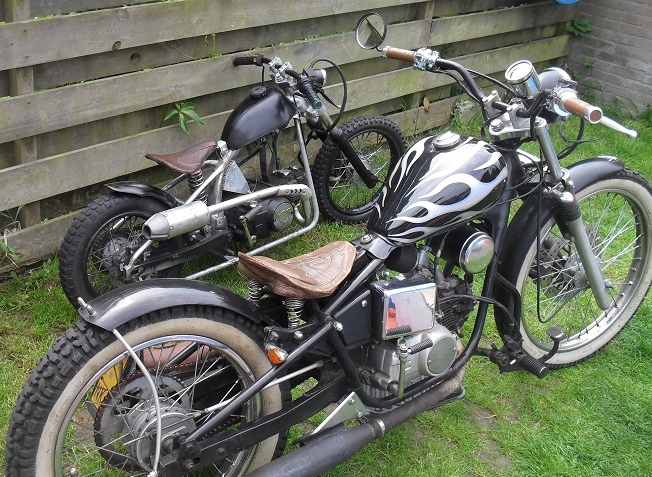

Made the engine mount..time for a comparison...
I do believe his bike will look better than mine...
Oh boy..
