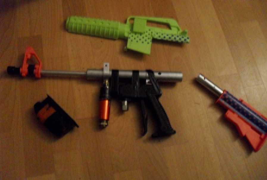

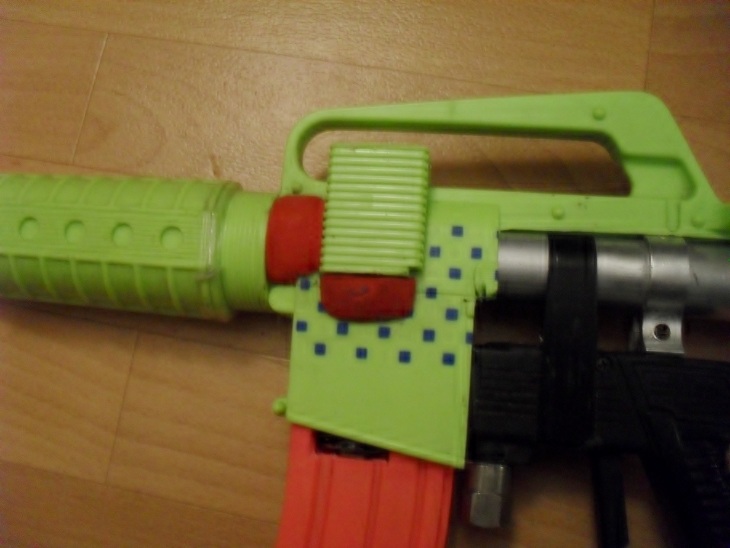

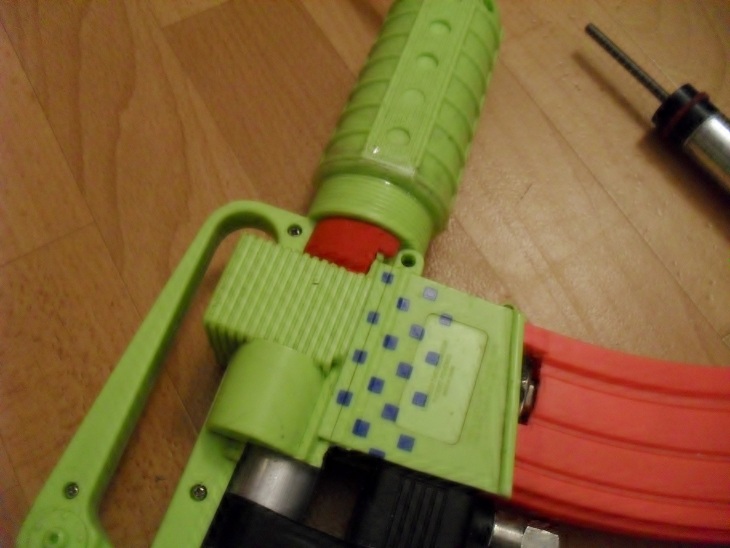

Both sides of the body now chopped up and made to fit.
Some parts will be filed down to get rid of the rough edges on the cuts I made.
I cut out a section of the front grip/heatshield.
As this is slightly conical I had to choose my cuts carefully and use one of the ridges, where the diameter is bigger to get it to still fit together.
This is temporarily held together by black tape over the cut.
I had to do some cutouts wich could have gone better. :roll:
The body stays on firmly when both sides are screwed together.
I got the stuff to make the plunger and seal.
The rest is up to bondo...unless someone knows a reliable method to melt the original scrap plasic down to use that as a filler.
The magazine has been cut up to fit around the internals.
I still need to finish the cutouts as they are very rough.
The mag is still removable fo acces to the internals but it stays on well.
I had to remove the red cover I had made for the pop-off.
It made it to big to fit.
I'll fill the space inside of the mag with foam.

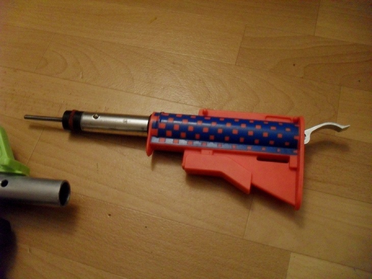

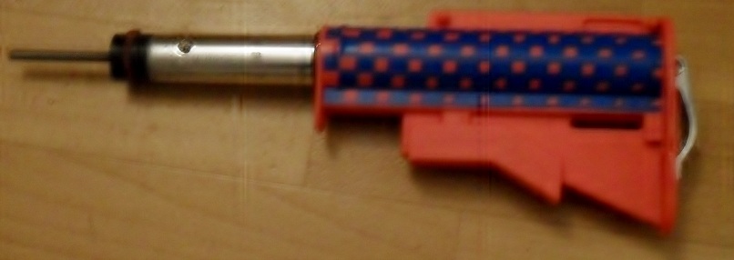

I used the same compact foam to make a squishy seal on the shoulderstock/backplug..
A cam in the back squeezes it together and as a result it forms an airtight seal on the bb-reservoir walls.
This method will help prevent unnessecary wear on the seal during refills and makes it easier to slide the stock off.
Fast click-clack refills yay!!
The threaded rod sticking out will be cut down and only a little bit of it will remain to hold the plunger-spring..

How does the cam lock works? (if it´s DIYble I may make one from my sentry gun system)
Netherlands
Posts: 3497
The camlock came with a collapsable pogostick.
It collapses when you push a button on the side.
I used that as a lock on the shoulderstock.
The camlock now pulls on a threaded rod, wich runs freely through a plastic fat washer and is then threaded into another one of those fat plastic washers.
Pull the camlock and the seal gets squashed between the plastic blocks and expands onto the reservoir walls.
The seal is formed ahead of the hole into wich the pushbutton locks.
So both mechanisms came from that pogostick..
I just adapted what I had...

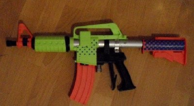

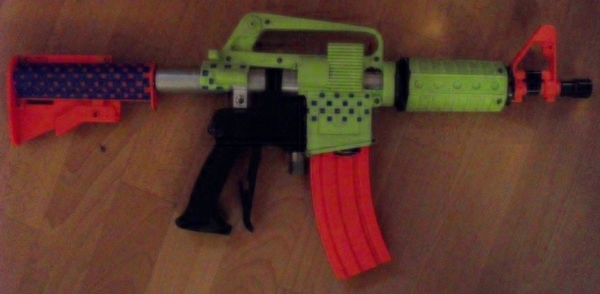

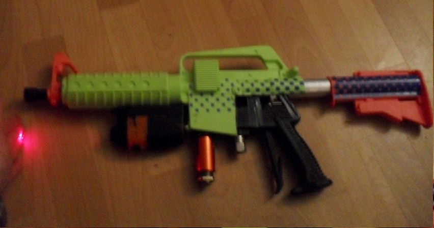

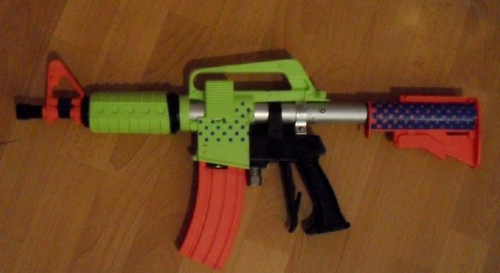

The gun is now basically finished.
The front grip has to be filled up to make it a solid piece and I need to paint it over again.
Found out by accident that spraypainting yellow over pink gave me a nice orange.
My son prefers it over pink..

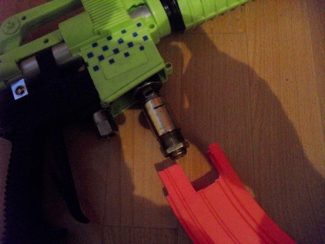

I ran into a problem.
A stupid problem to have, but a problem nevertheless...
The stupid pressurewasher handle had a steel bb-on-brass valve..wich might have worked with water, but with gas it leaks slightly.
Nothing to seal it but metal on metal..
So I made a rubber seal to fit inbetween the valveopening and the steel ballbearing used to close it.
Now it seals perfectly..
