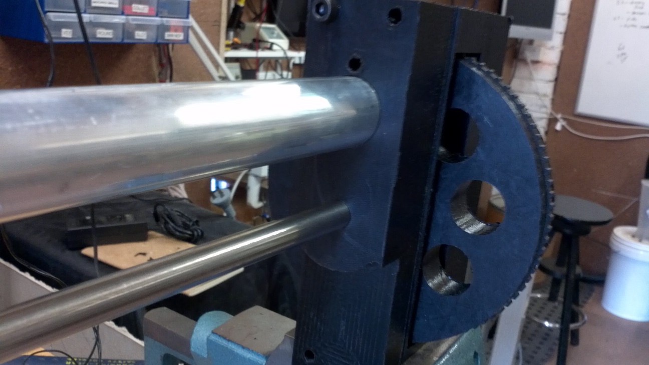

Not a gun yet, just some bits on the bench.
For my next trick I need to design and construct an alignment circuit, something to tell me that the drum is in the correct starting position for the stepper to index from. I am thinking of an IR photodiode hooked up as a voltage divider with a LED illuminating the diode via a hole in the drum.
This might give you an idea of where I am headed.

Grabbed a BP104 IR photodiode and an IR LED, changed some code and hey presto, it works.
Press Button 2 and the rotary magazine spins slowly and at the same time polls for voltage on Analogue Pin 1. The theory is a small hole in the magazine plate that aligns with two others, one on each side of the breech. When the holes are lined up the voltage at the pin goes high due to the IR LED shining on the photodiode and the rotation stops.
Now you can press Button 1 and the first relay fires, this activates the solenoid valve that pilots the QEV and launches the round. The next relay fires to open and close the solenoid that feeds from the bulk HPA source to the chamber. Finally the drum then rotates by a preset number of steps to align the next round.
TO DO:
Change the code on BUTTON TWO so that instead of looking for a threshold value it runs until the voltage has declined for two or more readings, that should mean the LED is being obscured by the drum moving past the best alignment point.
Finish the mechanical stuff so I can get the electronics bolted on.
