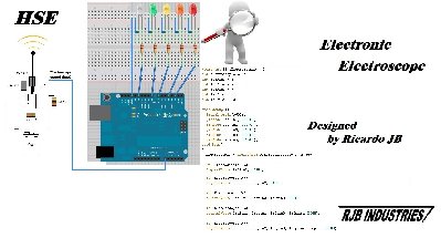

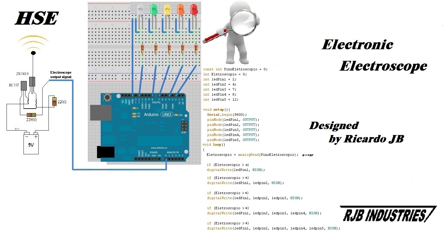

Hello everyone,
I have an electronic schematic and I need help on the code, (arduino code), I load the image and if you know arduino code please help me.
The project is an Electronic Electroscope and I connect it with the arduino, please take a look.

You aren't very specific you know. You didn't write where you got the code or whether you know what it is supposed to do
Ohh and if I were you I'd send the results through serial port to the computer. Here is an example sketch included in the arduino IDE. You can test the circuit with it - it should return a value ranging from 0 to 1023. Experiment with different charges and distances and note the values you get.
AnalogReadSerial

It looks like a high gain darlington setup using a touch plate/probe on the first transistor's base. But the code looks a little silly. If a is an integer 0 to 255 representing the voltage read from the darlington, all the led's will light up when the voltage is greater than a... you need to set a different value (or increment a by a fraction of 256) for each of the IF statements shown, otherwise all the LED's will light up regardless of reading.
For instance:
PS can tell you I'm no Arduino expert, but that's what I think.
EDIT: You could also use a single LED and dim it according to the voltage on the electroscope pin. Use analogWrite to the led with an integer of ~36 to 255 and "map" that to the Electroscopes read of 0 to 255. The number 36 will vary with the LED's breakdown voltage.

The thing is that he is supposed to manually enter integer values in place of all the 'a' in the in statements.PS can tell you I'm no Arduino expert, but that's what I think.
He can do that but he doesn't know yet what values he can get. The ADC on arduino is 10bit (not 8bit) so at least theoretically it can be 0-1023, but you can't assume that his highest readings will be 1023.
If he uses the example code I posted earlier he can see how the circuit responds to charges and what values he receives under what circumstances and then manually enter values that make the sensor most useful.
ohh and note that the code you posted isn't complete as you only set the LED pins HIGH but there is nothing to set them LOW

Cool. As I said I'm no expert with Arduino, only have basic knowledge of things like C, RISC assembly, etc. I'm sure it's simpler than both once you learn the language.
Good point on the calibration too. I guess I was assuming he could adjust the darlington portion of the circuit to provide a useful output range for the arduino (0-5v).

Hello again, thanks to all of you, I really appreciate yours advices and your help, this project will allow me "measure" the electrostatic charge on bodies.
If someone could, if is really sure about it, write here all the code, since the begin, to do this, I would really appreciate and recognise the help.
The values are these:.

- Technician1002
- Posts: 5189
Your input circuit still needs work.
1 It needs circuit protection from ESD.
2 It needs high impedance besides high darlington gain.
3 It needs DC offset bias to measure both + and - charges.
4 It needs RFI protection
1 You need current limitation on the input to prevent a static charge from destroying your input. A high value 1-10 Megohm HV resistor is recommended. Add steering diodes so any ESD into the input is safely shunted to ground or the +VSS supply rail.
2 Replace the first transistor of your darlington pair with a small signal IGFET. No sense having the circuit discharge your test subject and give a false zero. You will want an input impedance of 100 Megohm or higher.
3 Bias the source of your IGFET darlington pair so the output is 50% on your A/D converter so + and - charges can be measured.
4 Add a filter loop in a negative feedback in your amplifier with a time constant of about 0.1 seconds for a roll off frequency of about 10 HZ. This is to keep the local AM radio station out of your amplifier.
A saturated high gain amp will cause wierd readings as people walk past windows, open doors, etc that is not related to the ES field. These gremlins are hard to recognise without the proper test equipment.
With the high gain, you may also need a servo feedback loop on the bias as it may work very well as a thermometer without one.
For more info on the analog portion if you need to do this, pick up a copy of the "Op Amp Cookbook" http://www.analog.com/library/analogdia ... dbook.html
This chapter deals with driving Analog To Digital Converters.
http://www.analog.com/library/analogdia ... _final.pdf

There is a very simple electrometer circuit that might be better than the Darlington pair. It won't properly handle both possible field potentials (though swapping the antenna with the ground, ground is basically the 9V battery shell, will get the two polarities.) To get both polarities a pair of FETs, one on each side of the 9V battery, each with a small value resistor and each connected to its own Arduino analog input pin, might get both polarities.
http://amasci.com/emotor/chargdet.html
The (optional) 1Meg resistor is Tech's protection to keep a static discharge from frying the FET (or the Arduino).
Be a VERY good idea to protect the Arduino by running a diode from the signal line to the Arduino + supply and another diode to the Arduino ground. Both diodes are reverse biased (from the input line to the + supply and from ground to the input line).
Put a small value resistor (perhaps 100 Ohm) in series with the LED and use a voltmeter to measure the voltage drop in the presence of various electrostatic fields. That should give the info you need to properly calibrate the Arduino code.
The brain-dead circuit is based on the maximum current of the MPF102 jFET of 20mA (hence a current limiting resistor isn't needed even though it uses a 9V battery to power a LED).
The simple jFET circuit is phenomenally sensitive and might be too sensitive for your needs.
You might want to use a Log scale on the outputs from the Arduino.

ohh speaking of 9V batteries... why aren't the grounds common ?
- mobile chernobyl
- Corporal 3
- Posts: 759
- Been thanked: 8 times
He's using the Tesla version of ground.
