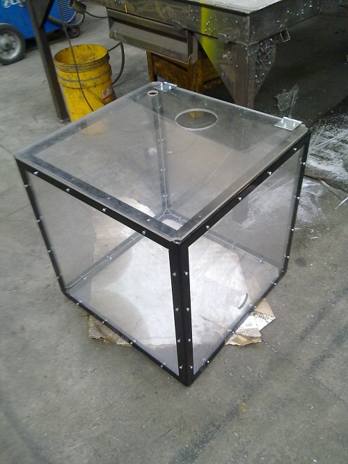

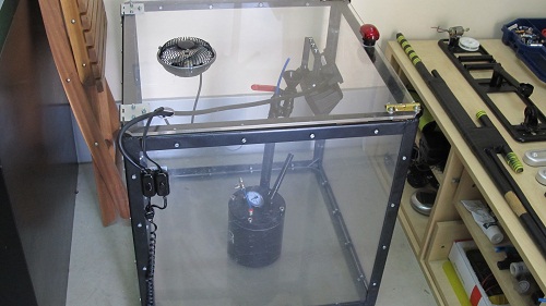

Main Features and Specifications :
-Fan for gases extraction;
-Internal spotlight;
-Safety light flashing LED;
-230V input;
-Main material: explosion-proof acrylic with 10mm thick and angles in steel;
-112 stainless steel screws;
-220 washers;
-110 stainless steel nuts;
-Universal lateral bore for hybrids/combustions guns barrels output;
-Colour: Glossy Black
-Brand: RJB INDUSTRIES
RJB INDUSTRIES

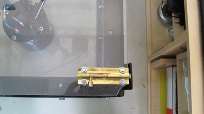

Simetric Lock
Simetric Lock
RJB P3.JPG (34.5 KiB) Viewed 11589 times

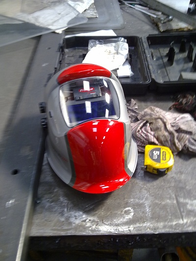

Welding Mask
Welding Mask

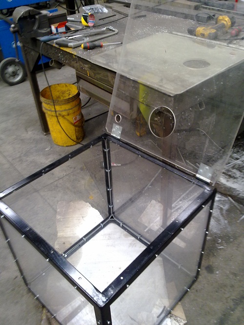

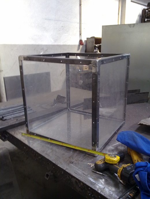

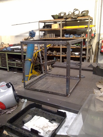

Steel structure RJB
Steel structure RJB

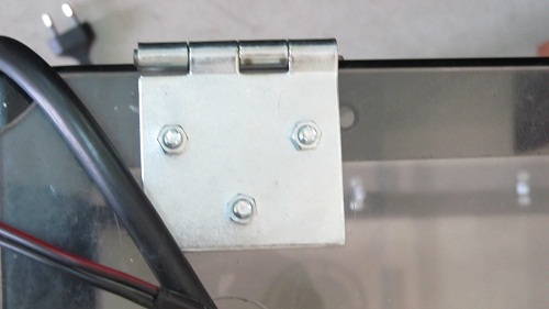

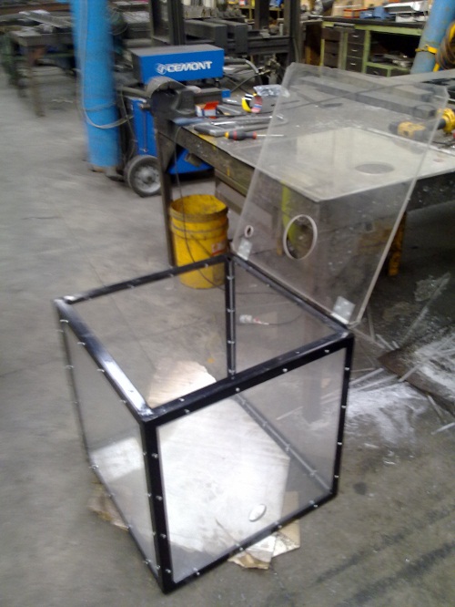

Hinge
Hinge

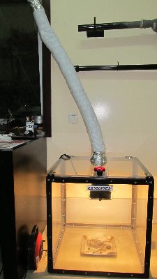

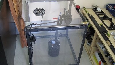

The Final Project by RJB INDUSTRIES

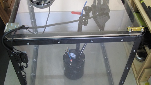

The switches view
The switches view

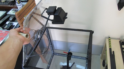

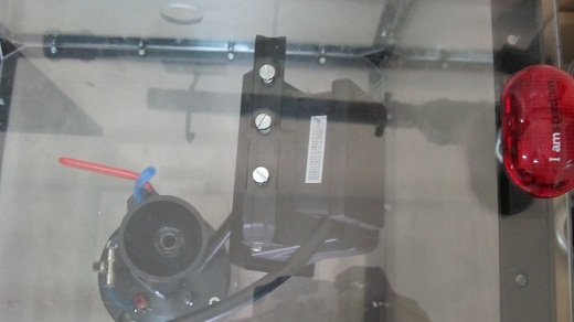

Fan - RJB
Fan - RJB

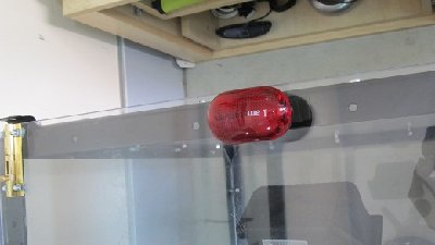

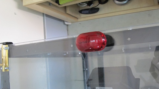

Red LED´s
Red LED´s

sorry for askin, what can you do with this shiny box? :p test somthing but what?
RJB INDUSTRIES
Posts: 144
Joined: Fri Sep 09, 2011 5:49 pm

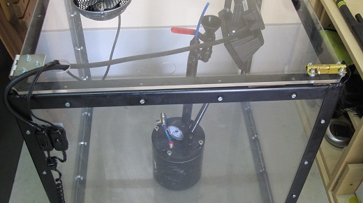

You test what you want, for example the first shoot with a gun, with don t have to remove your self from the fire place, you put the gun and the pressure gauges inside and if it goes wrong you have a protection.
Is a universal safe box, you do what you want inside it.
In some pictures you can see that I put there one of my previews inventions, the H2R( http://www.spudfiles.com/forums/h2-quim ... ter,0.html ) in case of hydrogen explosion i have no problem.
I hope I have clarified all the doubts.

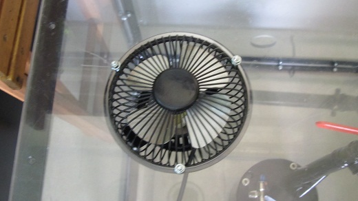

mobile chernobyl
Posts: 760

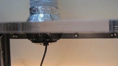

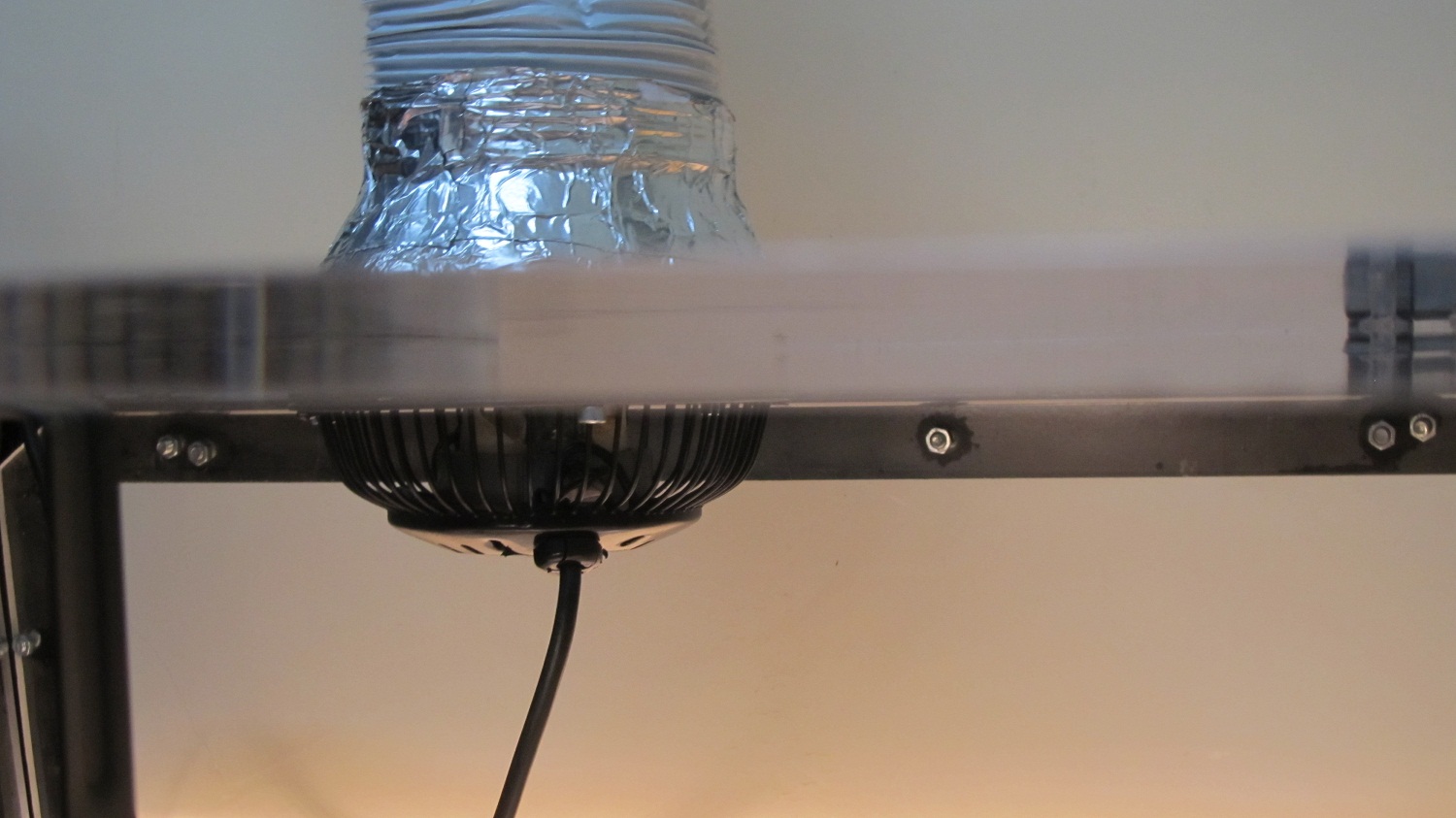

It looks nice, and it's great that you considered the wall materials for the strength, just a few questions:
What kind of fan is that? is it an open "squirrel cage" style AC fan as it appears to be or is it an explosion proof sealed fan? if not that will be a very likely reason for your explosion in the first place!
Did you design the lid to act as a "frangible roof"? If not you should reconsider! That is a very high priority in an container that can undergo rapid pressurization such as a gas combustion!
Also - merely screwing the polycarbonate onto the outsides such as you have done will create huge stress risers (effectively making them frangible panels!) and you won't reap many of the benefits of the material you are using! Instead you should run a strip of material such as aluminum flat stock/bar stock which is the same width as the framing underneath it to spread out the load. On that strip - drill holes the same spacing you currently have and put the screws through the backing material, then the polycarbonate then into the frame. Just a suggestion - you can make your device however you like!
RJB INDUSTRIES
Posts: 144
Thank you,
I had to considered that...
The fan is an explosion proof sealed fan AC, now i turn it into an exhaust system, sealed with aluminium 'tape'...(As you see in the picture)
The roof was designed to suport the pressure that an explosion can create.
The point number 4 is a good sugestion, however I tested it and there is no overload onto the outsides,
But I will consider that in the next project, thank you....

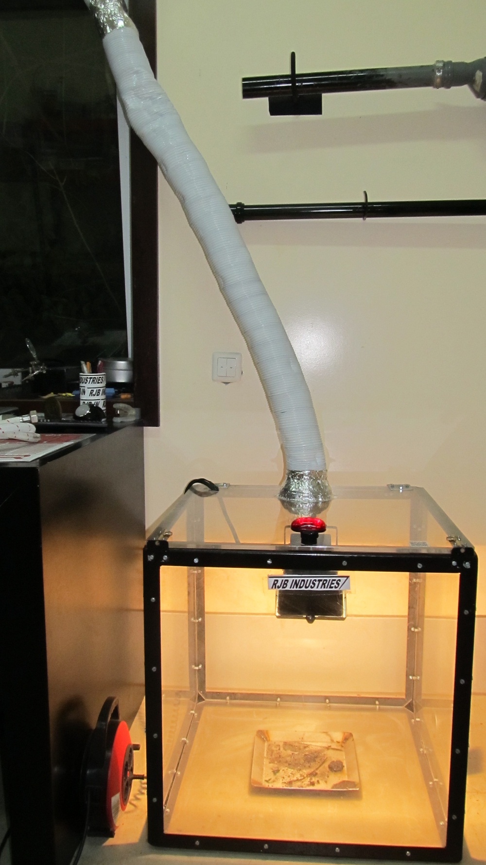

These pictures show the exhaust system, What do you think?
RJB INDUSTRIES
Exhaust system - RJB
Under view of the fan

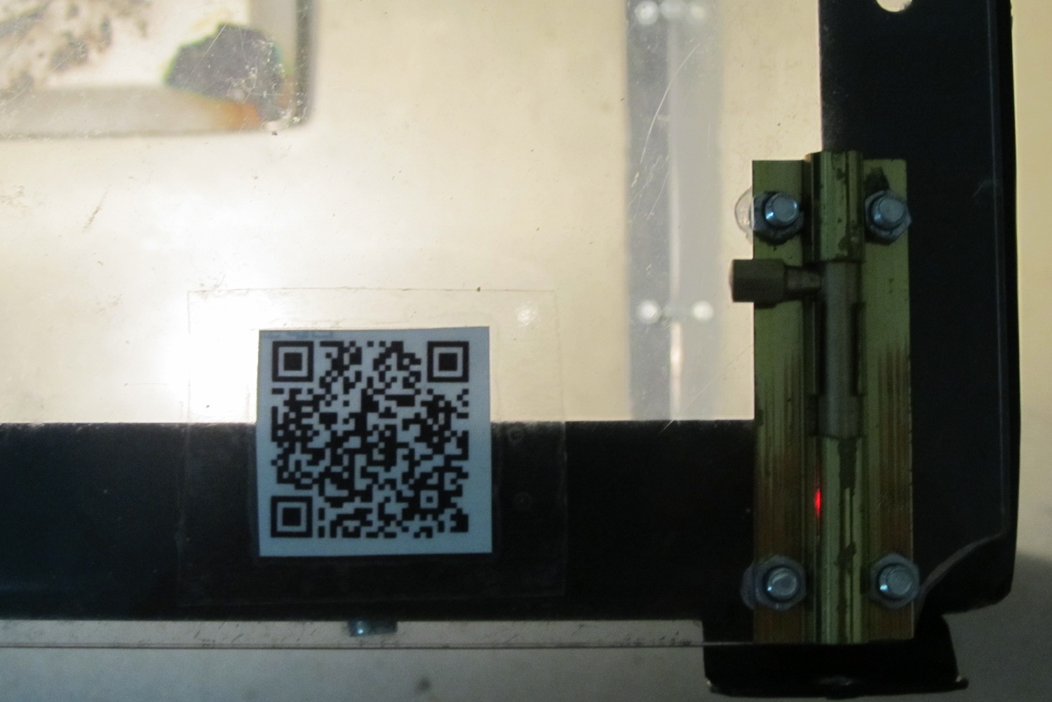

Roof Security (There is one of this per each side) and also the QR CODE
