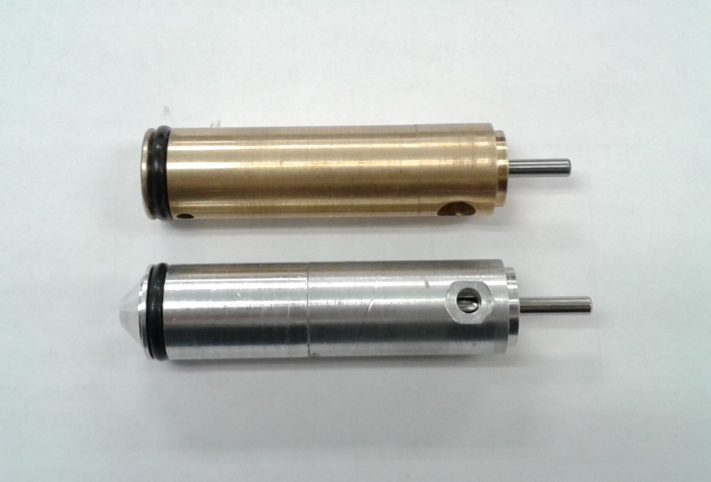

Here's the new valve in brass compared to the old one in aluminium. Note the flat top on the new valve, I will be making a pump head to match soon.

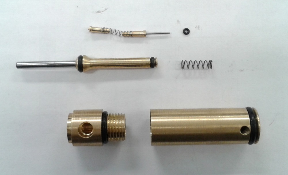

This is what it looks like taken apart, note the balanced valve and separate eccentric check valve.
The valve is not exactly balanced in order to maintain a residual force keeping it shut. Even so, I was able to expand the porting to 7mm diameter over the original 5.5mm, while still having 20% less force keeping the valve closed.
The porting to the barrel is now 5mm diameter, though due to my pledge not to alter any original parts the barrel restriction of 3.4mm will remain.

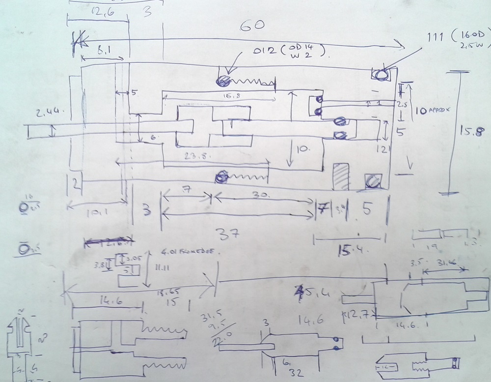

This was made somewhat on-the-fly, here's the paper I was working off - dimensions are not necessarily correct but it gives you a rough idea of how it works:

Then not much will change, flow is limited by the lowest point.The porting to the barrel is now 5mm diameter, though due to my pledge not to alter any original parts the barrel restriction of 3.4mm will remain.
I see you used a o-ring for seal, I made the exact same way for my airsoft gun. Even though the o-ring sits in a groove it sill get blow off some times and I was using much less pressure so bear that in mind...
Looks like (didn't calculate anything nor read the dimensions), the new valve set seems to have less chamber volume than the original?

I think I'm going to re-do it with some more thought. I can't have more than 5mm diameter counterbalance because of the need for the separate check valve, so perhaps I should go for a smaller port - say 5.5mm - to keep the difference minimal. This would mean that there would be much less stress countering the hammer, so the stem can be thinner.

Well, yes and no - imagine the difference between filling a bucket from a water bottle, and filling it from a hose. Same diameter, different flow speed.Then not much will change, flow is limited by the lowest point.
It seems to have held so far. Pretty much the same as used in airsoft valves.I see you used a o-ring for seal, I made the exact same way for my airsoft gun. Even though the o-ring sits in a groove it sill get blow off some times and I was using much less pressure so bear that in mind...
Should be a bit more actually.the new valve set seems to have less chamber volume than the original?

You need a way to bleed the counter-side in case some pressure leaks past the O-ring.
This can easily happen when you fill it from zero.

There is a bleed hole, unlike the diagram the threaded port goes straight through the counter chamber. Unfortunately I was unable to access the holes to clean them up properly so it tears the o-ring going past it afer a few shots, meaning I had to limit travel. This is why I want to re-do it.

Well, made a new valve stem, ironed out some bugs that were causing inconsistencies and failures and now it seems to be working great. So far, noise has been my only perception of power and up to the 20 pumps I've tried it just keeps getting louder! Clearly the sweet spot hasn't been reached
Did a quick non-scientific power test by putting an airsoft BB in the transfer port (6.5mm bore) and clucking bell! It went through a cardboard box!
My cellphone microphone really doesn't do justice to the noise, it sounds like a 22 rimfire at 20 pumps!

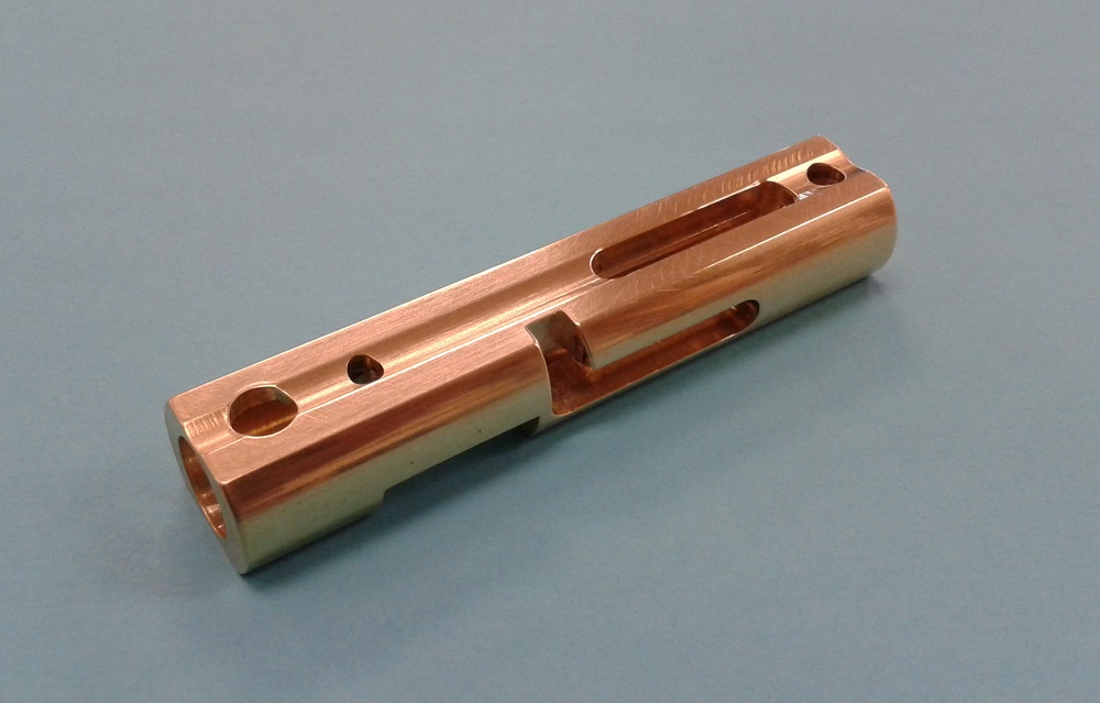

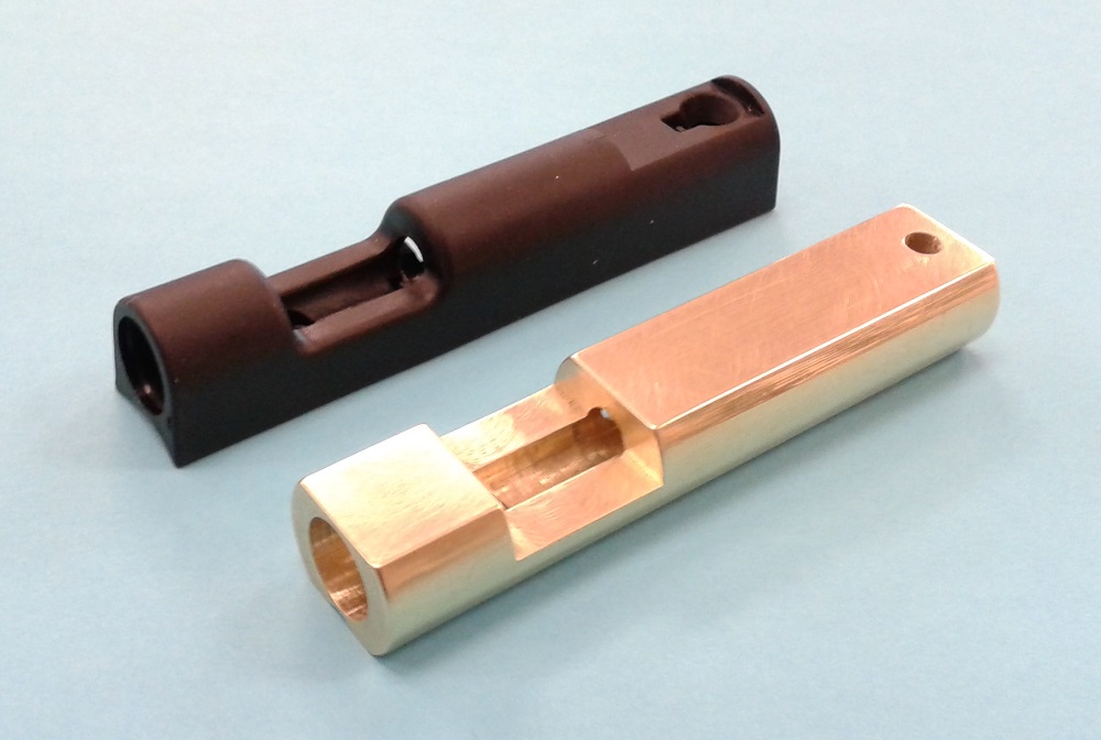

Comedy aside, here's the brass breech block I just finished, next to the naff stock plastic one:
Here's the underside:
It started off life as a 3/4" round bar, I loosely based the dimensions on the plastic one but made no attempt to replicate it. Nice and shiny but I don't think I'll polish it much more, I want to black it eventually anyway.
FragmentedSanity
- Private 2
- Posts: 30
- Joined: Sat Dec 27, 2008 9:17 am
Nice looking breech Jack. I prefer em in black too, but polished brass can look great on the right gun.
I didn't see any rails milled in, is it just set up for for the stock sights?

I'm guessing you went with the flat top for accessories?
