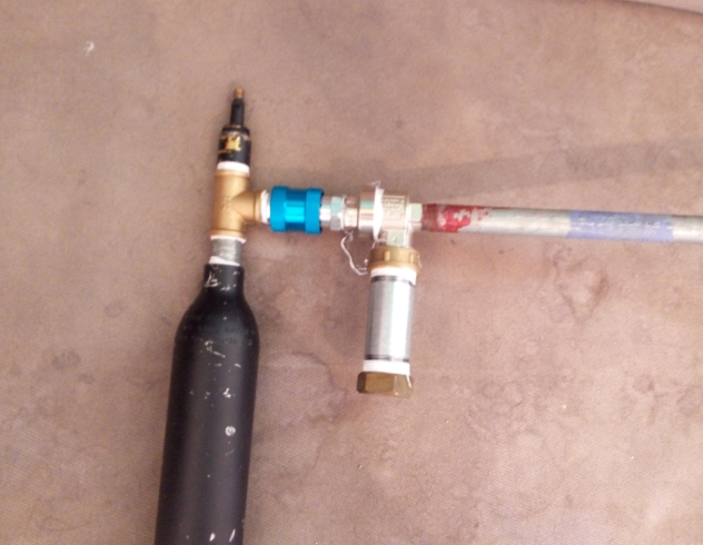

i'm trying to build something similar to yours..
I'm pumping 160 PSI from the air tank side and for some reason the air comes out of the silde valve holes and not from the barrel.
i've tried to put a spring in the QEV.. got the same results.
any suggestions?

Has thanked: 581 times
That's odd, from the image you appear to have mounted everything correctly. Is it possible that the QEV diaphragm is damaged? If air can flow out of the pilot without opening access to the barrel then you must have a diaphragm leak.

Posts: 40
Joined: Thu Mar 09, 2017 4:36 am
tnx jackssmirkingrevenge, you were right.. the diaphragm was damaged. i replaced it and everything is working! thanks!
