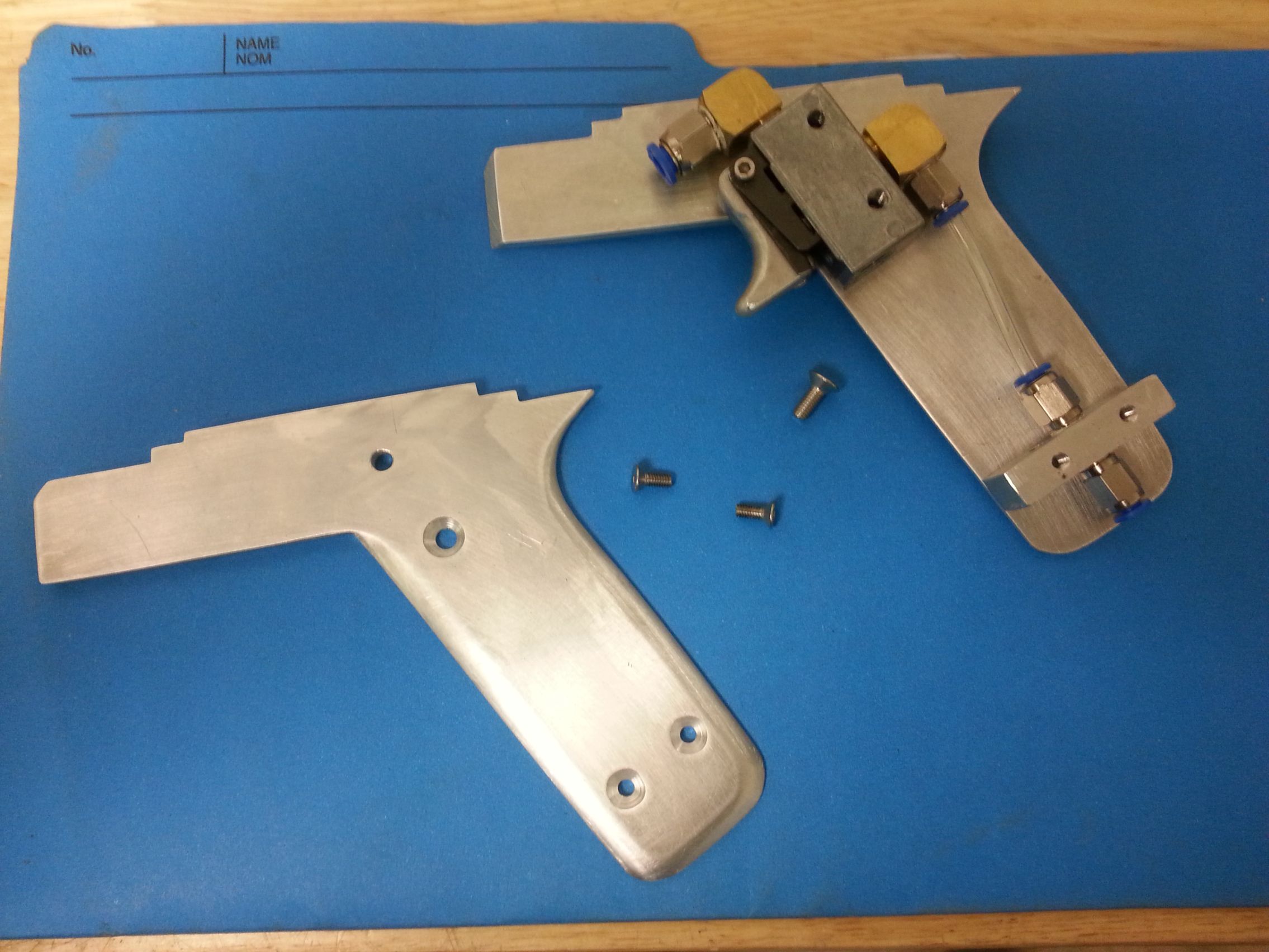

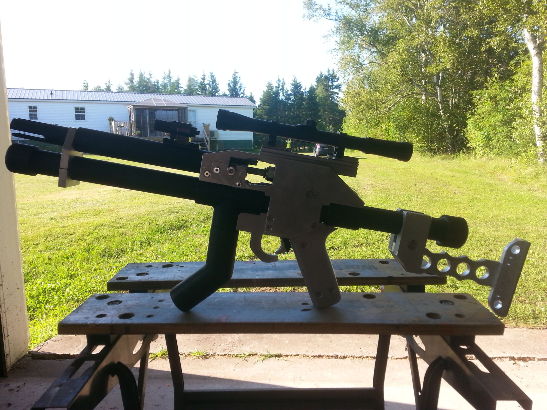

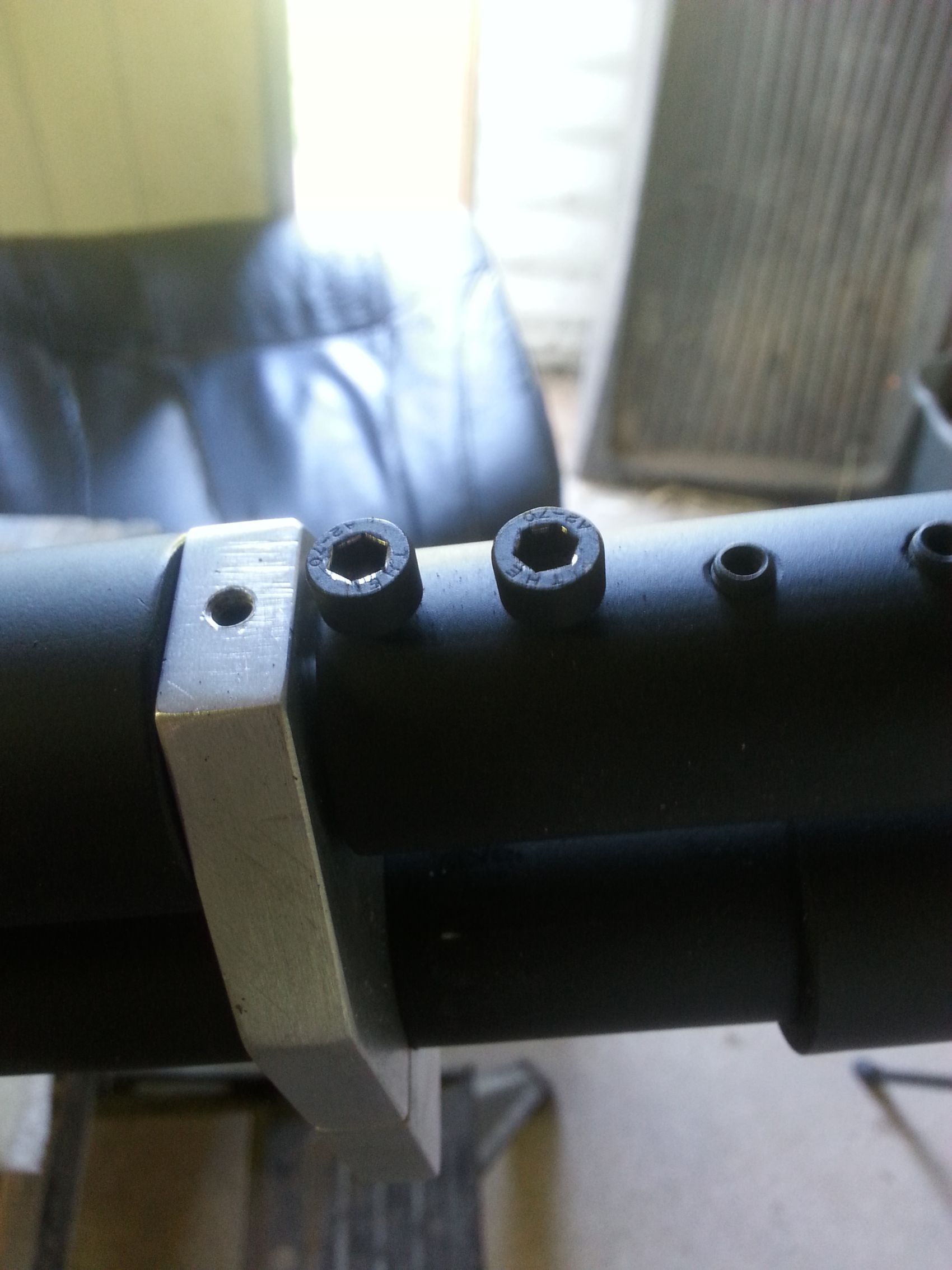

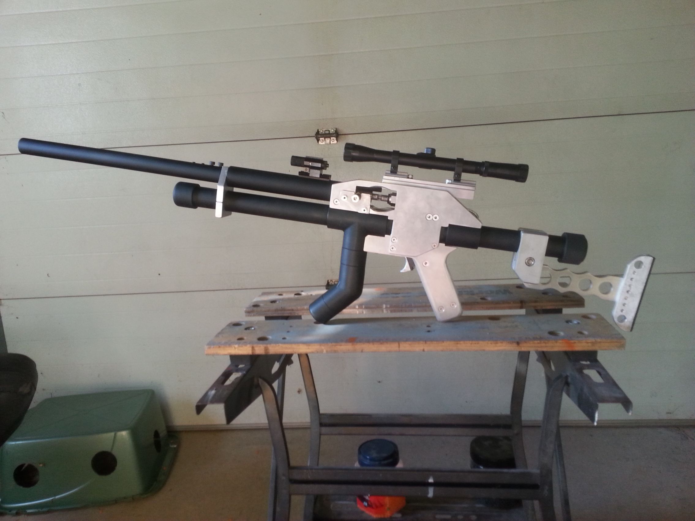

So I got it finished quite quickly today, 2 barrel sleeves and spacers made and painted. Turned out looking better than I ever thought it could. Barrel extension is removable with 2 bolts, stock with 1 bolt.
Fully assembled weight is 3.25Kg (7.2Lbs) length is 1015mm (40") Barrel is 6mm ID/10mm OD seamless stainless, total length 600mm (from breach) 23.5".
short barrel is 280mm (11") the extension is 320mm (12.5")

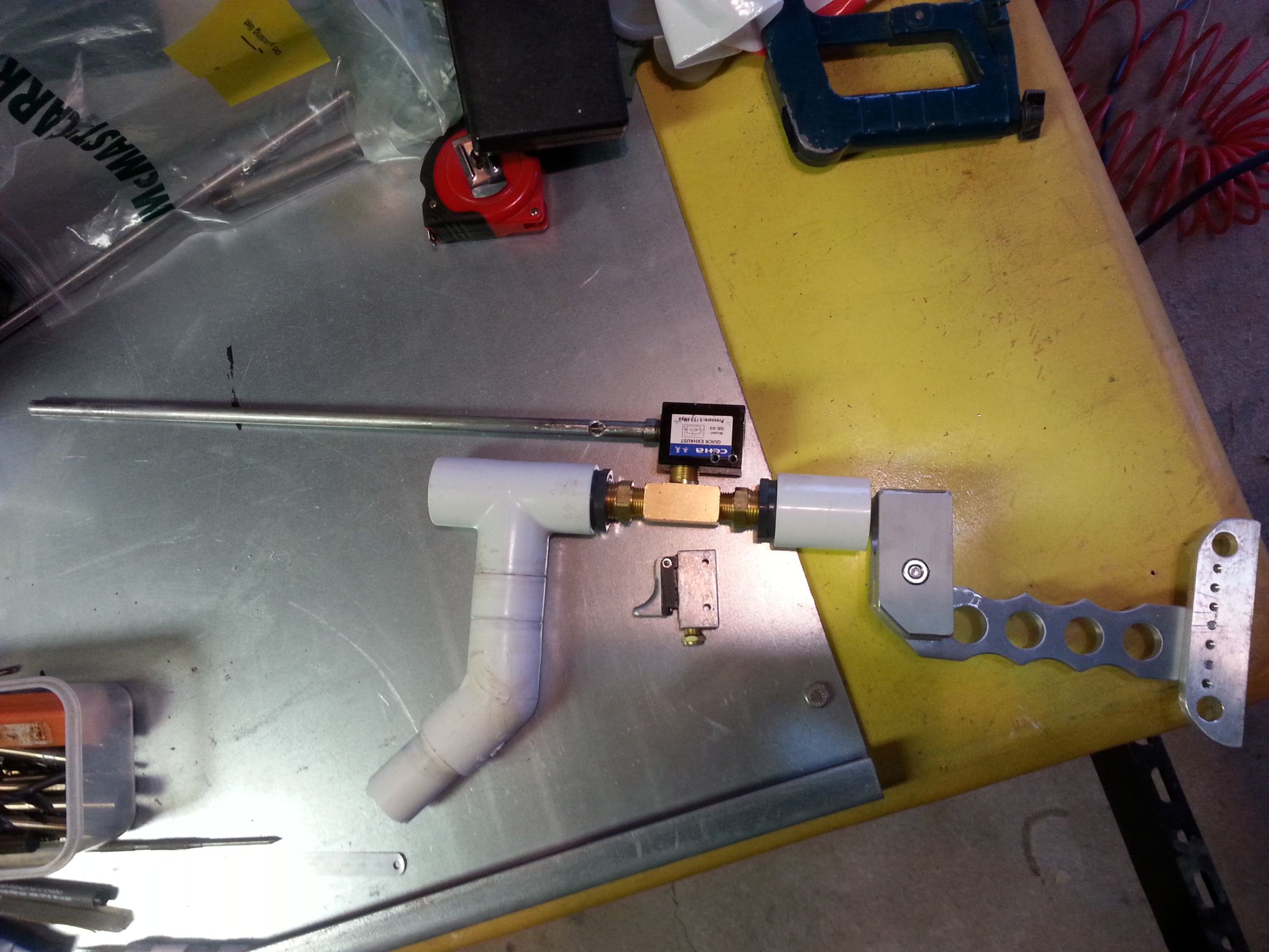

The lower body is the chamber, 1" PVC. The main valve is a 3/8" QEV off Ebay, trigger is a 1/8" 3/2 limit switch.
All the aluminum parts are made from scrap pieces I collected, all hand fabricated, probably 40 to 60 hours to put it together , I never keep track really cause I make parts as I go along for more than one project at a time :shock:

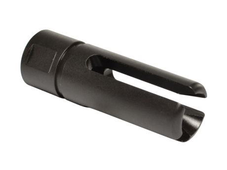

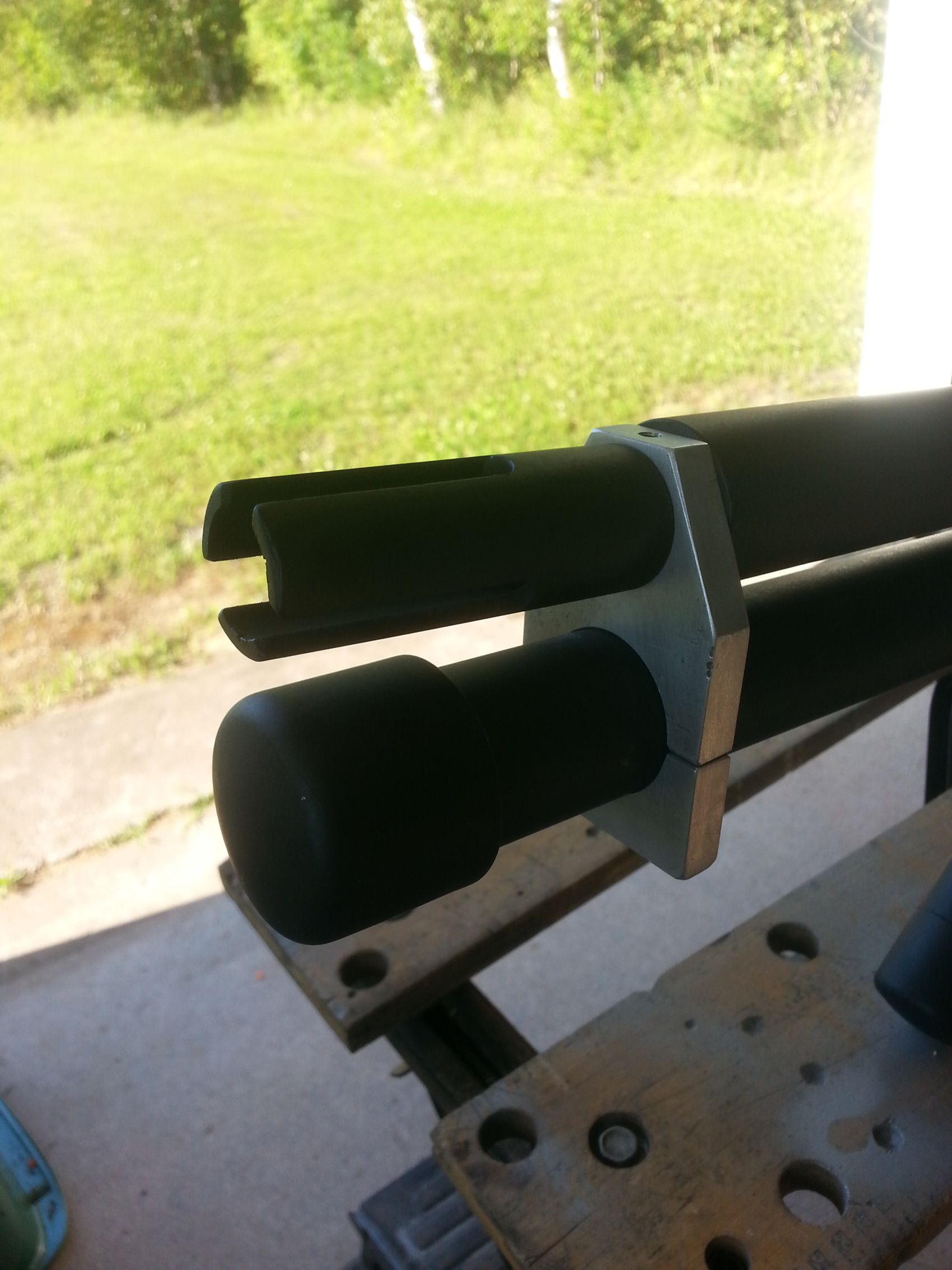

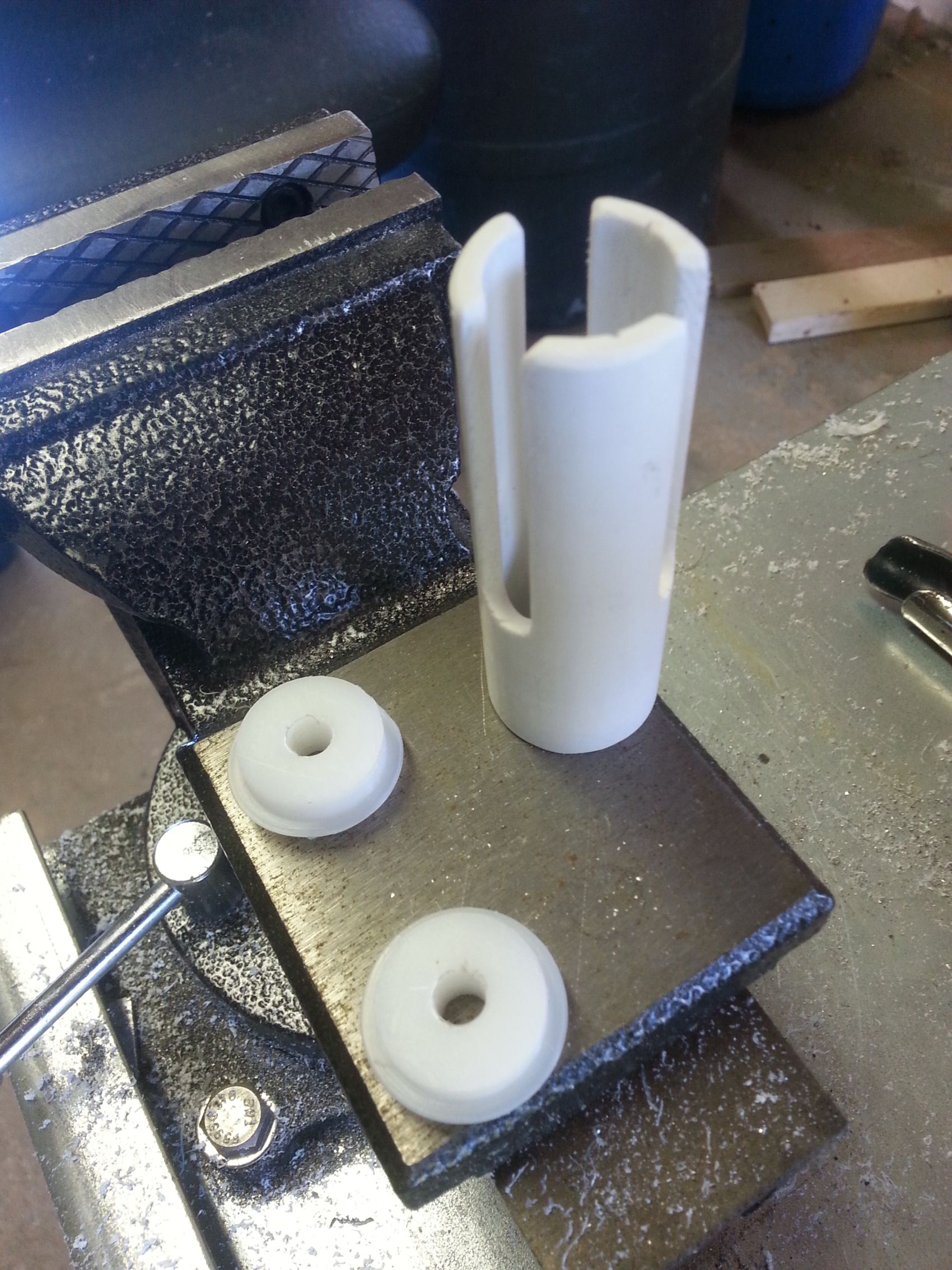

The finishing touches, flash hider under construction
The finished project in short barrel

Nice work on the flash hider, looks very clean overall. I like how the stock is built off of the chamber. Looking forward to the video.

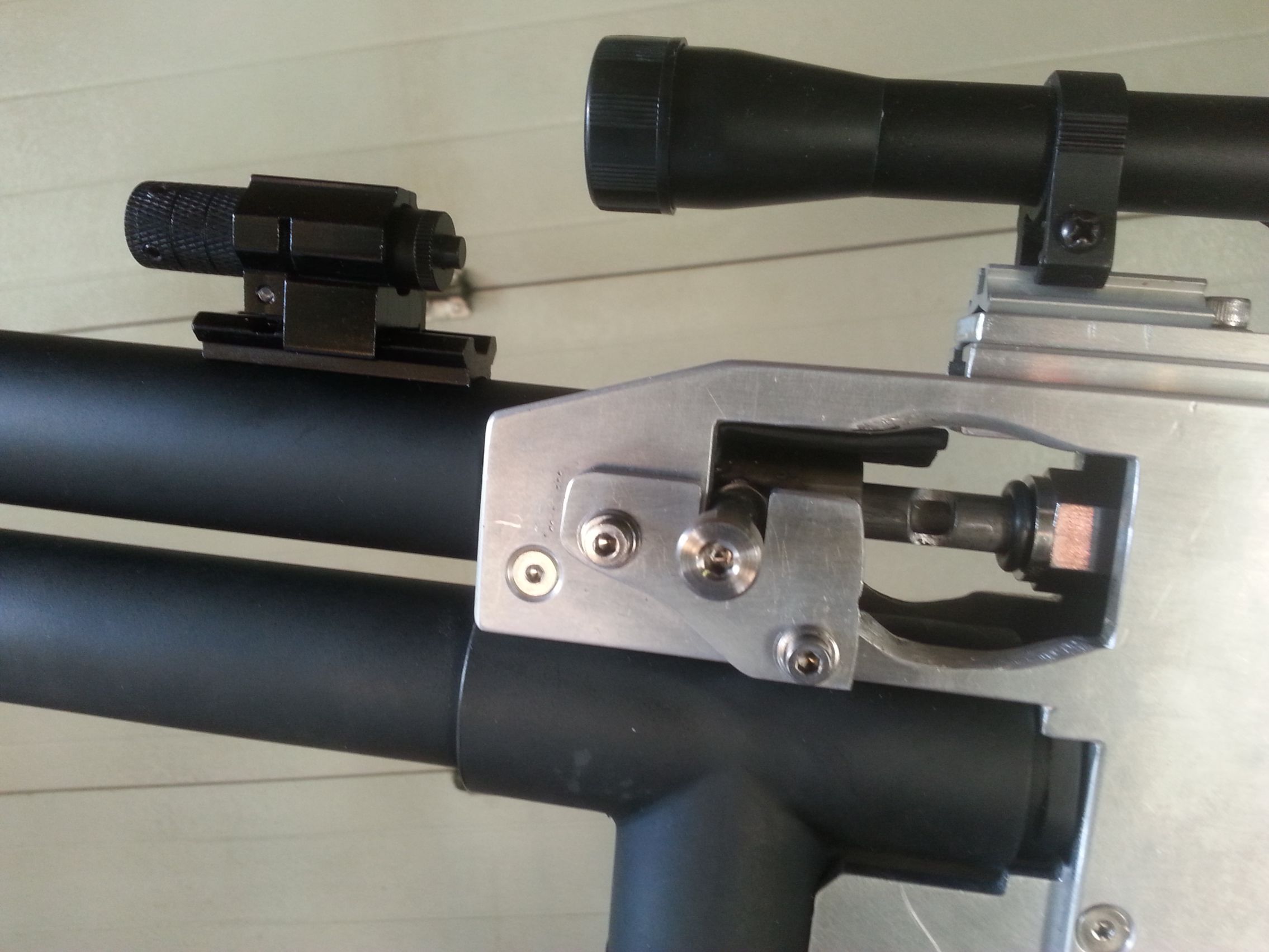

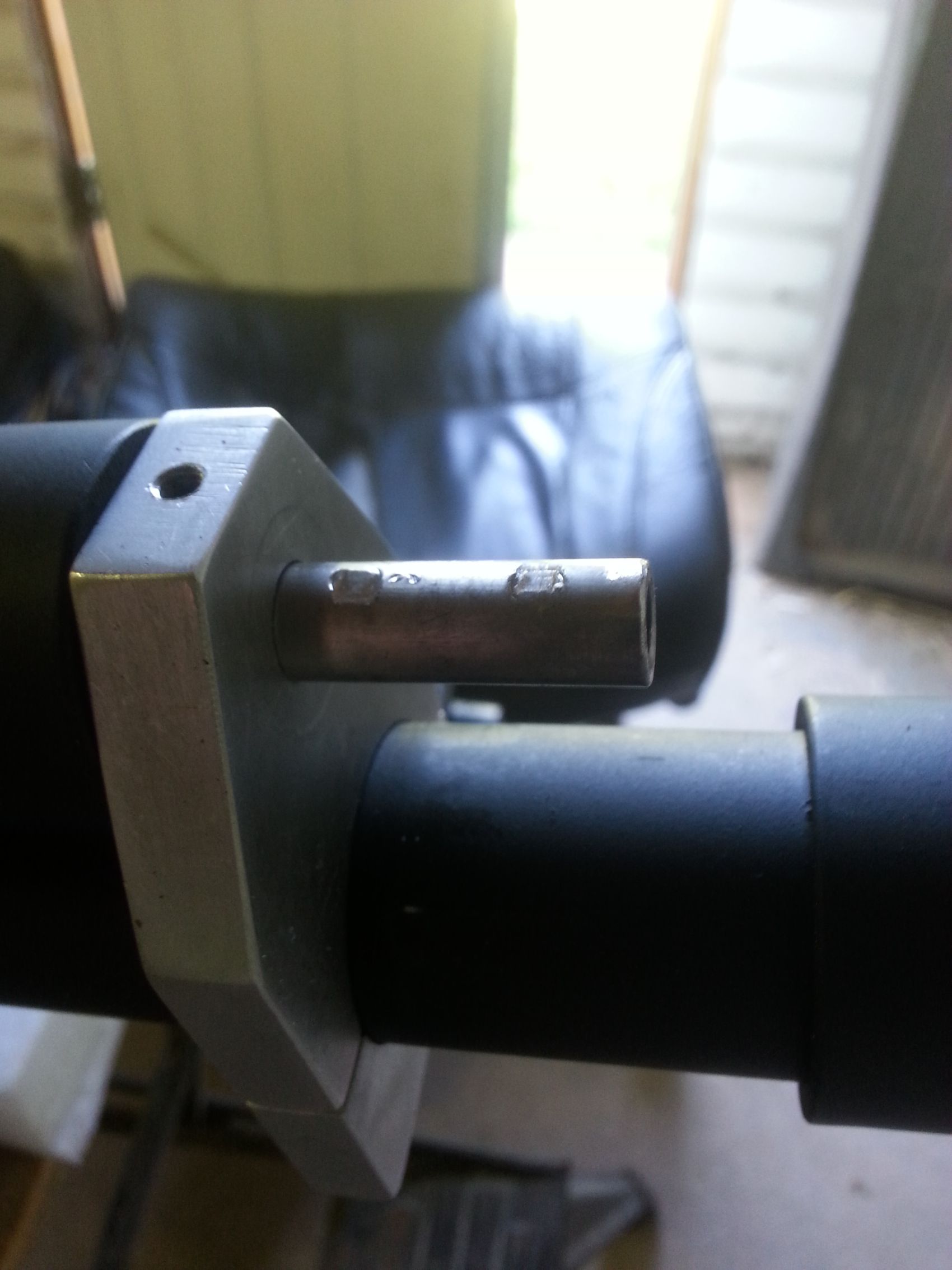

This is how the barrel attaches
Still bugged by poor accuracy, I think the barrel material is actually too tight, it is 6mm ID but not precision tube, if you drop a BB in the barrel it will not freely drop through, my older BB attempts use 7mm ID tube with 1/4' (6.4mm) ball bearings and they are very accurate at close distance, so I might try polishing out the barrel especially the extension, I think the little bumps are acting like multiple hop ups so the BB can go in any direction. :idea:
