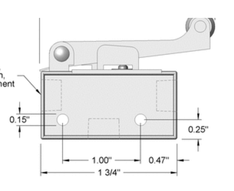

New trigger doesn't work sadly, its leaks once air is applied...sure i have my trigger on the right way around...?
The valve that the trigger is pushed onto, air just gushes from the inside of it.
Air2theBrain wrote:New trigger doesn't work sadly, its leaks once air is applied...sure i have my trigger on the right way around...?
Which type is it?

I taking a guess here..but it has to be de-energized diverter because its a 2-way?
You need to figure out which port does what. The easy way to do it is to simply blow into each of the ports with the trigger in its rest position. The port which is blocked is the one that you will leave unconnected. Now blow again into this port with the trigger pressed. The port where the air exits will be the port that you connect to your QEV pilot. Connect the main air supply to the third port (the one that is blocked when the trigger is pressed).

Ah thank you!
Had it around the wrong way

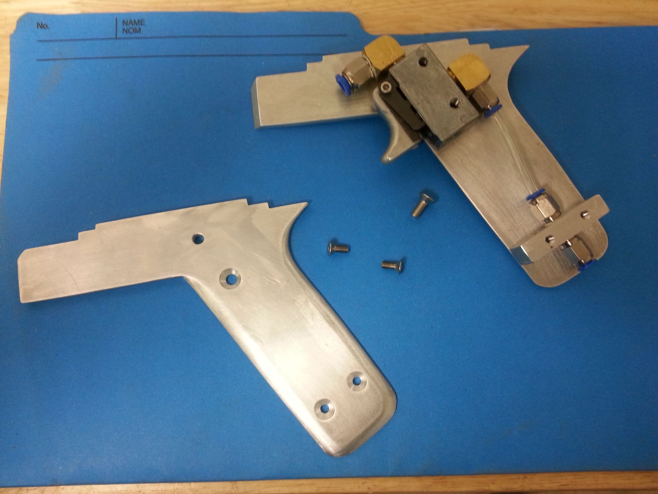

that must have been a 3 port (3/2) with an internal bleed, eg. no access to it and not able to connect to it. I used a true 3 port for my QEV trigger so I could fill through it as well.

Oh i see how yours is very different.
Love the trigger set up, looks great farcticox1. 8)
