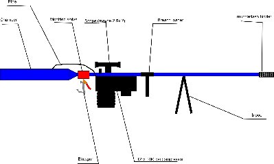

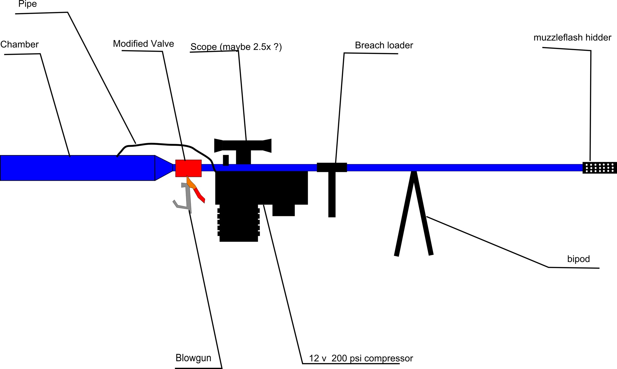

Ok guys , let go this is a schematic of what i would like to build it was very inspirated by rna_duelers sniper
5cm x 30cm pvc chamber
2 cm x 100cm barrel
on board 12v air compressor 200 psi
say me what you think
cya
2 cm x 100cm barrel
cya
i know... :/ i will see when i will buy it , if it's too munch heavy i wont take it onboard , but i would really like to have a all in one gun :/Infernal2 wrote:Ah, an onboard compressor. It will be rather heavy. You could perhaps purchase an air compressor motor and wire it to a portable battery system. Same weight but quicker.
You can, just make a project box...you can put the compressor in a back bag. with the hose directly connected to your sniper. Bolt design is much easer with copper....pvc in france is weak, trust me....i'm french too
