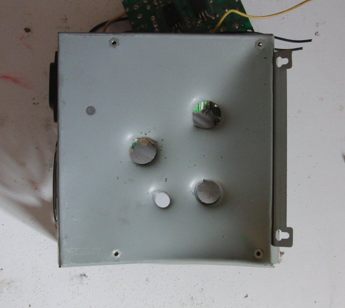

Packs a bigger punch than I first expected :)
I second Rag's motion, you have any chrony or HGDT readings?
As far as damage to the projectile, this is damage after punching holes in stuff. The damage is from remaining KE after going through the crate.

Technician1002 wrote:As far as damage to the projectile, this is damage after punching holes in stuff.
Yeah, that's "wasted" KE, either from impact with the targets or the backstop. But my point remains, it doesn't actually take that much energy to deform a 12g like that, so it may be deceptive.

Ragnarok wrote:Hmm... this doesn't actually seem to be indicative of all that much energy. I've shot air rifles at empty CO2 cartridges before, and they usually look like that after just a shot or two.
That's unfair, I could have made the barrel 6 feet long and the chamber 10 times bigger but I have neighbours to think about ;) for what it is it packs quite a punch.
Speaking of which, I had a morning of chrony testing planned but bloody typical, my last ignitor gives out! I did manage one chrony shot though, at 10x with a 30 gram capsule, 278 feet per second - that works out at 79 ft/lbs (slightly better than your air rifles eh Rag ;)) which is 15 ft/lbs more than the maximum my HPA coaxial managed with the same projectile.

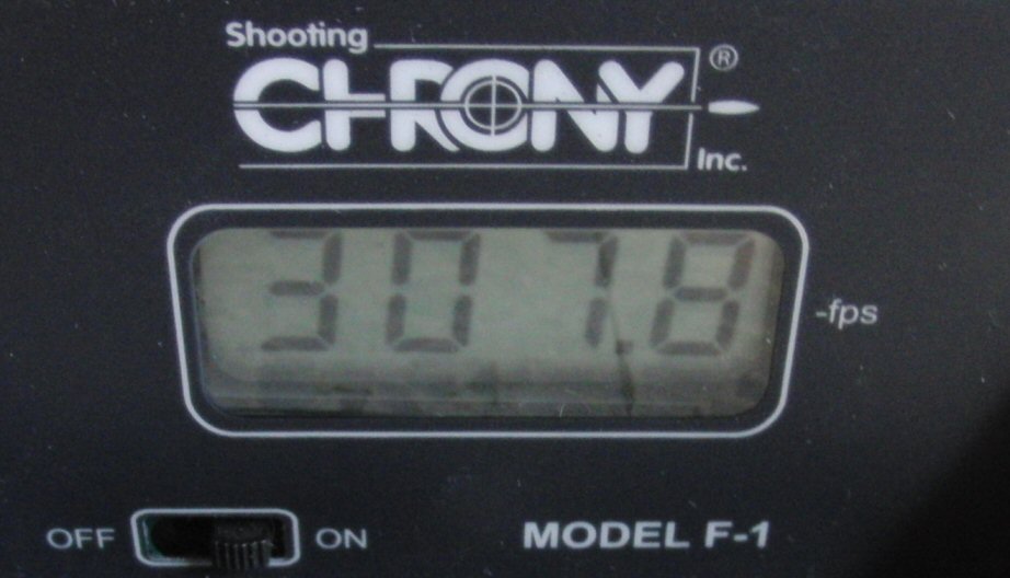

Here's the chrony reading for the plate shot, for a 30 gram projectile that's just under 100 ft/lbs :D

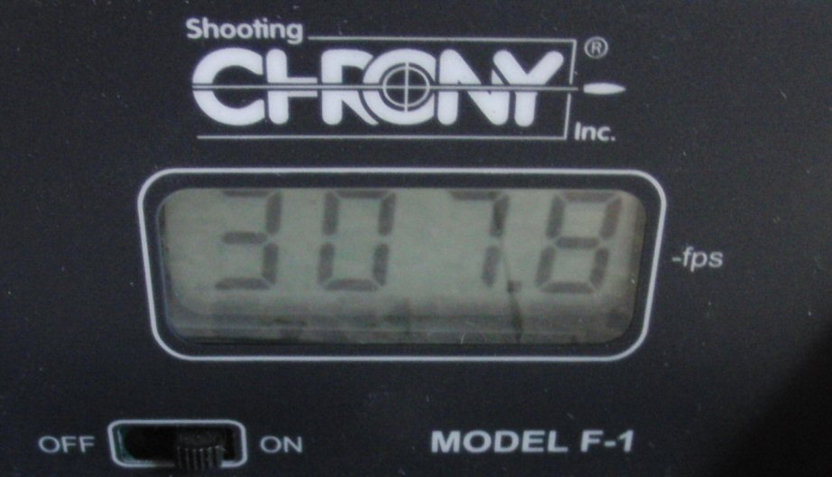

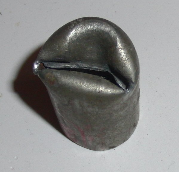

Found the projectile from the toy truck shot, is that enough damage for monsieur Ragnarok :D

jackssmirkingrevenge wrote:Is that enough damage for monsieur Ragnarok :D
Looks more impressive (and seems to have hit quite a solid square edge). Was that just one shot, or the result of several?

Ragnarok wrote:Looks more impressive (and seems to have hit quite a solid square edge). Was that just one shot, or the result of several?
Just one shot, it basically hit the centreline on the truck's bonnet hence the damage.
