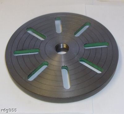

A dead center is used in combination with a faceplate (instead of a jaw chuck) and lathe dogs. A dead center rotates with the face plate and work piece. A live center is used in the tailstock and allows the workpiece to freely rotate.Gun Freak wrote:What's the significance/gain of using a live center over a dead center?

Probably not very well if at all due to the fact there is no point to hold the work piece centered.

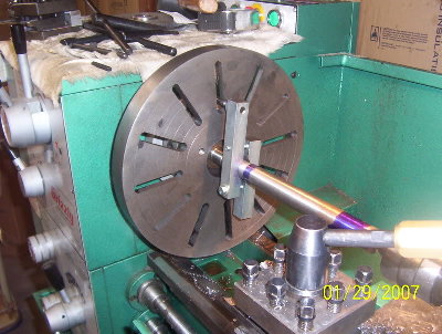

I'd like to see how your setting that up.velocity3x wrote:A dead center is used in combination with a faceplate (instead of a jaw chuck) and lathe dogs

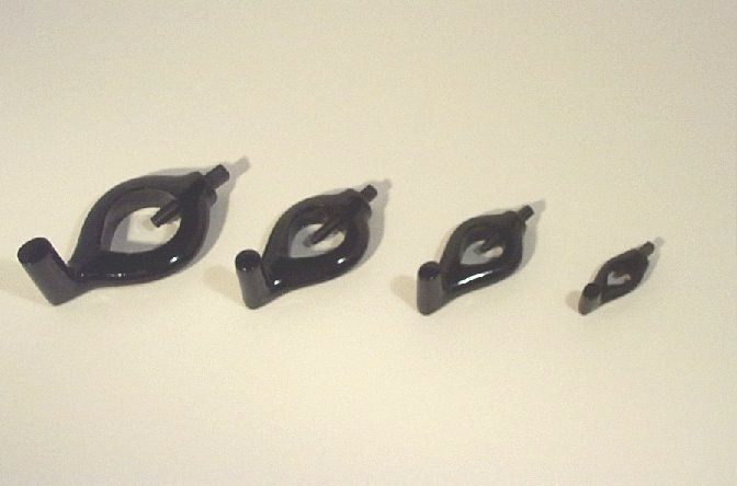

These are pics I found in the net. The last pic shows the dead center in the spindle bore of the lathe and a live center on the tailstock. The lathe dog is homemade. This setup is used for turning between centers. Turning between centers is how you make a crankshaft from a chunk of billet.jrrdw wrote:I'd like to see how your setting that up.

It's hard to see the dead center but I get how it works. I was searching Youtube (keywords: using lathe dogs) for that set up in action but didn't really come up with anything worth posting...
