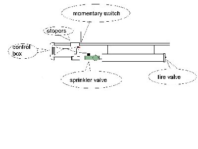

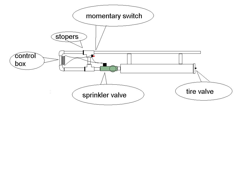

THX I did what you said so here are the plans

Edit: The design looks good. Remember, you may need to add a ball valve between the chamber and the sprinkler valve to help seat the diaphragm.

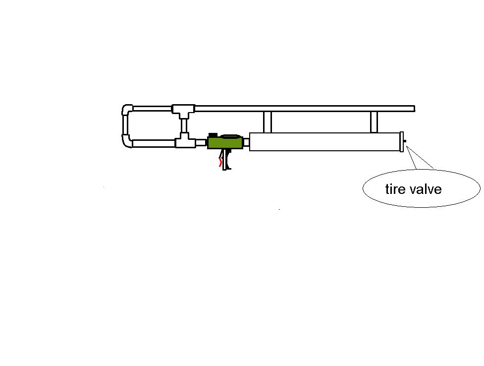

Sry for the bad quality of the top pic, but I think you can make out the basic shape. I'll probbably go with this though now that I know how much better it is :D
I'll probably add some sort of gard to protect the blow gun from being damaged
Edit: Ops :oops: blow gun is on the wrong way.

You can probably omit the "stoppers". Might as well use the the pipe in the "butt" of the gun as part of the air flow path.

spudy buddy wrote:I'll probably add some sort of gard to protect the blow gun from being damaged
spudy buddy
Posts: 123
Joined: Thu Nov 29, 2007 9:27 pm
Oh, that's cool. I'll probably do that. It's just some PVC with a slot in it right?
Without the stopers wont it be worse because not all the ari will be behind the projectile :?:
