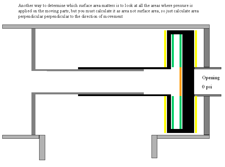

yeah that complication you added doesn't solve anything, you clearly don't understand why pressure produces more force with surface area, because if you did and where applying it to to your design you wouldn't make that mistake.
allow me to explain, compressed air wants to spread out and have more space/volume (decompress), so the reason why larger pistons (with more surface) have more force at the same pressure is because for every inch the larger piston moves, it revels more volume than with a smaller piston, and to calculate volume the first part to find is the volume
refer to the diagrams below
hey do you guys think I should make a thread for this so rather than having to explain to members who misuse area and pressure concepts why their designs are wrong again and again we can just link to the thread
- diagram 1, I spent a good amount of time making these and the explanation so I might be a little late
- presure area 1.PNG (13.03 KiB) Viewed 3618 times

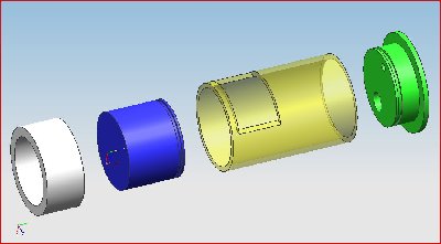

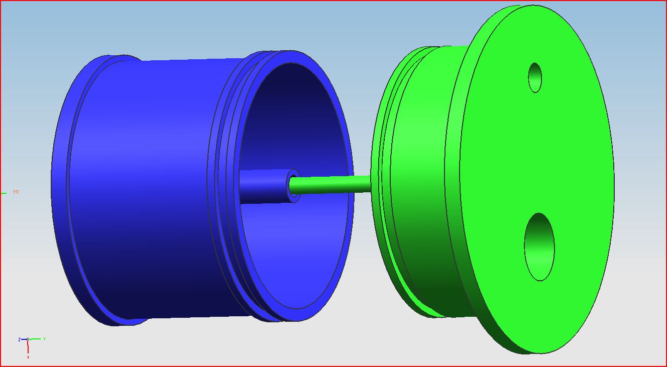

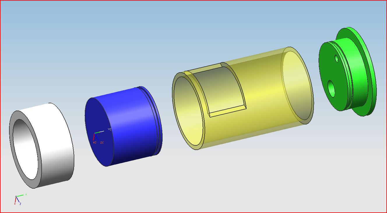

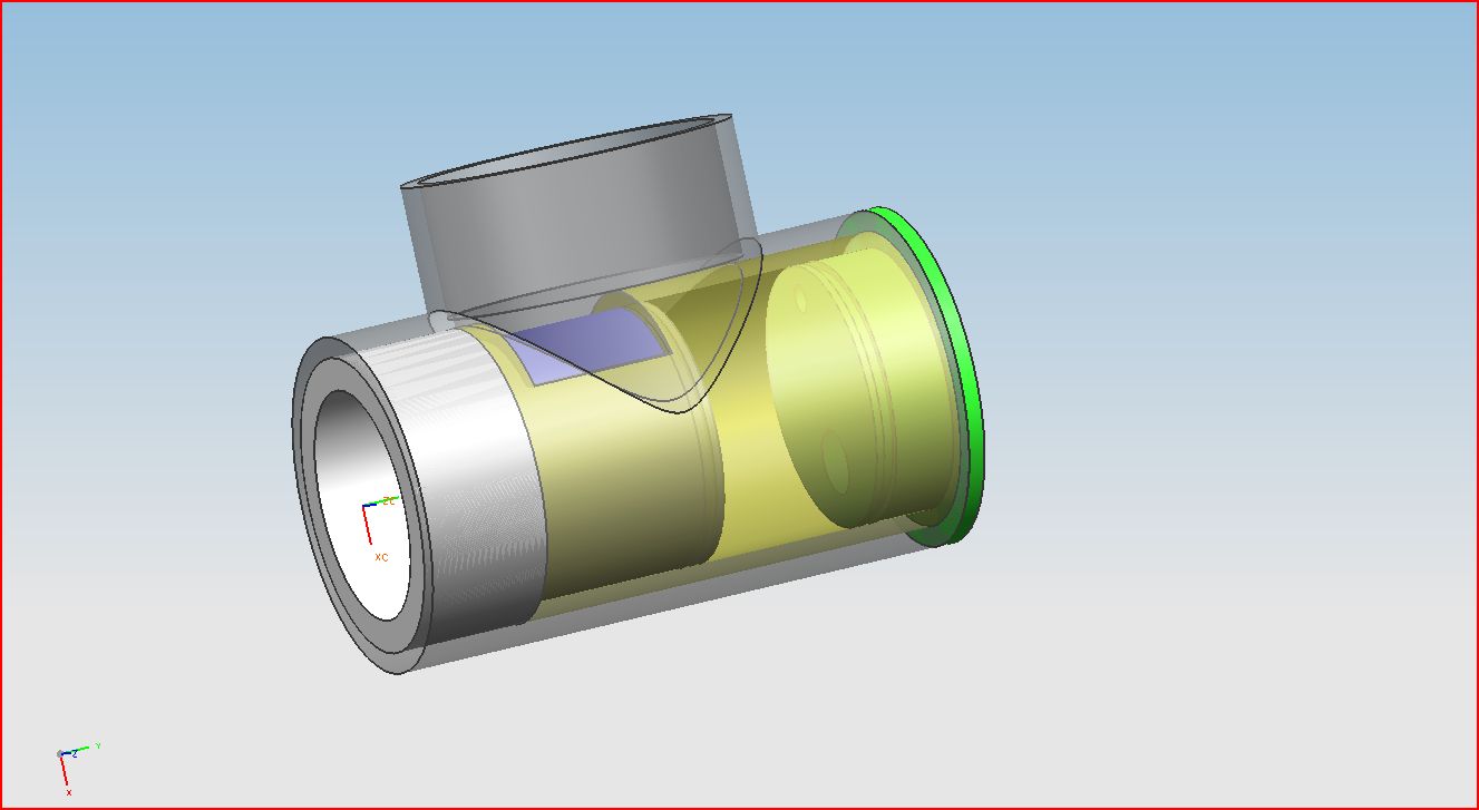

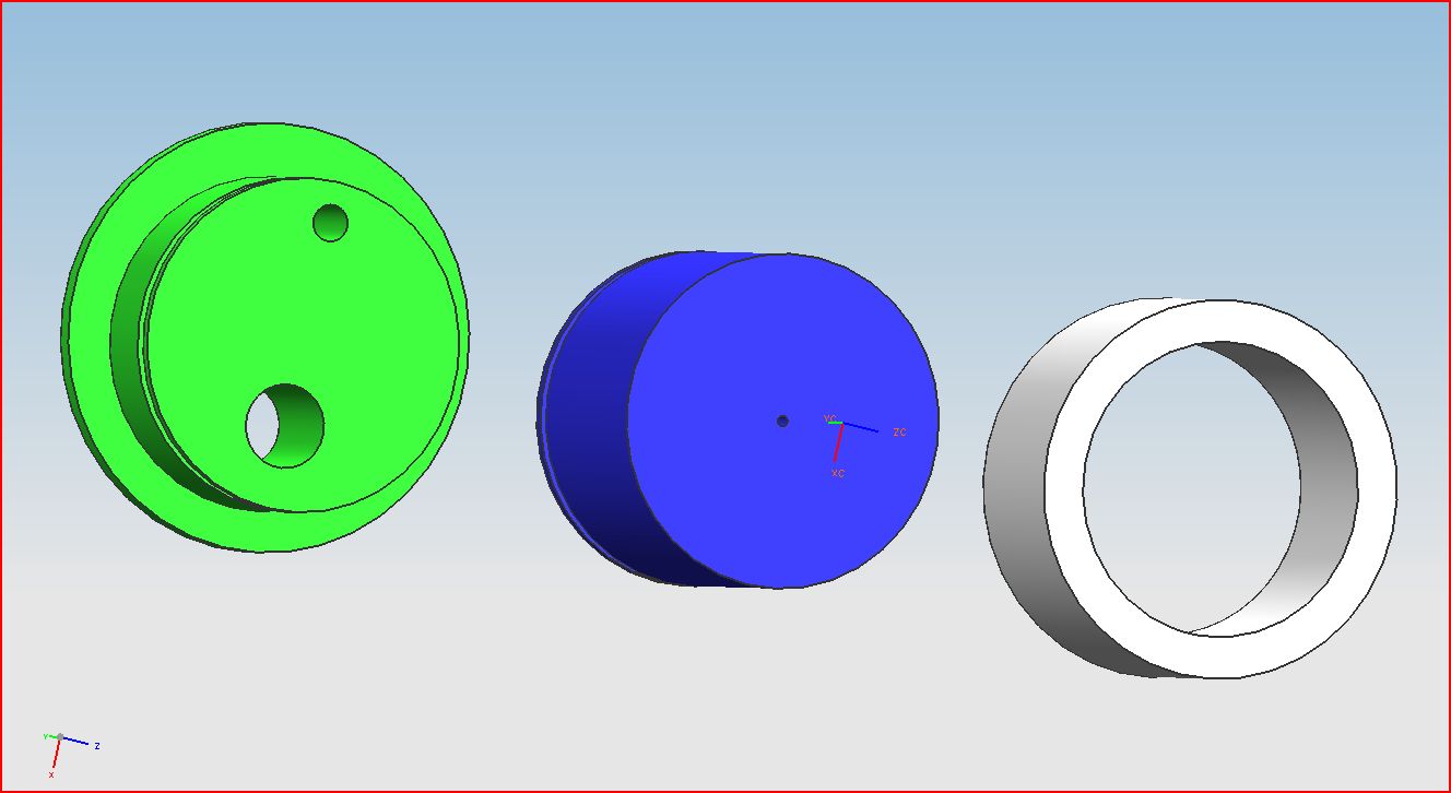

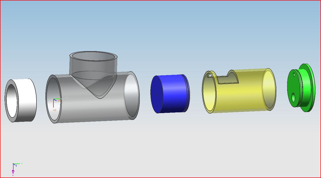

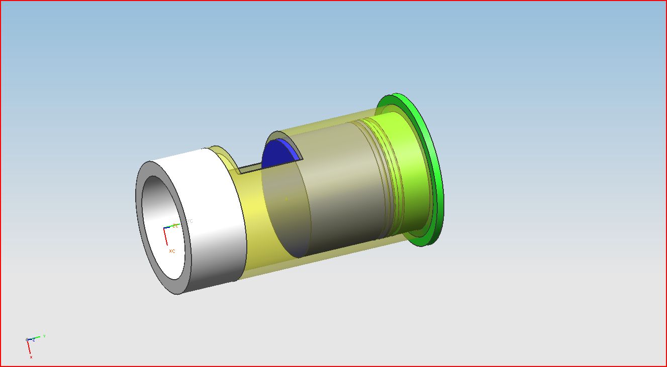

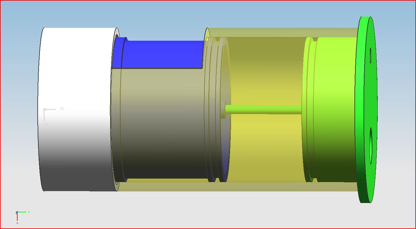

This is another valve design that i drew up in NX5. Basically modified the old valve. The grey tee is your standard sched. 40 PVC tee, but the inside is machined out so the yellow "sleeve" can be placed inside. The sleeve is made out of sched 40 as well with the inside also machined out for a good sealing surface for o-rings. The blue piston and the green back plate are both machined out of type 2 pvc. On the back plate there is a fill hole (small), and the dump hole which goes to a sprinkler valve. There's a 1/8 inch equalization hole through the center of the piston. The grooves in the green and blue are there for o-rings. The white bushing will be the opening for the tanks. We're not sure on if we're going to have the piston seal against an o-ring or put a rubber face on the front.

Is this where I point out that you have YET to put up something which would actually work?

I'm not quite sure why this new design wouldn't work. It wouldn't be the same issue as before with the lack of surface area to hold the piston closed. And this new design is almost exactly like our old one, that was basically two 3" caps sleeved inside a 4" pipe; which worked.

Despite your beautiful cad drawings, your still not thinking it through.
Go back to the basics of WHY a piston valve works (seals and pilots).
Then look at your diagrams again, and (sorry to say it) Clides.
Neither will work as drawn.
Can you figure out why?
Someones still not diggin' the basic principle of having a pilot surface area > than the chamber side surface area on the piston.

The latest design DOES have a pilot surface area larger than the chamber side. The chamber is exposed to a 3.5" diamter opening. That's an area of 9.62 sq in. The pilot side has a surface area of the outer ring plus the surface inside the piston, which is just the area of a circle that is the diameter of the piston. The piston is 4" in diameter. That's an area of 12.56 sq in. I'm pretty sure that the pilot surface area is greater that the chamber side surface area.

Look closer.
And from another angle.
