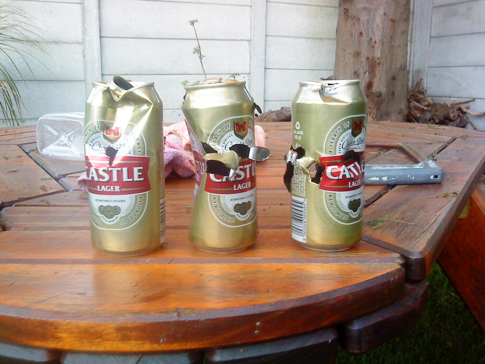

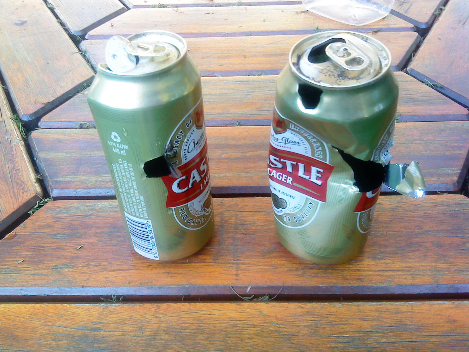

what ammo you shot?
and r she accurate?

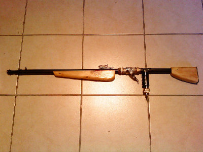

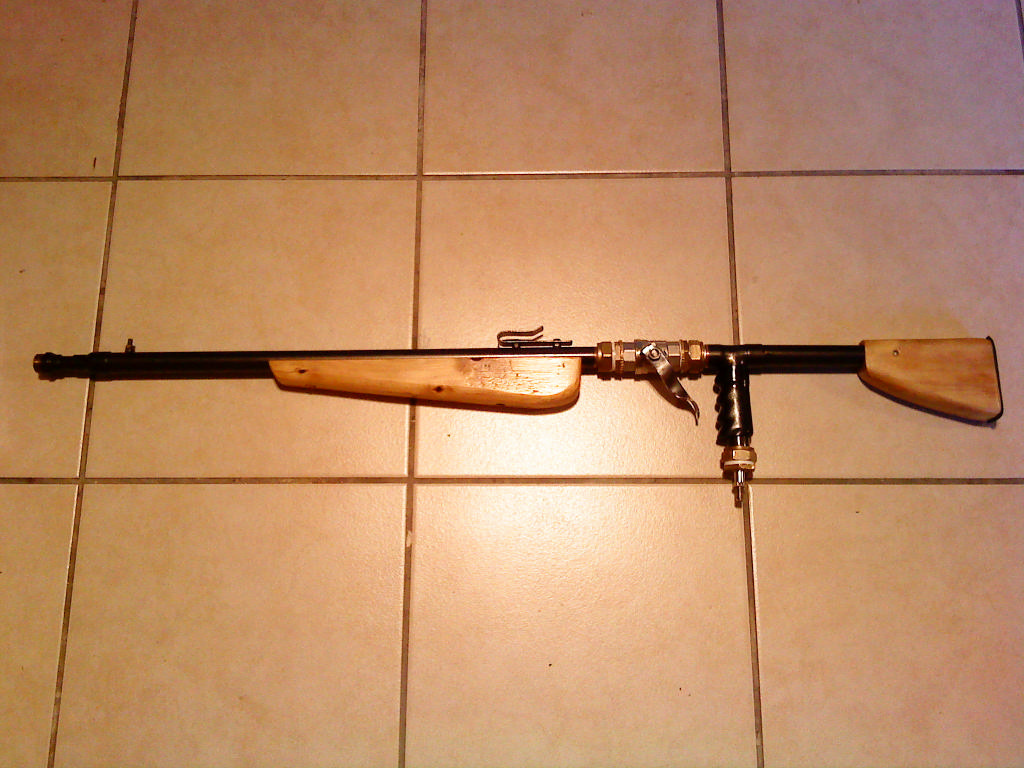

My new coax copper hunter (New "gun metal paint" u
- Brian the brain
- Posts: 3497
- Location: Holland
- Been thanked: 7 times

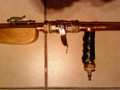

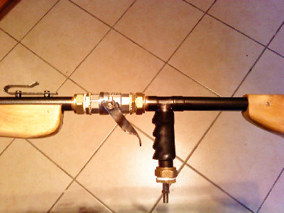

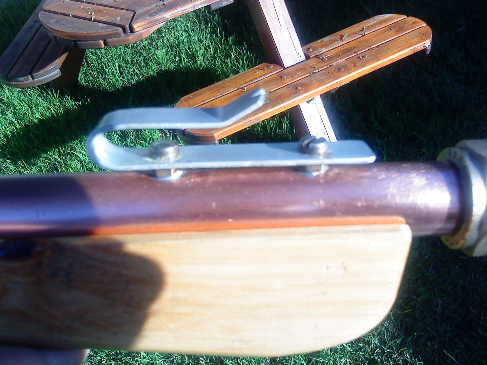

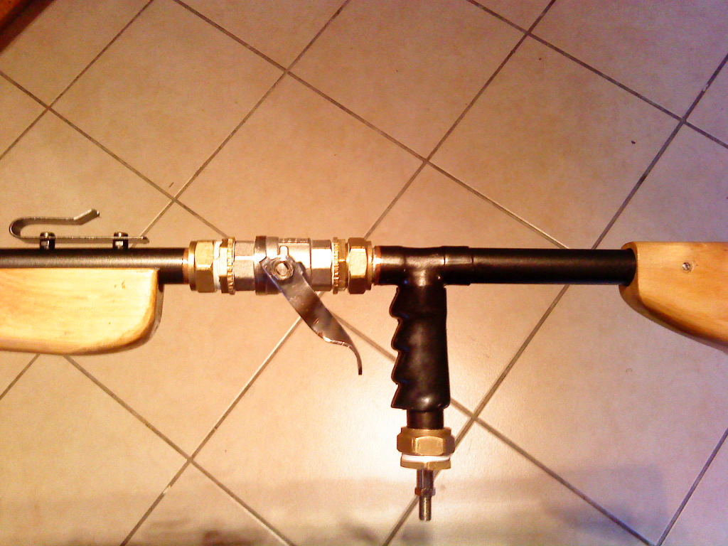

Looks very good!
The hammer grip is a nice solution.
The Tee looks so much better!!
The wood makes this a very special little gun.
Hope to see more work from you.

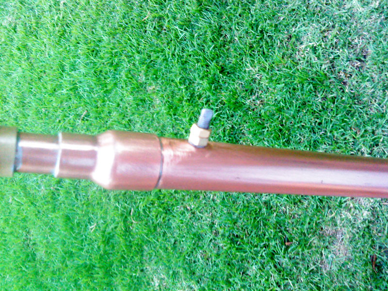

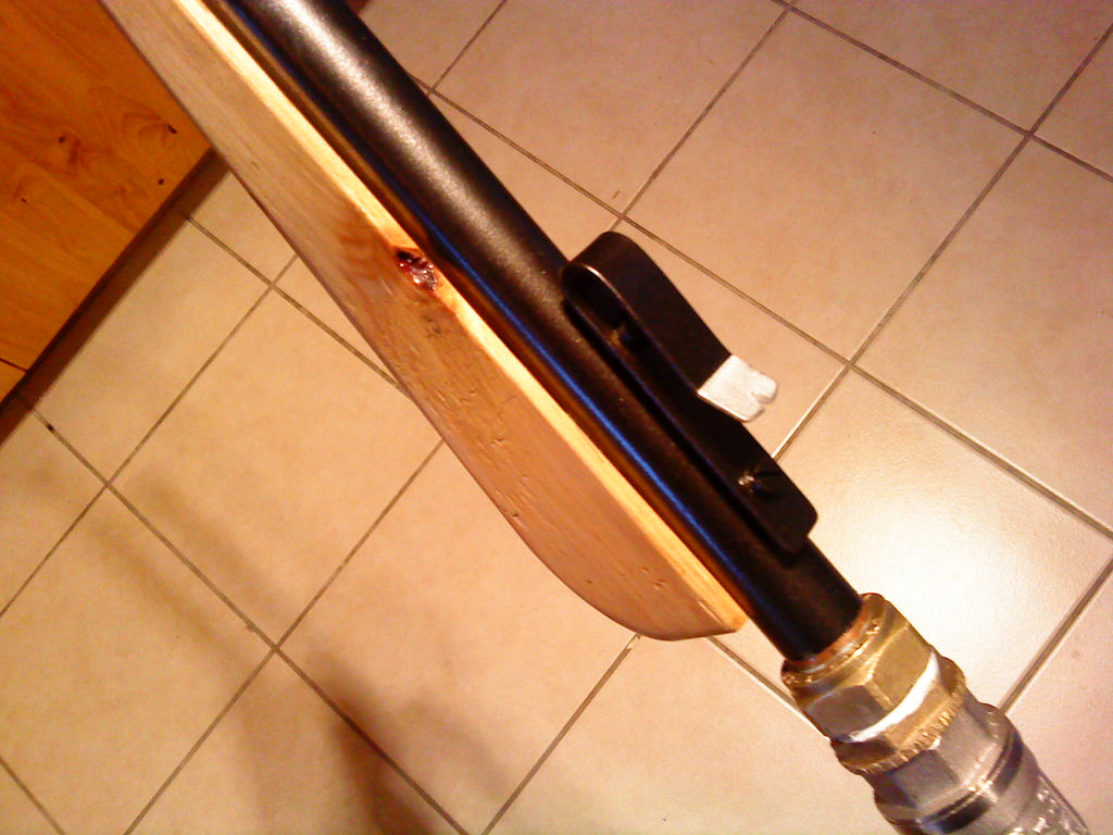

Here is the sight and front sight

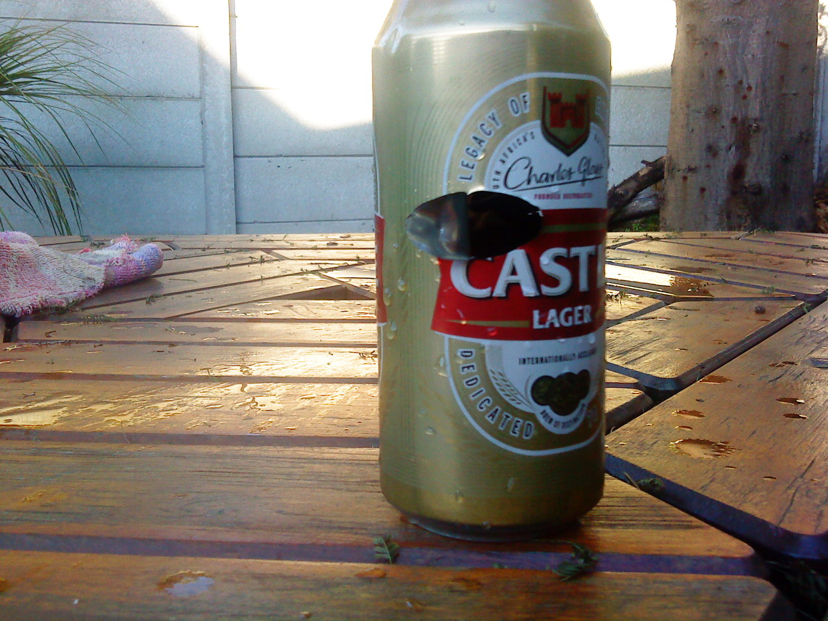

o and i shoot 8-10 mm bolts that is made air tight with electical tape and some towel

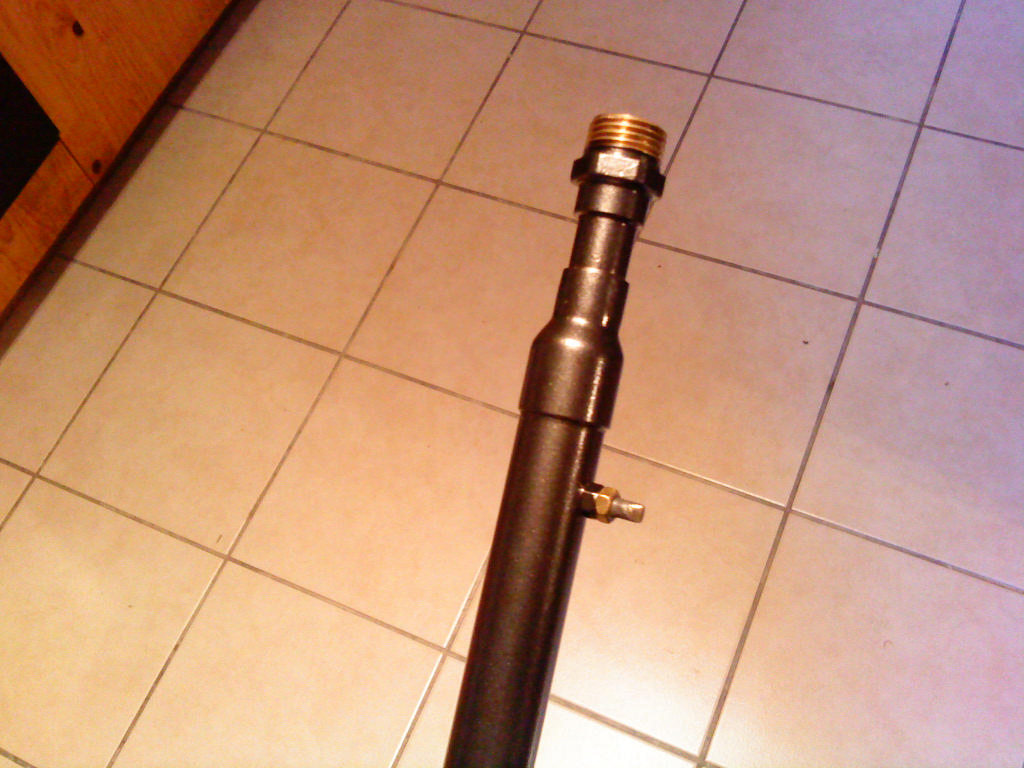

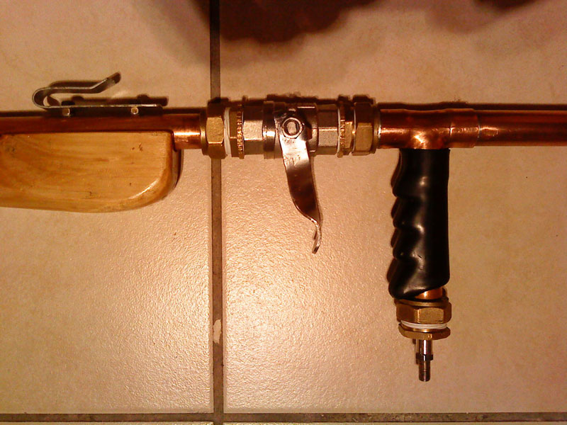

I only took a little flux and put some on the 22 mm pipe then warm it up until the flux melt then I took a copper bolt and lined it up on the melted flux. You then cut off a small piece of solder and drop it in the middle of the bolt and warm it up until it melts and add more solder if needed.
I will take pics and a vid of how to.

Thank ya! The bolts attached like that look so clean... i just cant get over it...... overall, this is basically my dream cannon. powerful, small, and ergonomic.BlackH wrote:I only took a little flux and put some on the 22 mm pipe then warm it up until the flux melt then I took a copper bolt and lined it up on the melted flux. You then cut off a small piece of solder and drop it in the middle of the bolt and warm it up until it melts and add more solder if needed.

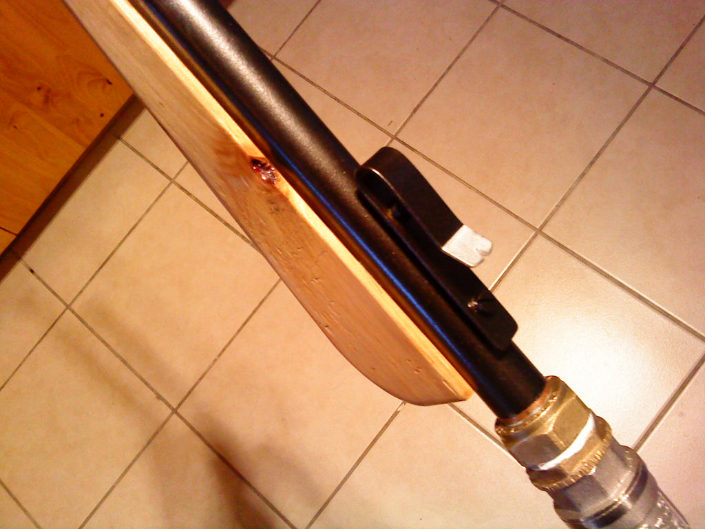

New paint job

it loos alright, but does the pipe that goes into the stock bleed through the shoulder? that's a little weird...
I would have just left the valve without the other end, and make a FULL stock for it, that would look pro, be lighter, and more ergonomic.
