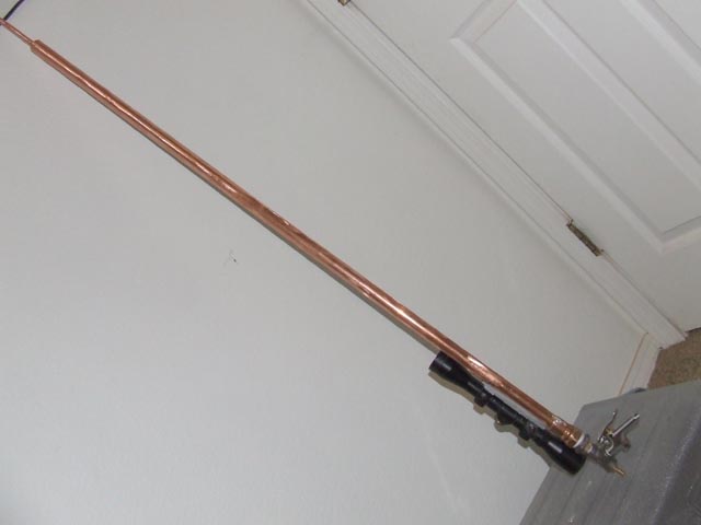

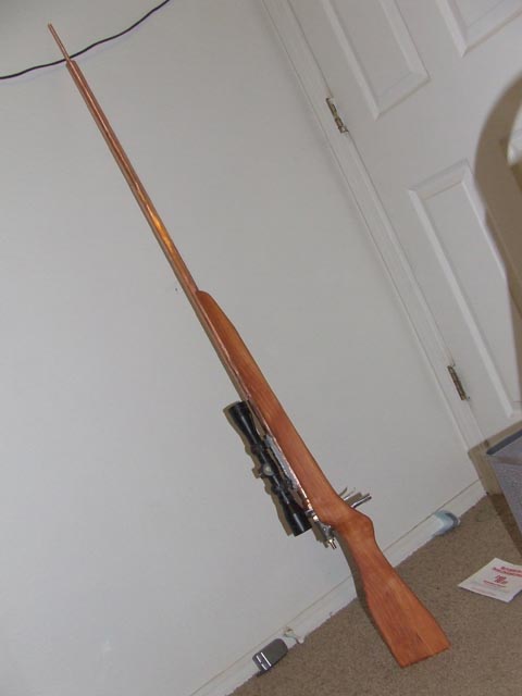

So here is my latest spud creation. At heart, she is a simple coaxal piston made from copper. I just prettied it up and made it more fun to shoot with a custom stock and scope.
Compared to my last copper cannon, this one seems kinda weak. I think that is due to the weight of the ammo that I am using for this one. My friend gave me a box of 308 caliber bullets and the fit very nicely in my 1/4 inch copper barrel, but they are a LOT heavier than the marbles that I shoot out of my other larger qev gun.
Anyways here are some of the specs...
Barrel: about 40 inches of 1/4 inch copper
Chamber: about 30 inches of 3/4 copper tubing. I blocked off some of the chamber with epoxy.
Valve: A piece of wooden rod with a piece of neoprene epoxied on

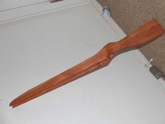

Stock: A chunk of 4x4 doug fur carved with nothing but a skill saw, jig saw, and sandpaper. then stained.
Pilot valve: Blowgun
The full completed piece.

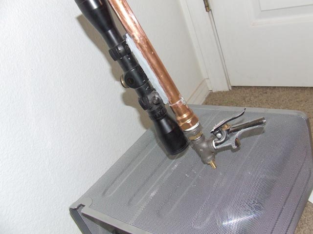

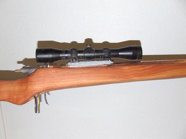

The trigger and scope with no stock
A close-up of the scope and trigger.

The stock
The stock

All I can say is wow, this is a very nice looking gun! also what pressure do you use your copper at, I normally use them at 200-250PSI. I have to say I wish I could craft like that :oops:, this is the definition of ergonomic!
jook13
Posts: 434
Location: Prescott Arizona
Normally I would take it up to around 350 psi or so. But my fridge compressor took a poop and I need to build me another. For now I take it up to the 150 that my compressor allows. Or if I am feeling frisky, I can use my shock pump, but is just too much work...
Prettied up indeed :) shame about the "unnatural" length, it looks like a Mauser T-Gewehr :) I would have considered a trigger extension and making it a bullpup. It would look good with a bipod though ;)

Thanks guys. It is a shame about the unnatural length, but I imagine the power will be worth it when I get the power up. The stock was kinda an after thought, but I still like the way it looks.

I imagine you could just cut off the extra bit of blowgun and just leave the trigger...?

When I said "get the power up", I meant get my high pressure pump up and running. I have shot it at up to 150 psi so far. I had a fridge pump, but its broken. At 150 psi, This isnt too impressive, barely making it through a piece of 1/2 inch plywood. I plan to make videos when I get my next fridge compressor up and running (should be soon, I have an extra in my garage, just need to put the fittings on)
And about cutting off the end of the blowgun, that is a pretty good idea, I think I will do that too.
