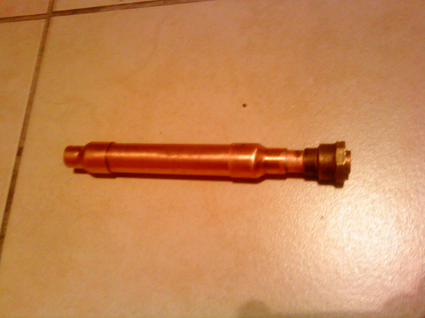

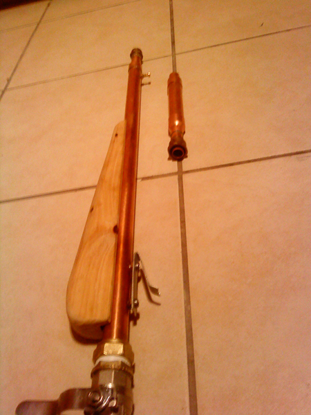

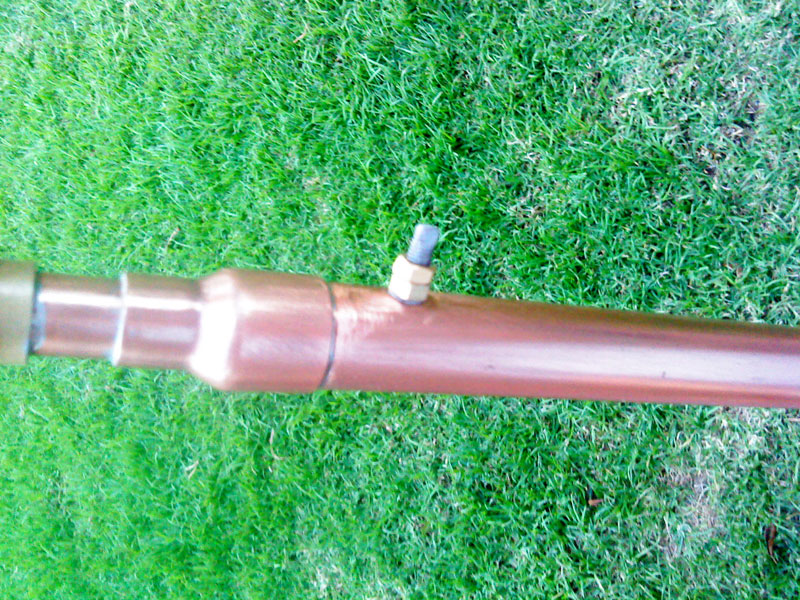

My new copper gun with piston and a nice aluminum sight and detachable silencer with steel wool sepressor.
Ask away
Work at round about 200psi now (New pics of gun on page 2)

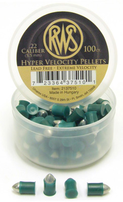

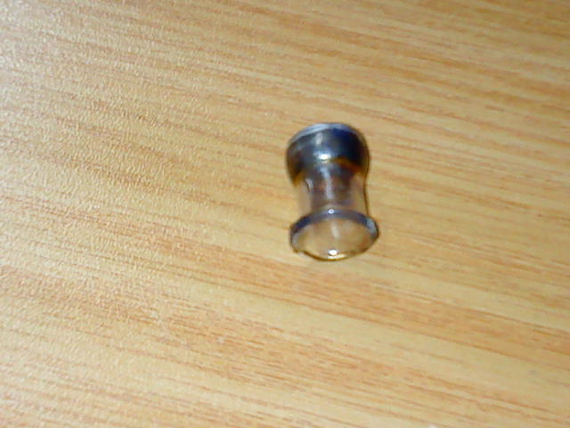

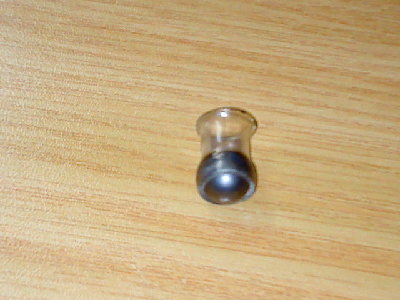

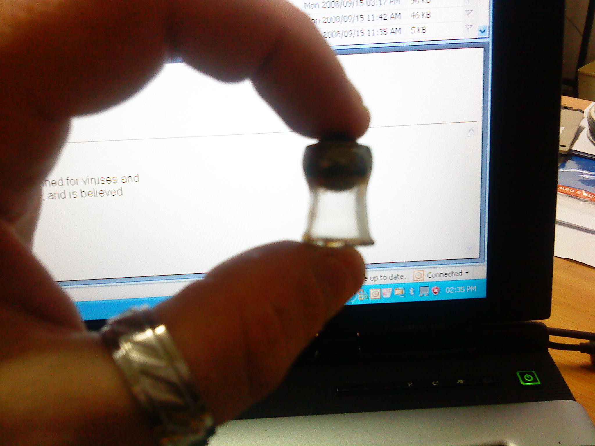

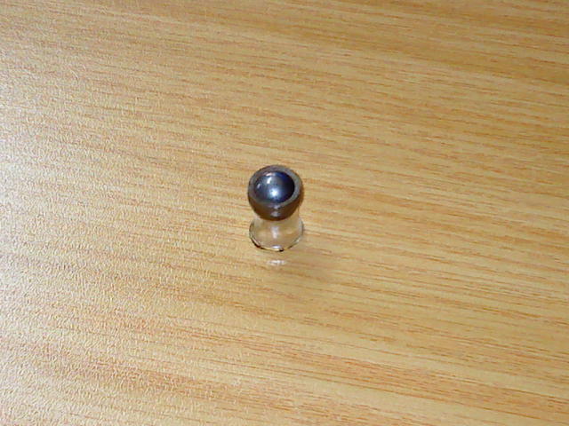

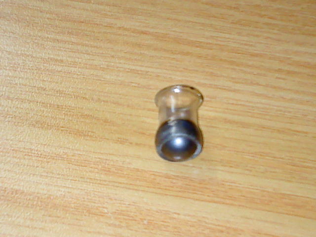

Edit: the new bullets is a 13mm steel boll with a 10mm fish tank hose over it and the rear has been heated up and bended outwards to create an air seal that will seal if air hits it, like a air gun pellet, the lead free ones like these.
o ps and a little Q-bond in the inside to make the steel ball stick.

More about the "Pellet"

My bullets is based on this air gun pellet
My new Bullets
My new Bullets
My new Bullets
My new Bullets
My new Bullets
My new Bullets
Side view to c the form better

wow I am impressed.... that sight looks really nice
does the silencer work good at reducing sound ? I suppose it does because you gun already has features that make it quiet
sniper hero

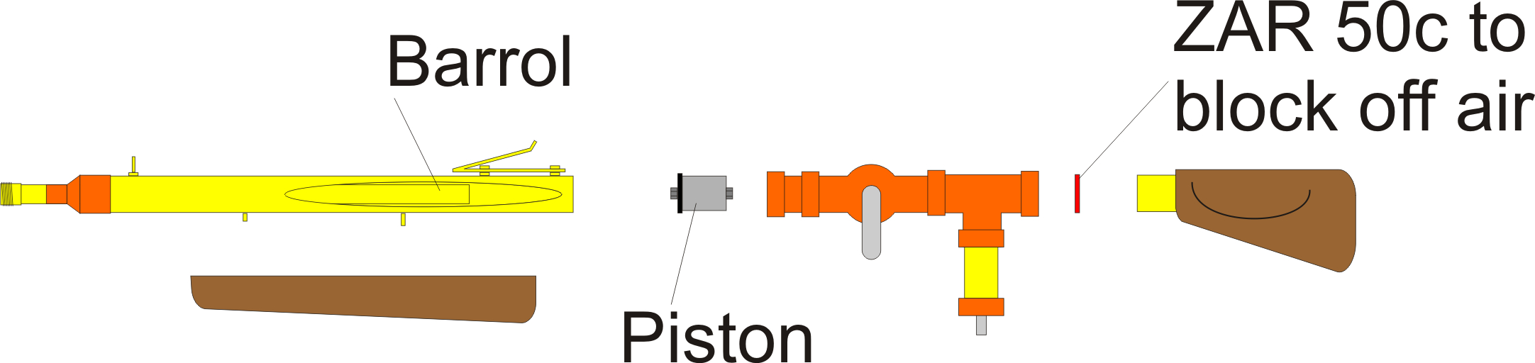

but a piston ? how did you do that?
BlackH
Posts: 73
Joined: Thu Feb 01, 2007 7:24 am
Location: Cape Town, South Africa
It works like this:
And the silencer works ok, it takes away that Crack sound but you will still here the gun loud if you take the volume of the silencer up to say a 2 or 3 times the barrel volume it should work very good but then your gun looks weird.
coax..

ok now I understand :P
