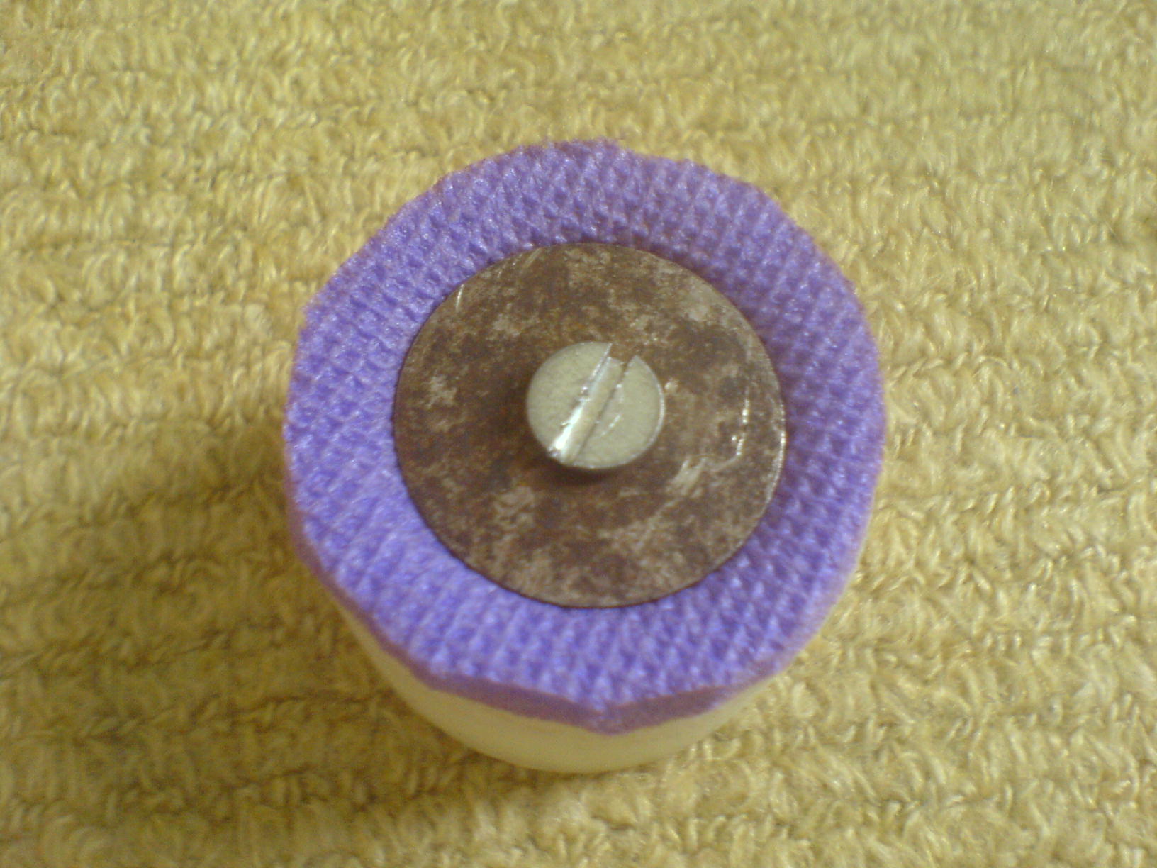

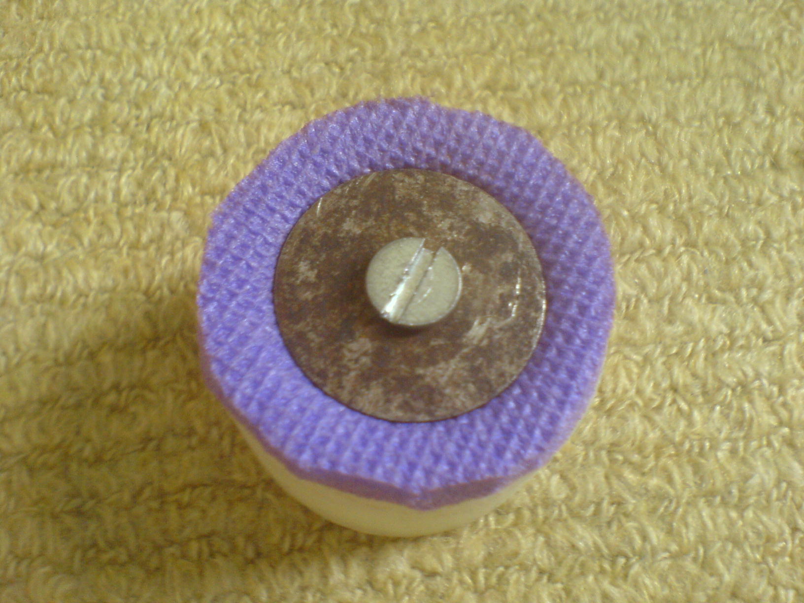

The squishy foam has 2 problems.Jogumpie wrote:Here is a pic of the new nylon piston, with "unique" sealing face.
1) Getting a good seal with the waffle pattern to pressurize the chamber can be difficult to get a seal before pressure is enough to flatten it.
2) The soft foam is open cell so gas leaks through it and may get torn off when fired.
A smooth flat hard rubber washer may be a better choice, especially at higher pressures. You may want to test the product and be sure of the reliability.
Performance videos are good.
x2Technician1002 wrote:The squishy foam has 2 problems.Jogumpie wrote:Here is a pic of the new nylon piston, with "unique" sealing face.
I used this as my sealing face on my 3" piston:
And it worked perfectly up until 40 PSI. Then after a few shots it was torn apart. I've been using a cheapo 1/8" neoprene fender washer found at the hardware store, and it's been working great ever since.Ultra-soft Polyurethane Sheet, 1/4" Thick, 4" X 4", 70 Oo Durometer

Ok, i'll look into sealing face alternatives.

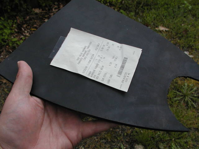

Even a piece cut from an inner tube would work better, but often this is not perfectly flat and smooth. If you are in the US, hit some True Value hardware stores. Some have sheet neoprene rubber by the sheet.Jogumpie wrote:Ok, i'll look into sealing face alternatives.
EDIT Promised photo added of neoprene at 70 cents/lb.
I need to get my glasses fixed. I didn't pay enough attention. I added some other stuff at 70 cents. It's a pound of neoprene at 3.50/lb.
- Sheet neoprene from my local hardware store priced per pound.
- Neoprene.jpg (37.17 KiB) Viewed 4388 times
- Price slip from True Value hardware store. 3.50/lb.
- Price.jpg (37.03 KiB) Viewed 4378 times
Last edited by Technician1002 on Thu May 14, 2009 4:15 pm, edited 2 times in total.
