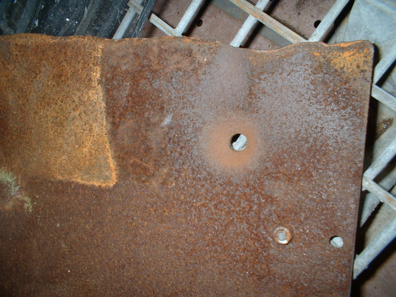

jackssmirkingrevenge wrote:Great stuff, have you considered a harder (steel?) core when it comes to punching holes in harder materials? In the vein of Armor Piercing, Composite Rigid rounds?
We did use steel inserts I just never photographed the setup, but I will update soon. The photos in the beginning of the thread we're taken after steel insert rounds. We will load up the 625 with carbide and see if we can penetrate that pesky 3/16 C channel.
Mike
1/8 plate steel

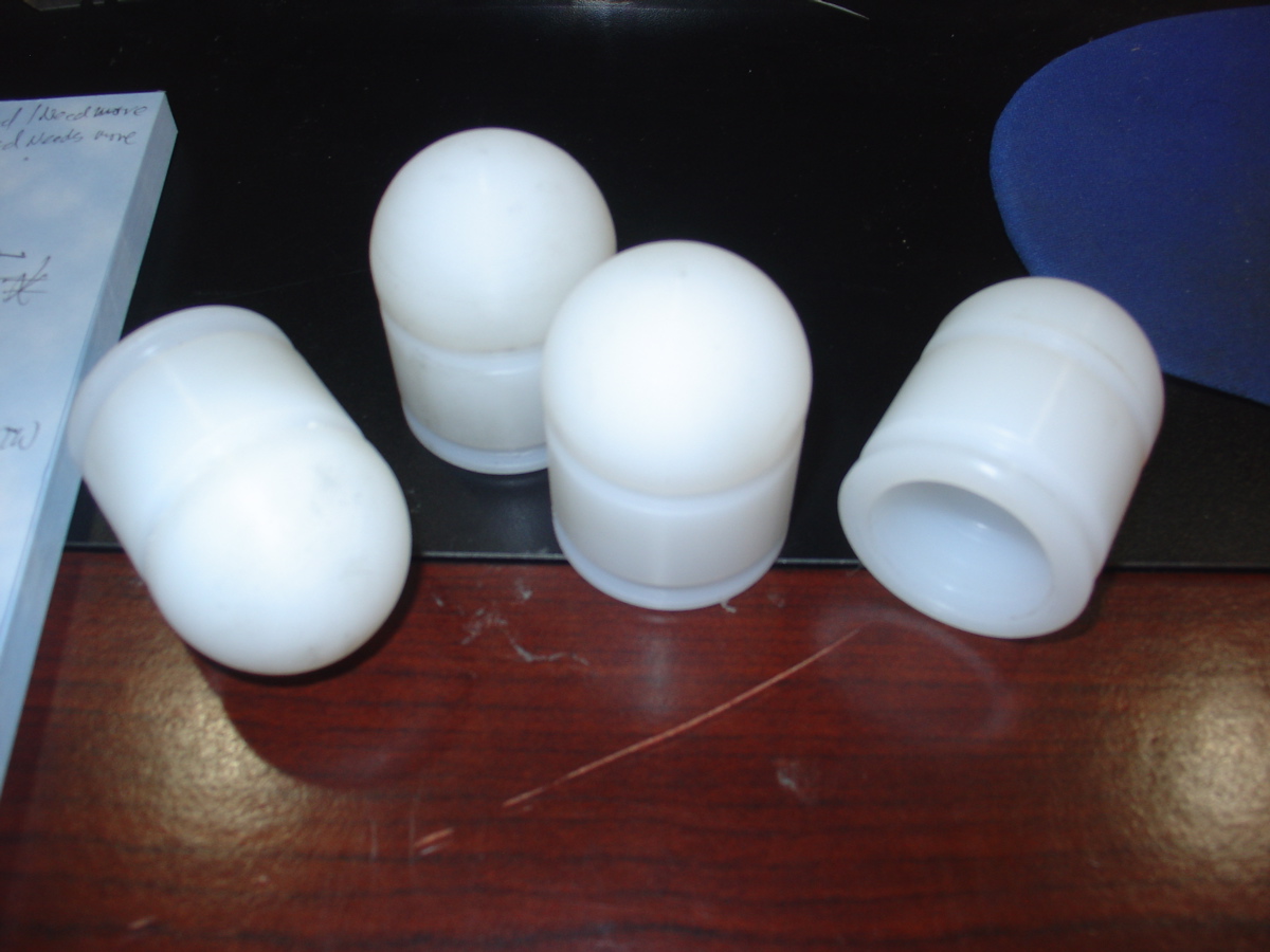

It is the beauty of CNC lathe. I will take recommendations and R&D new designs for optimization. If you guys write HP in the order comments and give dimensions we will size a hollow point for carrying.. "stuff" Our test round HPs would occasionally lose there pay load but retained shape and usability even with the shots to steel.
These HP rounds do sing with a steel insert. :shock:
Check out the 1.7s right from the lathe.
Mike
1.7" rounds
