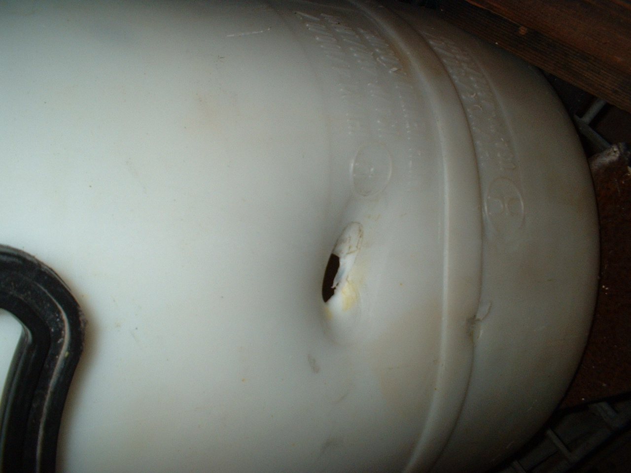

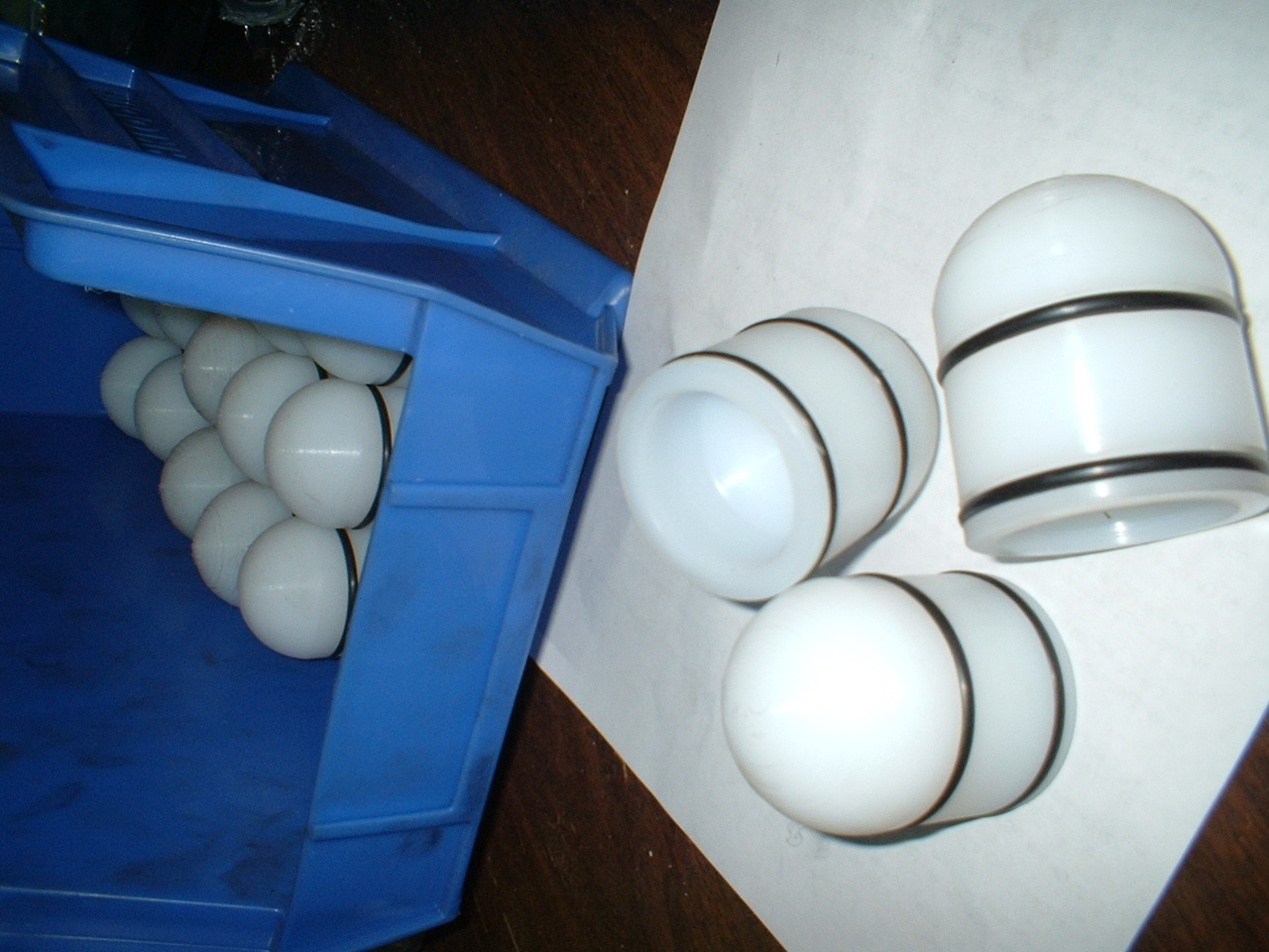

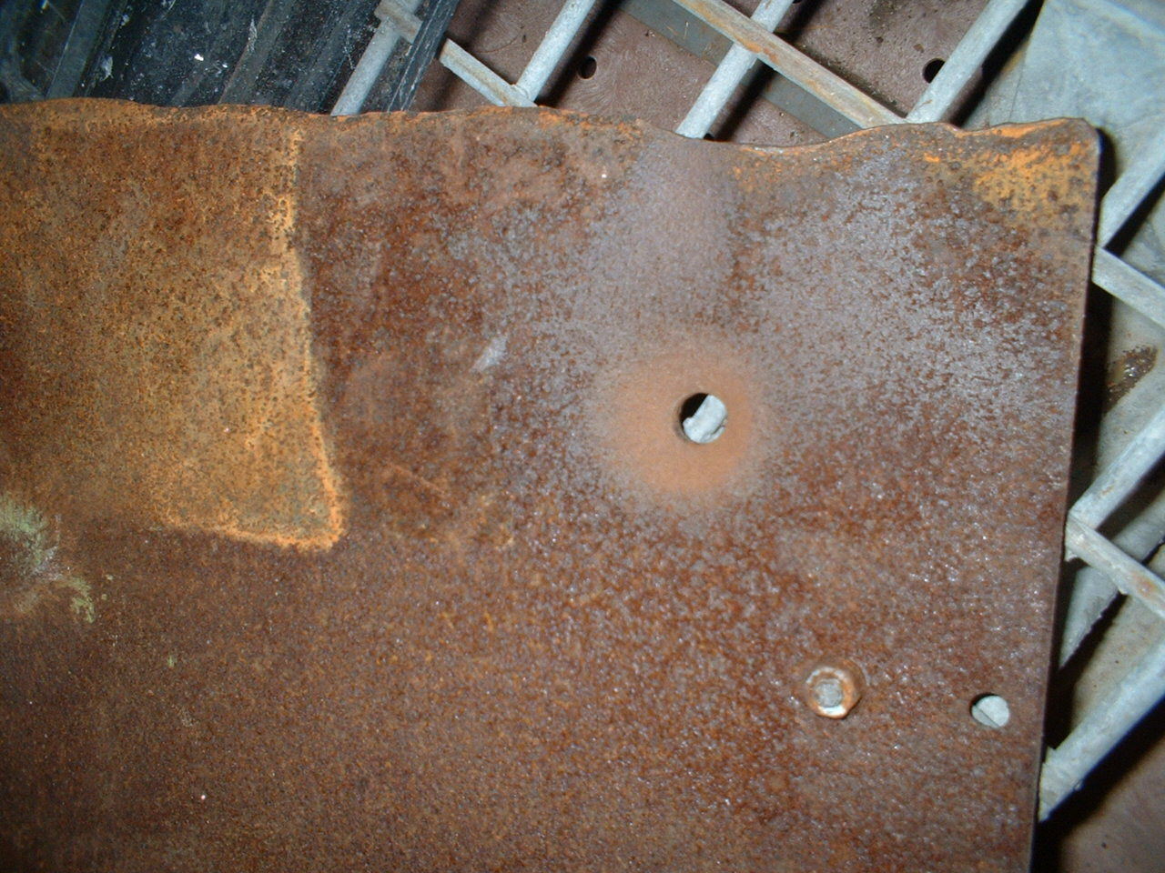

We made these today for testing purposes. Each weighs in at 85 grams and initial results are quite impressive. We were able to puncture 2" holes in steel roofing material. Check out the photos with 1/2" diameter steel insert easily cutting 1/8" plate steel and 3/16 HDPE 5 gal bucket. We were able to reuse these rounds until lost! We will be posting these on the web site shortly.

3/16" HDPE 5 gal
3/16" HDPE 5 gal
1/8" plate steel
1/8" plate steel
2" UHMW round weighed 85 grams

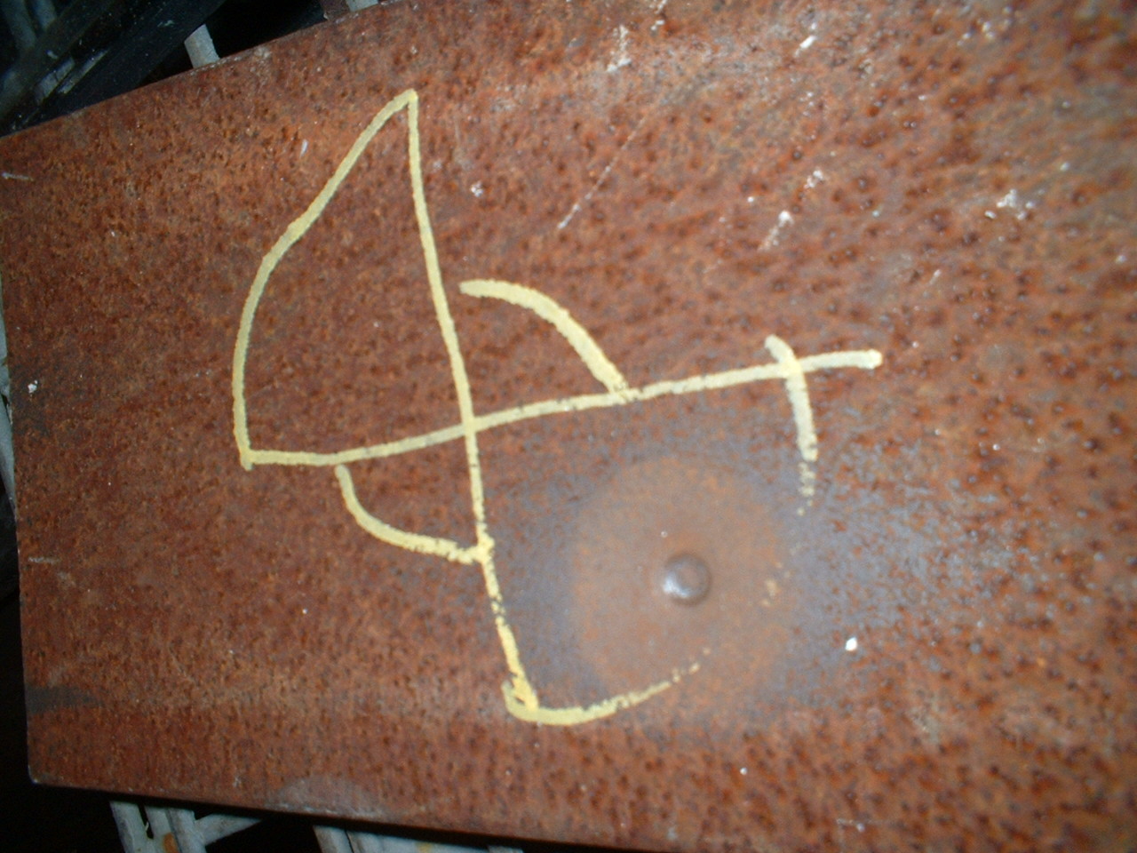

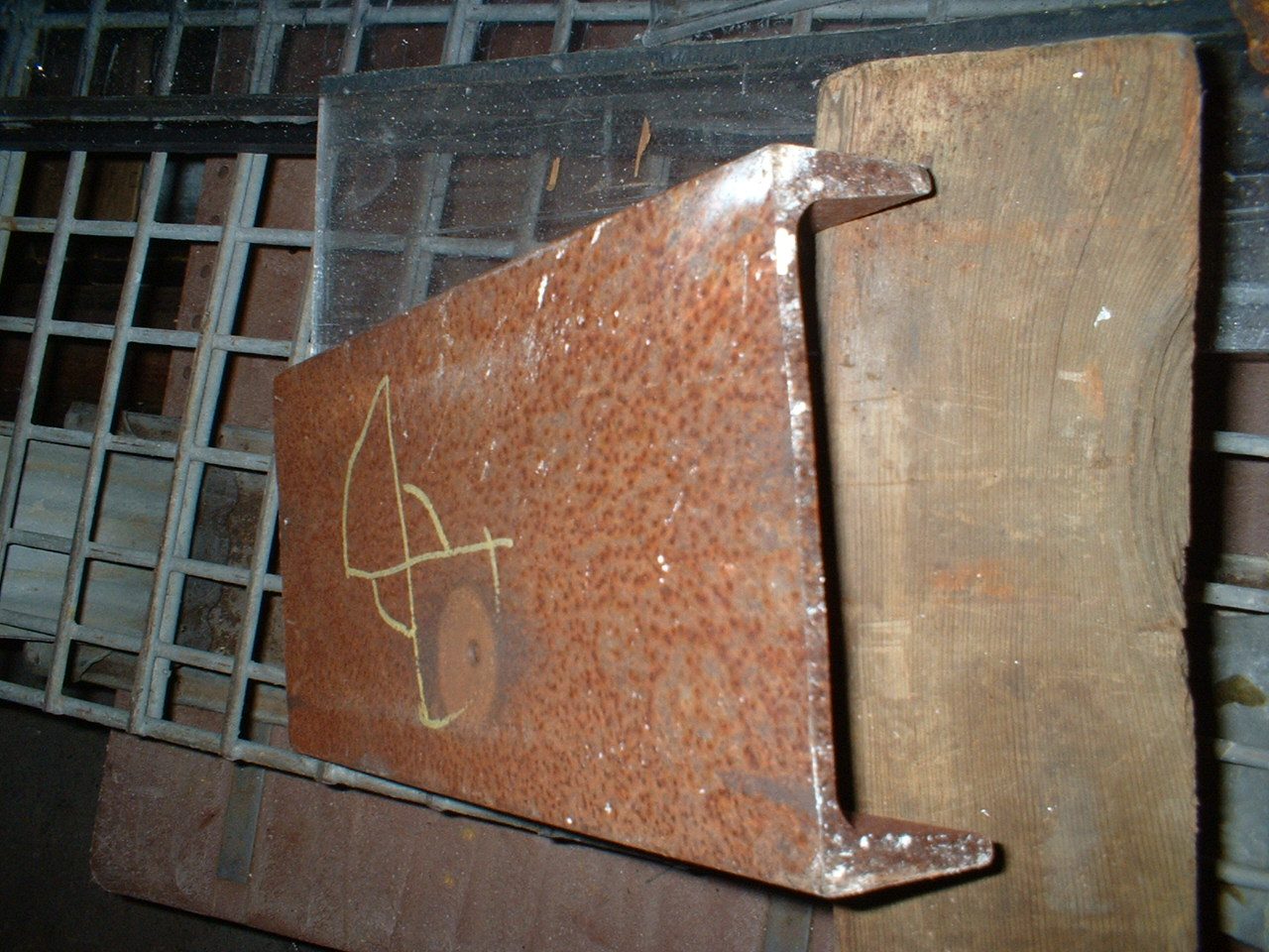

I was actually very surprised with the resiliency. I suspect if you were punching holes in plywood, it could last all day. Slight deformation for us occured when we hit the leg of a C channel. We successfully straightened with vice and reused again. Check out the photos of the C channel and failed penetration attempt. We will try with Carbide and the BL-625.
The O-ring grooves are fairly relaxed and adjusted so the round would retain itself in the barrel and no tighter. These work with any schedule 40 2" pipe.

1/4" C channel view 2
1/4" C channel damage

In all honesty, I really don't think the o-rings are necessary. Yes, they will keep any air from escaping around the edges, but with all of the added friction, I am not sure it is worth it. As long as they fit fairly tightly, you should get better performance without them.

The material came a tad smaller than the barrel ID and the O-rings help seal and hold the projectile in place. Agreed 2 is probably unnecessary. The size was adjusted so that there is just enough tension to hold in the barrel and no more. We use some PTFE super lube and I believe there is less friction loss than using spuds. For example, when we loaded this flush in the breach end of the barrel on the 520 you could pull it out by the inside of the skirt.
