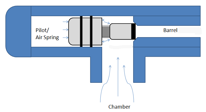

I have seen two types of barrel sealing "T" piston valves, and I was wondering which would have better flow, all other things constant.
There is the standard valve where the seat is the barrel halfway into the tee, such that it appears to be in the middle of the chamber port.
there is also this style:
about the UHMW, mcmaster also lists "unbreakable" oil-filled UHMW. This is significantly more expensive; is there an appreciable difference in their toughness?
The ones that come all the way to the center of the T block half the opening from the chamber into the T. The drawing above has the barrel flow obstructed by the piston as it moves back. The best is in the middle ground where the piston retracts out of the flow path. This makes the piston shorter and with less mass, which improves speed as well as flow.
My latest valves are shorter than their diameter.
Recommended modification improves flow and makes a lighter piston.

@Technician1002: Yup definitely better that way. Probably more like it would look like with real pipe fittings since a reducing bushing screwed into a T would look a lot more like that. I wasn't paying much attention to the dimentions of everything when I drew up that sketch. I'll definitely keep it in mind if I ever do build something like it.
@ramses: I was only consdiering that design for a hybrid made of metal pipe and fittings. My assumption was that I was not machining the metal in any way (because I do not have such equipment). I'm not sure how I would get the barrel to extend into the T with metal parts.

Well I do have access to machining facilities, so a custom made part is an option. My only concern is performance. Which would be more efficient, a traditional piston valve or the one you posted the picture of, tech.
