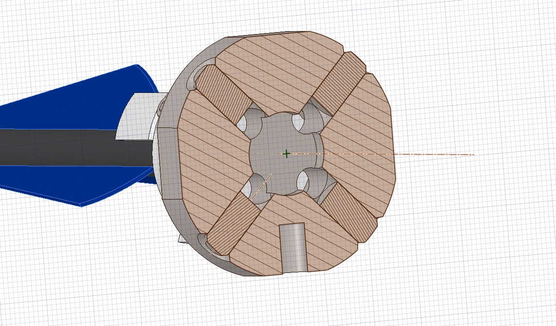

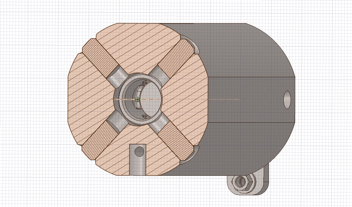

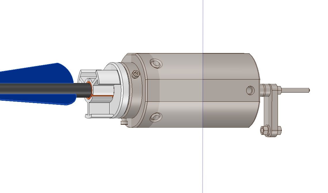

I have a barrel sealing piston of 12mm diameter. When unseated, the CO2 flows into 4 separate 6 mm diameter holes into the barrel. Is it possible for someone who has a feel for these things to give me your gut feel on what the valve flow coefficient will be?
I have attached a few pictures so that you can see the flow layout.

Thanks for taking the time to reply Matti. I am aware of the GGDT user guide info and that it suggests 30-50% efficiency.
Here is my problem though. I was looking at 1/2" QEV'S on the net to try get a feel for what kind of Cv they have and came across numbers I did not expect.
This 1/2" QEV is rated with a Cv of 8.8 ( http://www.versa-valves.com/quick-exhau ... less-steel). In GGDT that translates to 132% efficient. This 1/2" QEV ( http://www.humphrey-products.com/dynami ... s?part=QE4) is rated Cv 6.2 which is 93% efficient. So there is clearly something wrong here. I expect it has to do with unit values in various countries but it hasn't helped me much with trying to determine what the flow of my valve would be. So I was hoping maybe one of you gurus would have played around with valves enough to be able to guestimate a viable Cv for my valve
. Anyhow, I am going to see if I can do it with solidworks.
Thanks again.
