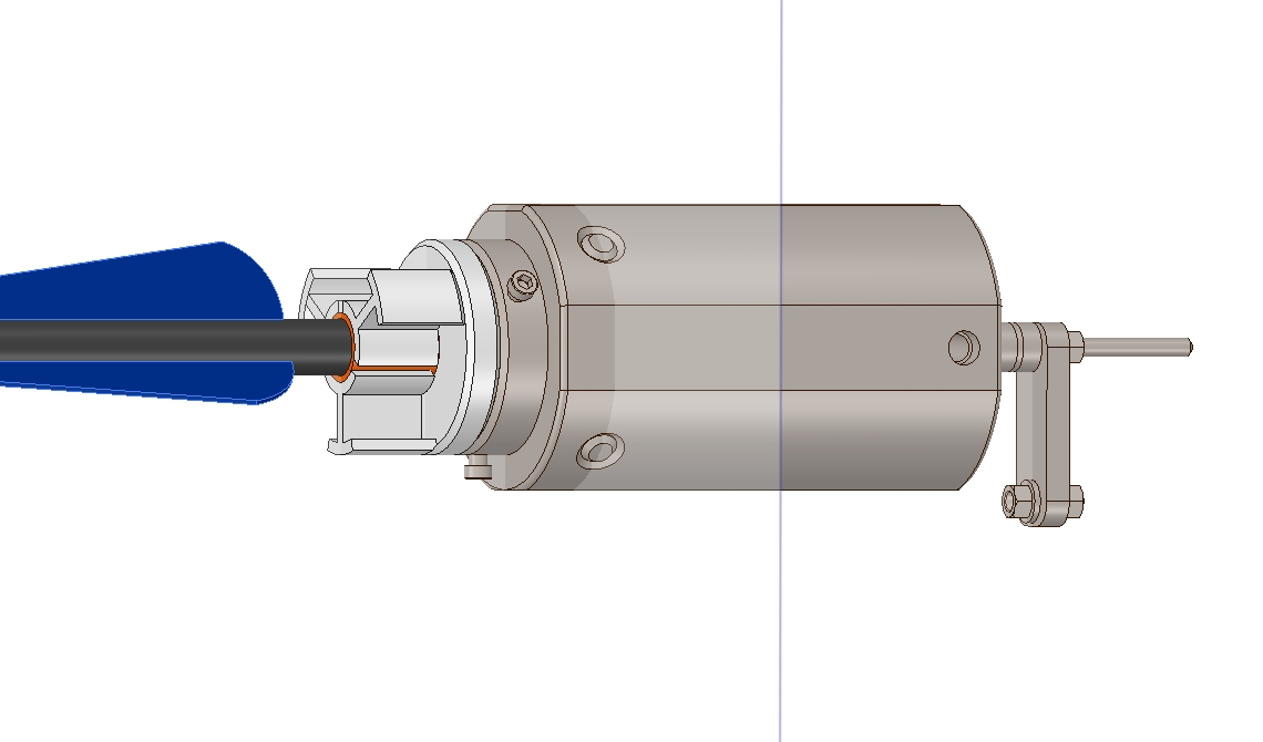

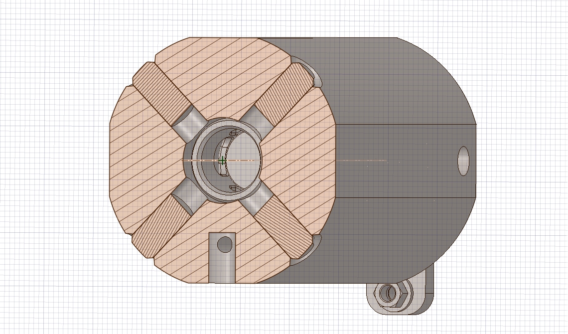

I have a barrel sealing piston of 12mm diameter. When unseated, the CO2 flows into 4 separate 6 mm diameter holes into the barrel. Is it possible for someone who has a feel for these things to give me your gut feel on what the valve flow coefficient will be?
I have attached a few pictures so that you can see the flow layout.

Thanks for taking the time to reply Matti. I am aware of the GGDT user guide info and that it suggests 30-50% efficiency.
Here is my problem though. I was looking at 1/2" QEV'S on the net to try get a feel for what kind of Cv they have and came across numbers I did not expect.
This 1/2" QEV is rated with a Cv of 8.8 ( http://www.versa-valves.com/quick-exhau ... less-steel). In GGDT that translates to 132% efficient. This 1/2" QEV ( http://www.humphrey-products.com/dynami ... s?part=QE4) is rated Cv 6.2 which is 93% efficient. So there is clearly something wrong here. I expect it has to do with unit values in various countries but it hasn't helped me much with trying to determine what the flow of my valve would be. So I was hoping maybe one of you gurus would have played around with valves enough to be able to guestimate a viable Cv for my valve
. Anyhow, I am going to see if I can do it with solidworks.
Thanks again.

I think CV/efficiency is about the outlet orifice size of the valve so you should know the exact inside diameter of QEV port to calculate the efficiency of the valve from the CV value ? Not sure what you mean by "GGDT that translates to 132% efficient" but clearly some input is wrong..
But still.. I don't know how to actually calculate the Cv or efficiency for your valve, have you searched google?
