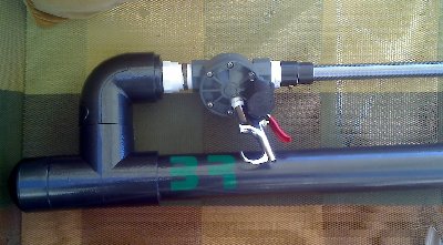

ist all good ,about the ball valva i went to bunnings the other day and got a sprinkler valve and modded it with a blow gun,it awsome now steady as a rock...and accurate ill post a pic tommorow its 11.00pm ..

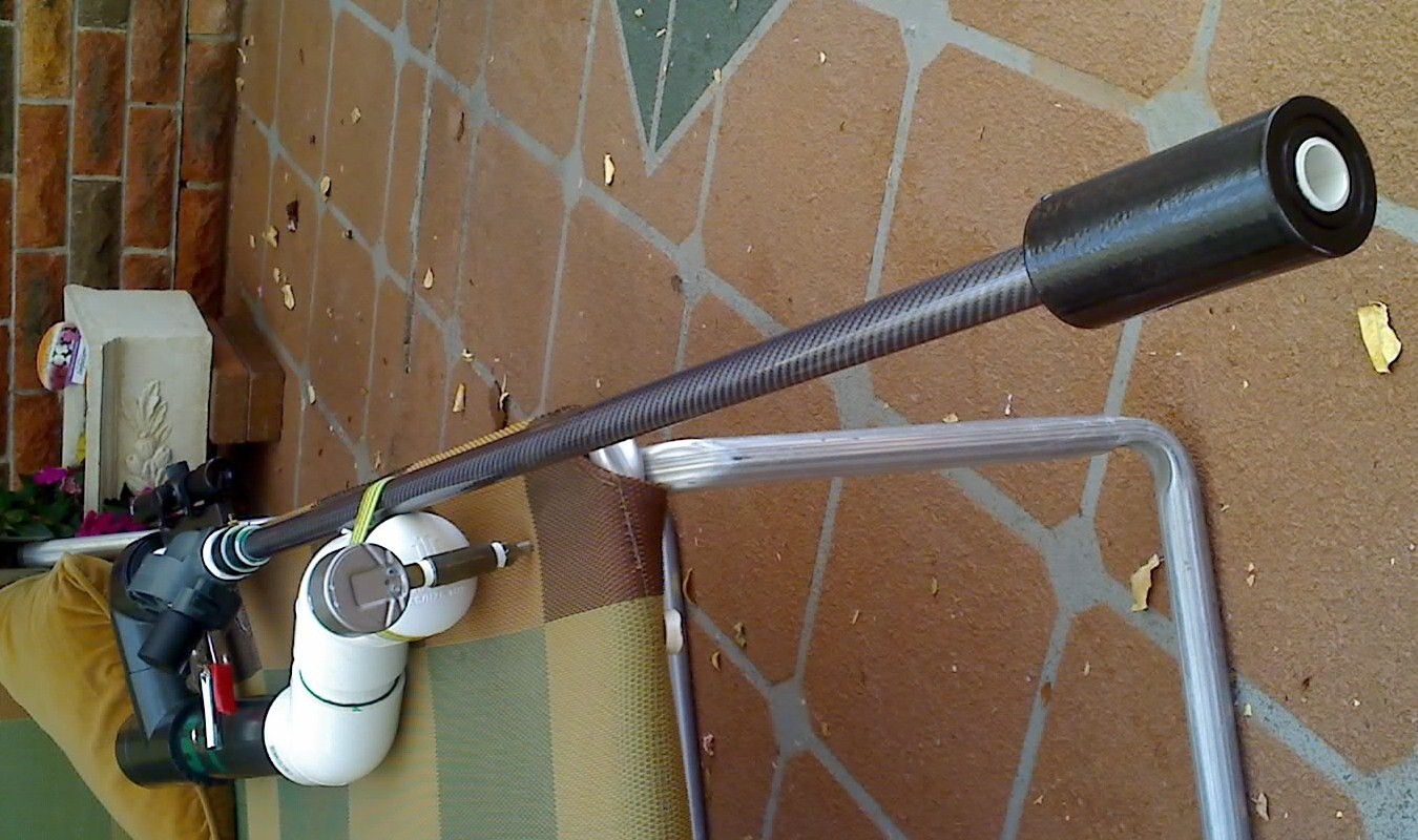

frozebyte wrote:Don't think it was necessary to spend the 50bucks on a carbon fiber vinyl to strengthen your pvc pipe. That amount could've built you a nice copper gun or two.
Considered saving those for another project?
and the vinly was used for another project of mine not this one ,i wraped my laptop shell with it and had leftr overs... :wink:
frozebyte
Posts: 136
Joined: Wed Jun 24, 2009 7:22 am
could've saved those leftovers for a sleek spudgun, i think the carbon fiber would make even a pvc gun look super sleek like a copper one :wink:

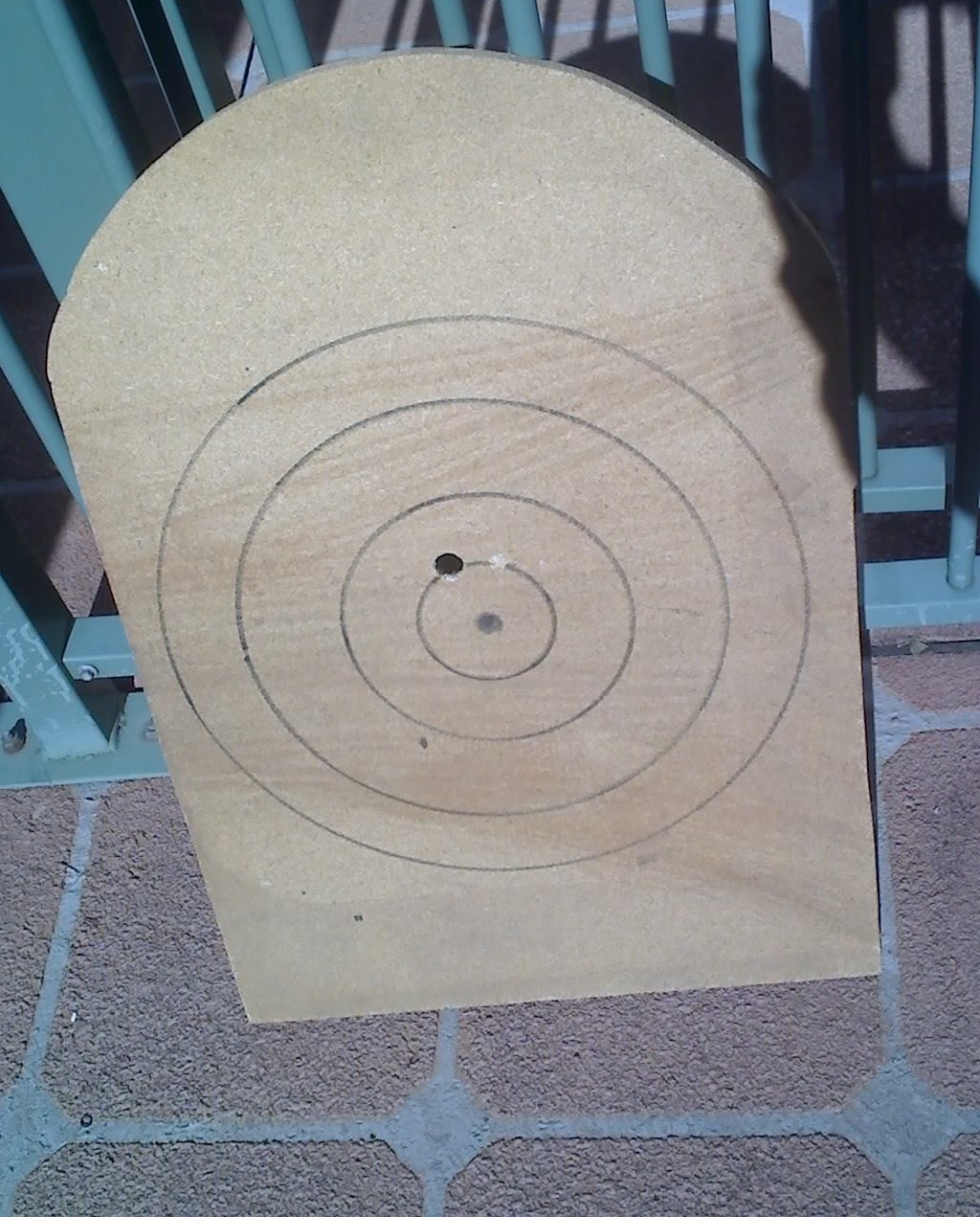

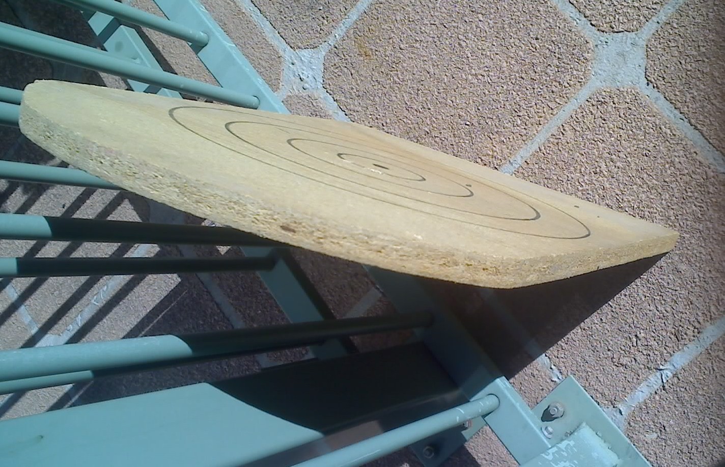

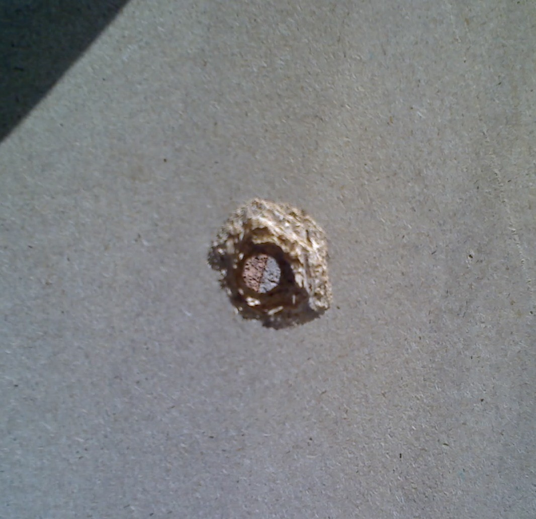

just an update to my last post, the modded sprinkler valve and a damage shot...
20mm thick particle board
exit wound...
exit wound...
the target entry hole next to bullseye,this was my first attemp at the target

new valve,,had to mod it on side of caseing because of guide rod..

see how much more powerfull the sprinkler is? i personaly have not used one but they are much better than a ballvalve but still not a piston valve.
Shame the chamber is still so big relative to the barrel, you're getting a lot of extra noise and filling effort without any real performance benefit.

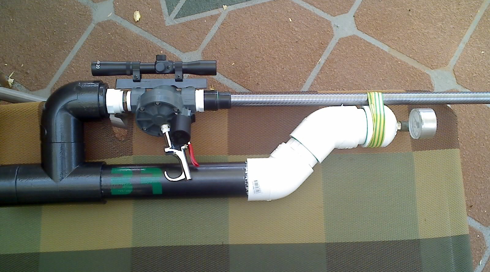

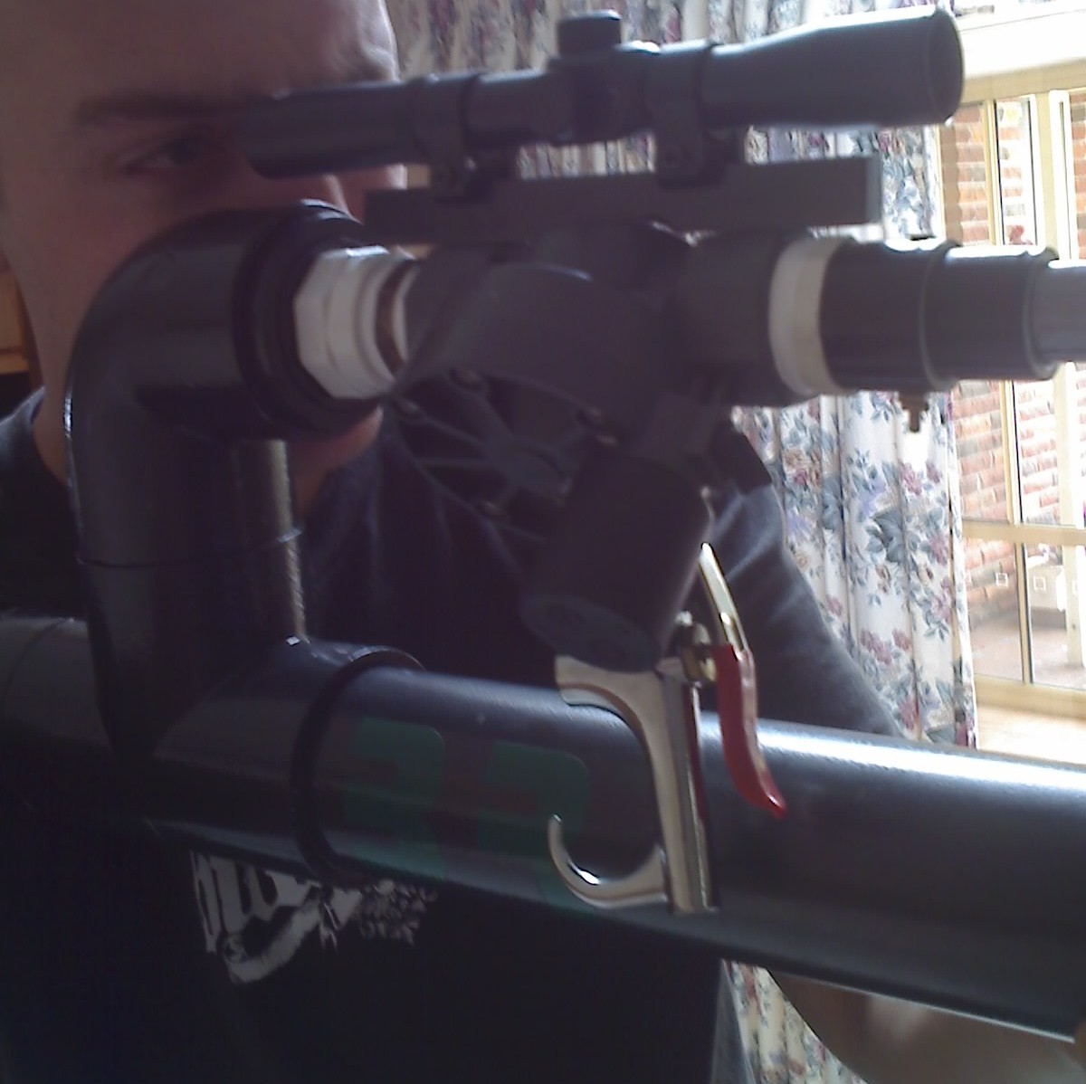

updated with scope mounted on a aluminium bar,fits perfectly. :arrow:
ergonomic...
ergonomic...
view looking through scope lens,it has improved aiming tenfold .

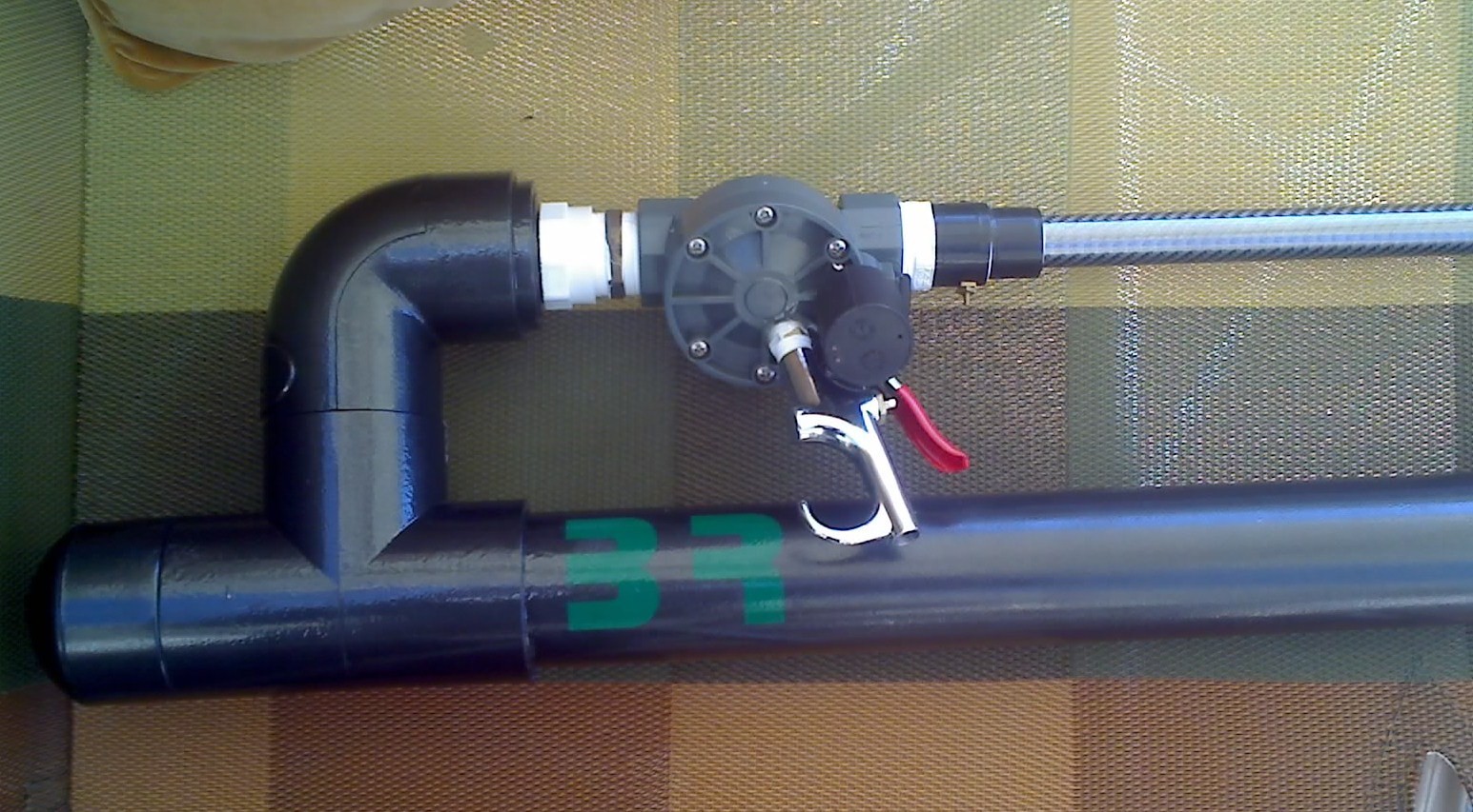

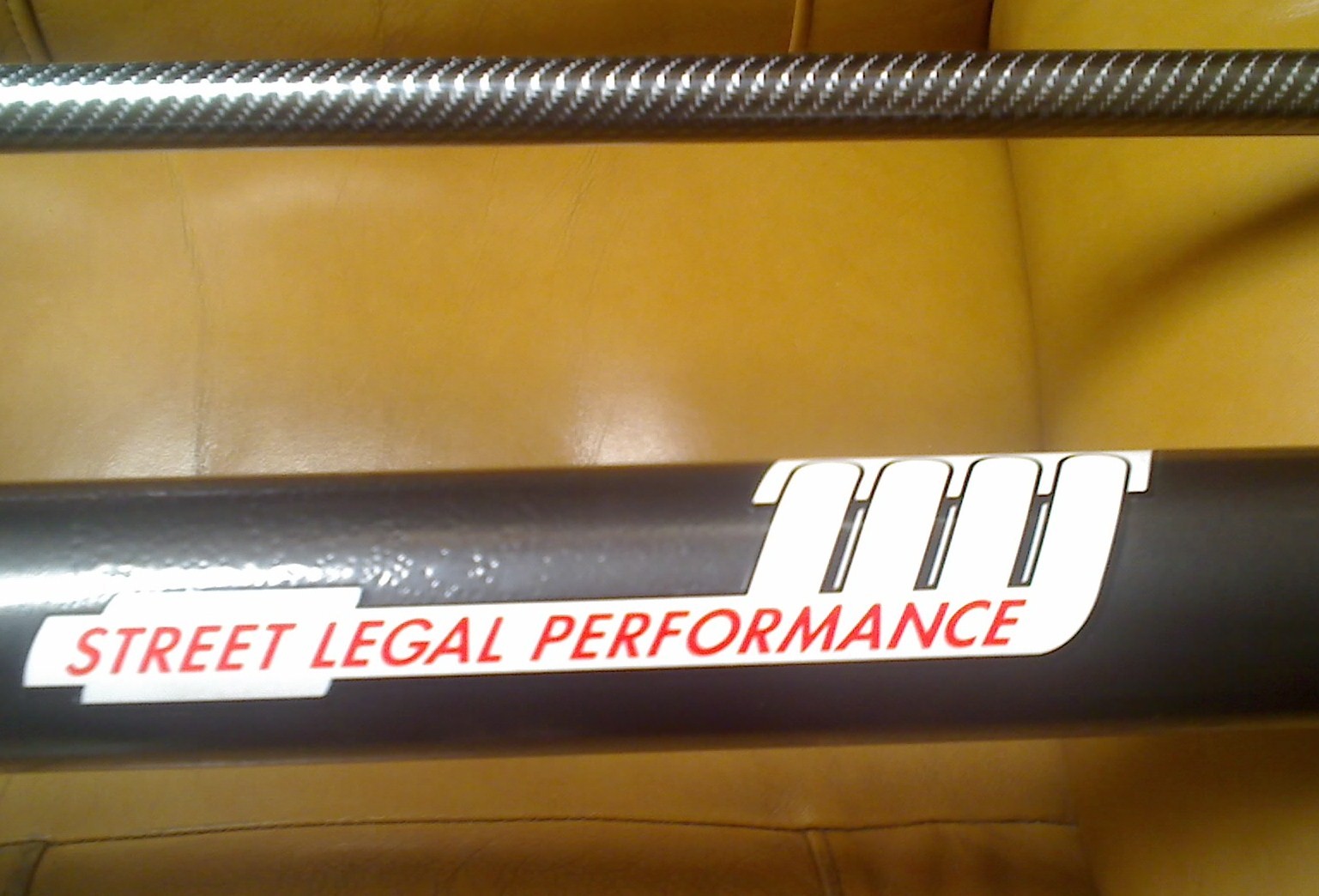

new decal
new decal

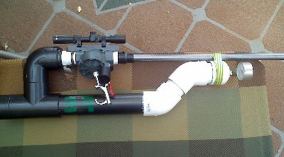

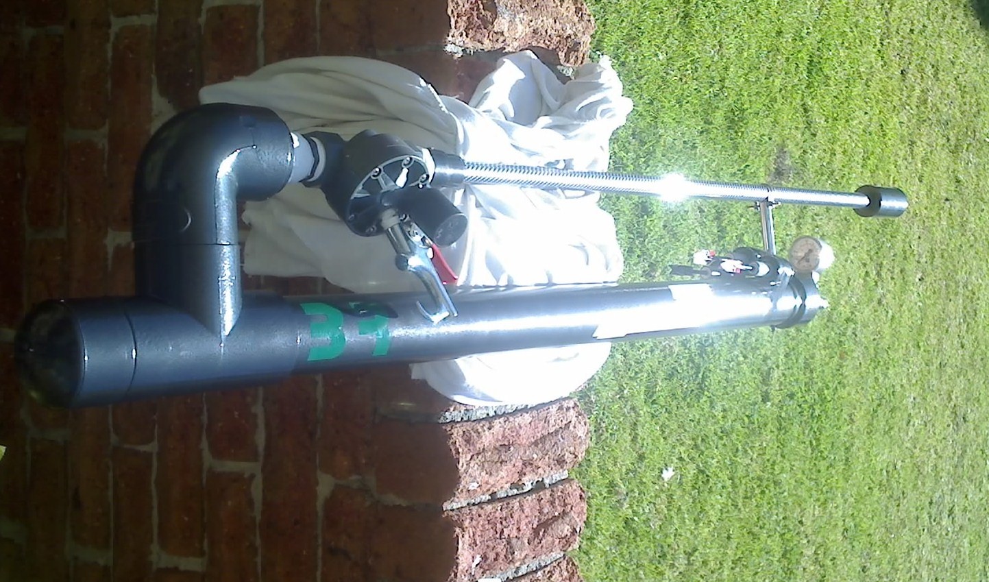

just wondering weather this would be an exceptable chamber lenght?
full lenght ==chamber 700mm including tee elbow,,barrel lenght=950mm have i gone too far?
x2  45 degree bends,, and x1 end cap
bored.
bored.
Have I gone too far?
Not far enough in my view, capping the Tee with no extra pipe is enough.
Of course more chamber = more power but it gets to a point where you might increase chamber volume to 200% and get a power increase of 2%, ie not worth it. It depends what you want. I personally would chose silence and convenience.
Have you tried plugging a few numbers into GGDT to get an idea of what sort of performance increase/decrease you're talking about?
