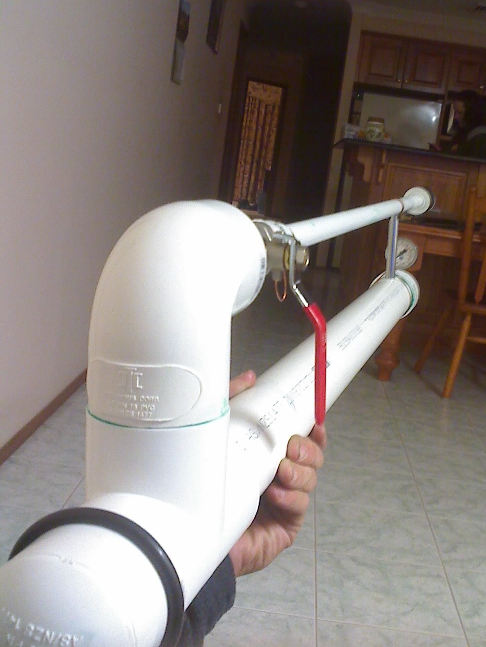

well here she is my first pnumatic cannon

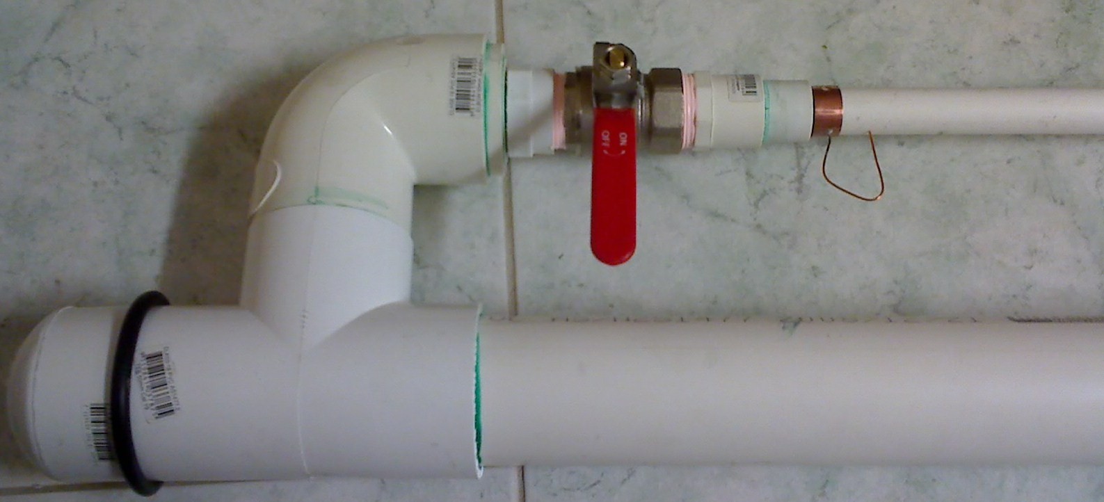

im using basic pvc pressure pipe with a very loose ball vavle,i didnt have the time to look for a modded valve but all in all she works good...
ive fired it at a bunch of towles i had hanging on the cloths line at 80 psi, with a marble.. it went straignt threw five layers of towleing!!! i cant believe it........ the barrel is the perfect size for a marble ,,im now throwing my combustion cannon to the shitter and embarking on my pneumatic cannon journey.. :idea: :idea: :idea: :idea:
just an update there are photos on page 2 and 3 for the sprinkler valve setup and shortend chamber

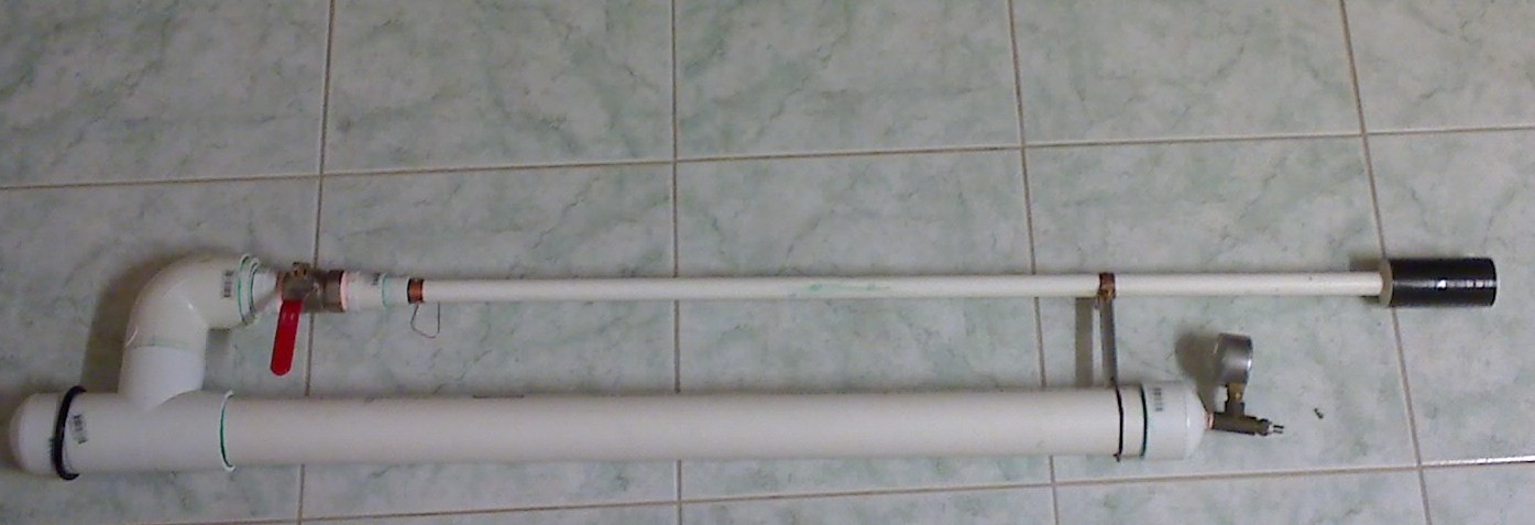

there she is (1250 mm long)

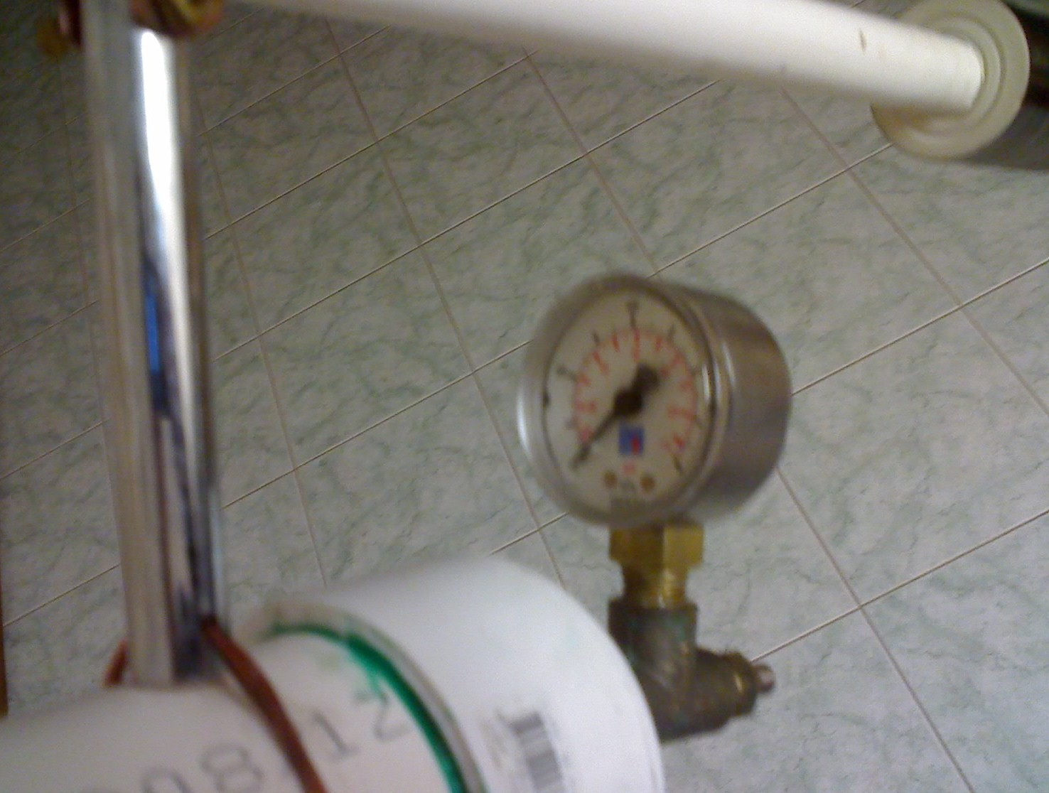

gauge setup ,shrader valve and brace to support the barrel
about 4 hours work on and off

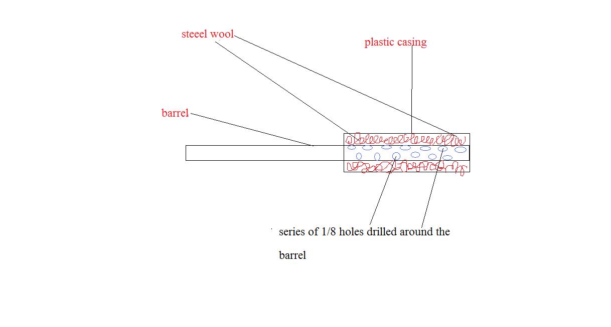

well ive had this idea of modifying my pretend suppressor (atm) just wanted a few thought on the below diagram..
will it benifit at all or its not worth it?????

Nope, your chamber is too massive for any reasonably sized suppressor to have a difference. If you hacked up a rubbish bin into a suppressor it might partly silence it.

inonickname wrote:Nope, your chamber is too massive for any reasonably sized suppressor to have a difference. If you hacked up a rubbish bin into a suppressor it might partly silence it.

im glad u answerd that before i started drilling holes in my barrel,which brings me to my next question,,and like u must off read my mind,because i was about to ask the question on what a piston cannon is??? and how does it work??? diagrams would be good....
