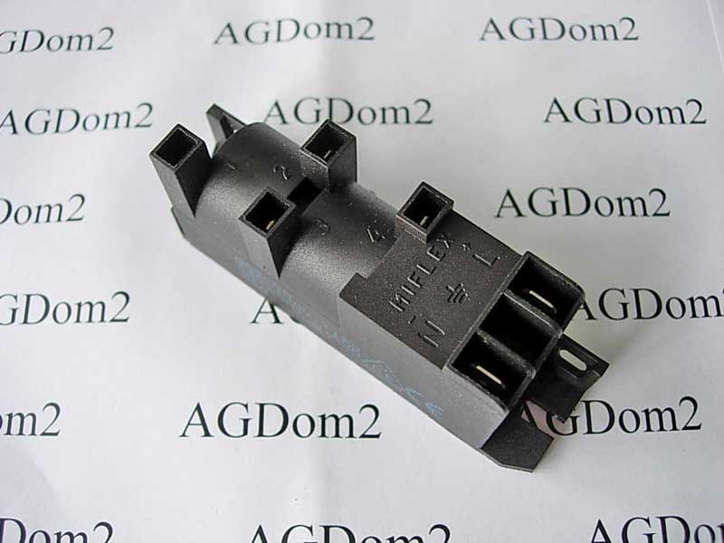

so, fuelling is not an issue? Any idea where can I get BBC piezos (yeah I know that're using one from a lighter - I am asking about BBC piezos) ?
Sorry for going off topic, but does anyone know if it is possible to hack one of these to work on DC...
(these modules are used on gas ovens for creating a spark... That fact, and the fact that there are letters 'L' (for line I suppose) and 'N' (neutral) suggests that they run on AC... But why there '+' and '-' signs there ?? It's a bit confusing...) ->
http://allegro.pl/generator-zaplonu-isk ... 35616.html
EDIT
No... that particular model runs on AC....
But there are versions that run on DC and they are produced about 100 km from where I live!
Looky here
http://www.miflex.com.pl/eng/generatory/W09-2A.pdf
What do you think is it a good find ?

Any idea what's inside the unit you posted?

Aren't BBQ ignitors just like cigarette lighter ignitors if you take them apart?
AFAIK they are larger and last longer
No idea but it's a ready made module and depending on the exact model it can be used for up to 6 spark gaps
I got the reply from the manufacturer and I can get one for 6.5$ a piece - seems pretty cheap. These things are definitely considered as heavy duty stuff when compared with all those BBQ ignitiors produced in china.

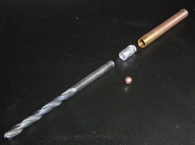

How do you plan on sabotaging the .177" BB?

JDP12 wrote:How do you plan on sabotaging the .177" BB?
Surely you mean "saboting" ;)
I was thinking of using this method using metal foil instead of paper, if it works well I'll make a proper how-to.

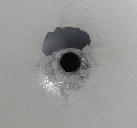

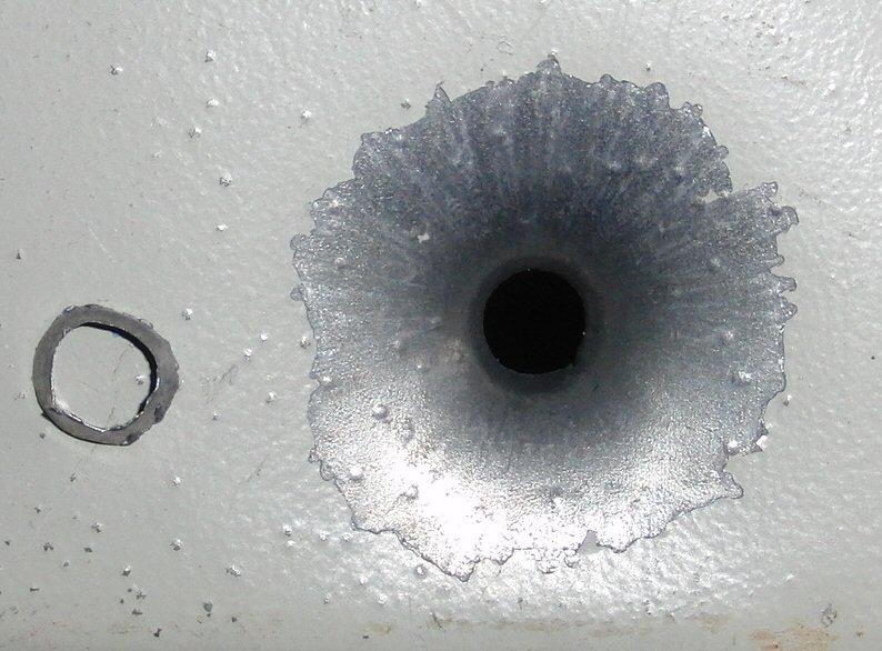

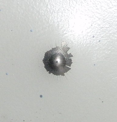

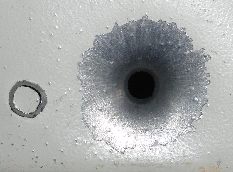

edit: This project persists in being made of WIN! :D some further results:
-saboted 0.177" steel BB (see pictures for foil sabot construction) - full penetration of a sheet of 0.6mm steel, denting a second sheet
-10 mix with lead pellet - first click ignition and full penetration of a sheet of 0.6mm steel
The question now is, do I quit while I'm winning, or go for 11x?
dent at the rear of a second steel sheet after initial 0.177" BB penetration
entry hole with saboted 0.177" BB, note that some flecks of foil from the sabot are visible next to the hole
self explanatory foil sabot construction for a 0.177" BB
entry hole with a 0.22 pellet at 10x, note the pellet skirt to the left of the hole which separated on impact
