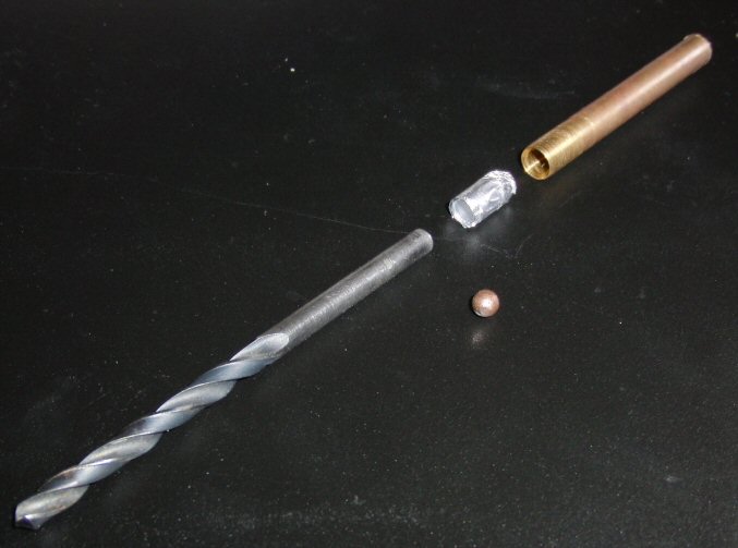

I was thinking of using this method using metal foil instead of paper, if it works well I'll make a proper how-to.

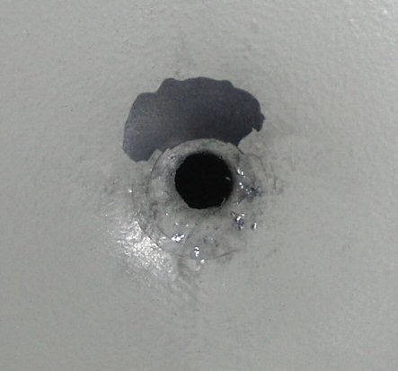

-saboted 0.177" steel BB (see pictures for foil sabot construction) - full penetration of a sheet of 0.6mm steel, denting a second sheet

entry hole with saboted 0.177" BB, note that some flecks of foil from the sabot are visible next to the hole
self explanatory foil sabot construction for a 0.177" BB
