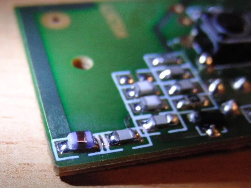

On a different topic, I'm lead to believe the component in the bottom left corner of the board is a capacitor and the copper trail leading above is the antenna of the transmitter? I read that someone suggested cutting the copper antenna line and soldering a coaxial cable to the capacitor with the other end of the coaxial cable wired to a 433.92MHz antenna with an SMA connector. Good plan or...
Edit: Oh and do I need an antenna specifically for the 433.92 frequency? I can't find any at my local electrical store, most operate in the GHz range.

Before modifying an antenna, be aware that using a coax to remote an antenna works best if the circuit is already the nominal impedance of the coax. For example to remote a 50 ohm antenna, 50 ohm coax can be used. In many printed circuit applications the onboard antenna is not 50 ohms and adding the coax will de-tune the transmitter and reduce the range. Do not attempt to modify an antenna unless you are able to retune the radio properly. In the US changing a transmitter antenna of a self contained type accepted radio transmitter is illegal.
Ah thank you for that, Tech. I had read a guide to making a PCB antenna that went through some steps such as matching the impedance of the components but wasn't sure if I would have to do the same. It looked a bit difficult for me since he had a bunch of equipment to do it but I'll keep searching around for other ways.
