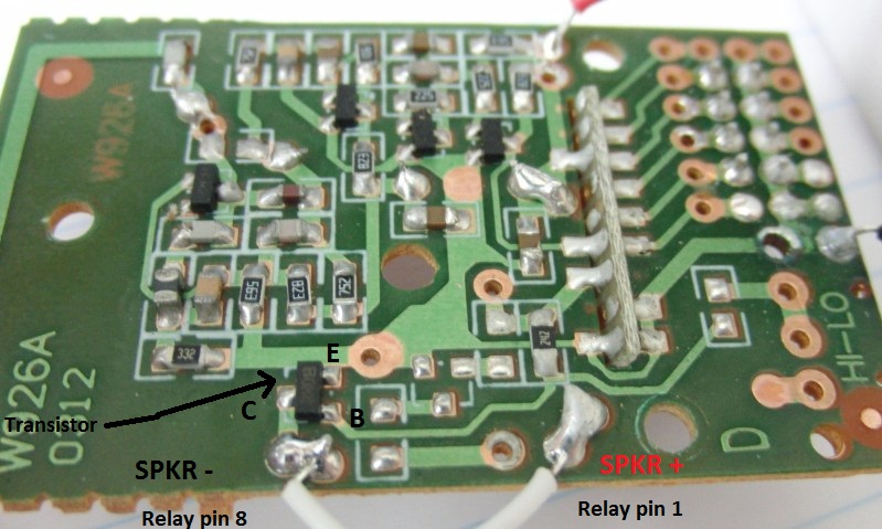

I read somewhere that transistors can be used as switches, particularly in low voltage applications. Should I stick with a relay or is there promise in using a transistor as a switch (how ever its done)?
I also noted some people use a diode to protect the transistor that amplifies the signal before a relay, is this something I should also follow?
If you guys have any other ides about a switch for this circuit, don't hold back as I'm open to other ideas. What ever is easiest is best since I'm a complete electronics novice.
The diode should be added to the coil of the relay which will protect the driver transistor from inductive voltage spikes.
I will draw of a schematic for you using relay 5.
Can you post close up pictures of the speaker transistor from top and bottom of circuit board?

Didn't know there was a transistor/where it is on the circuit so I just took a bunch of photos that you can view here:
http://s75.photobucket.com/albums/i290/ ... 20circuit/
