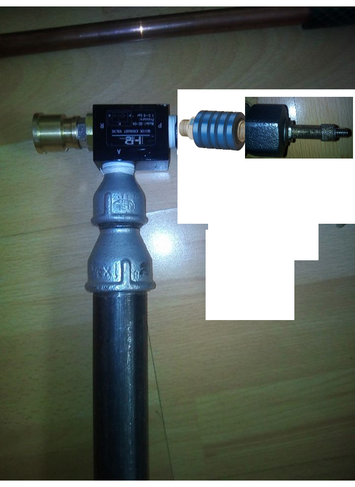

that china qev would be able to hold 450 psi?? Air blowgun is for 12 bars , qev for 8 bars
Will Beto SP-002AG 28bar shock pump be able to pump 28 bar to chamber or this is fake? and this will happen [youtube][/youtube]
If i will put bigger chamber i will get more power?

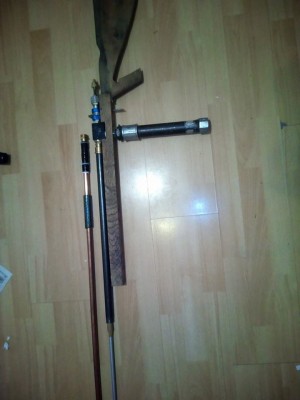

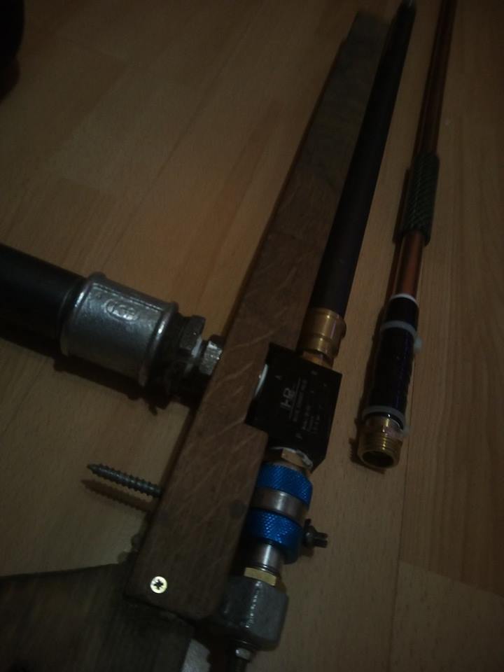

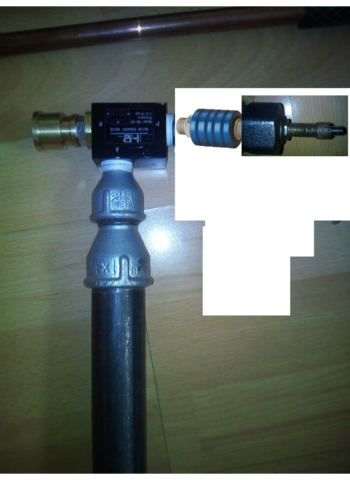

Haniball1337 wrote:that china qev would be able to hold 450 psi?? Air blowgun is for 12 bars , qev for 8 bars
While exceeding the manufacturer's specifications is never advisable, QEVs of this design have been taken beyond 500 psi by the members of this forum. As to the blowgun, this will be too hard to operate at this pressure so a ball valve pilot would be a better idea.
Your chamber is too large for a shock pump, it will take you forever to reach 450 psi.
Your best bet is an airgun pump like this one, alternatively a fridge compressor is a way to get that pressure easily and cheaply as per POLAND_SPUD's tutorial.
Not really, more pressure is the solution. Alternatively, if this is not an option, consider going up in caliber. If you keep the same setup but change for a 19mm barrel firing 0.75" steel balls, you will get double the muzzle energy.

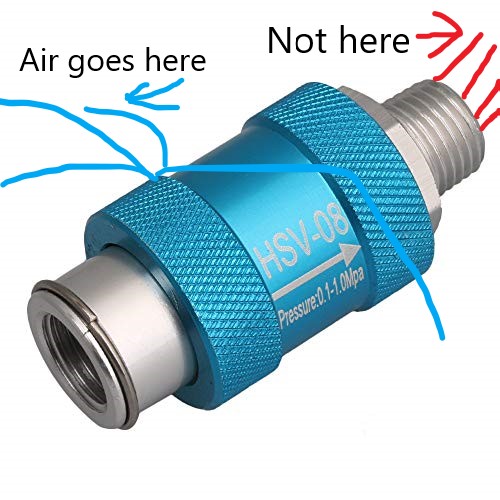

Slide valve is good too but , how is this working? He have compressor Hooked up and he is shooting all the time ? Can someone explain me ,
Posts: 26220
Been thanked: 352 times
The slide valve simultaneously shuts off the air supply from the compressor and vents the pilot to the atmosphere, here's an animation by clide that explains it quite clearly:

So if i will do that it will work? (This is bicycle valve ), If i good understand the air doesnt go behind the slide valve but from above? So if i understand it can be little better than that one with air compressor gun ?
Posts: 26220
Technically it's more like this but yes, you get the idea. It will work as you drew it.

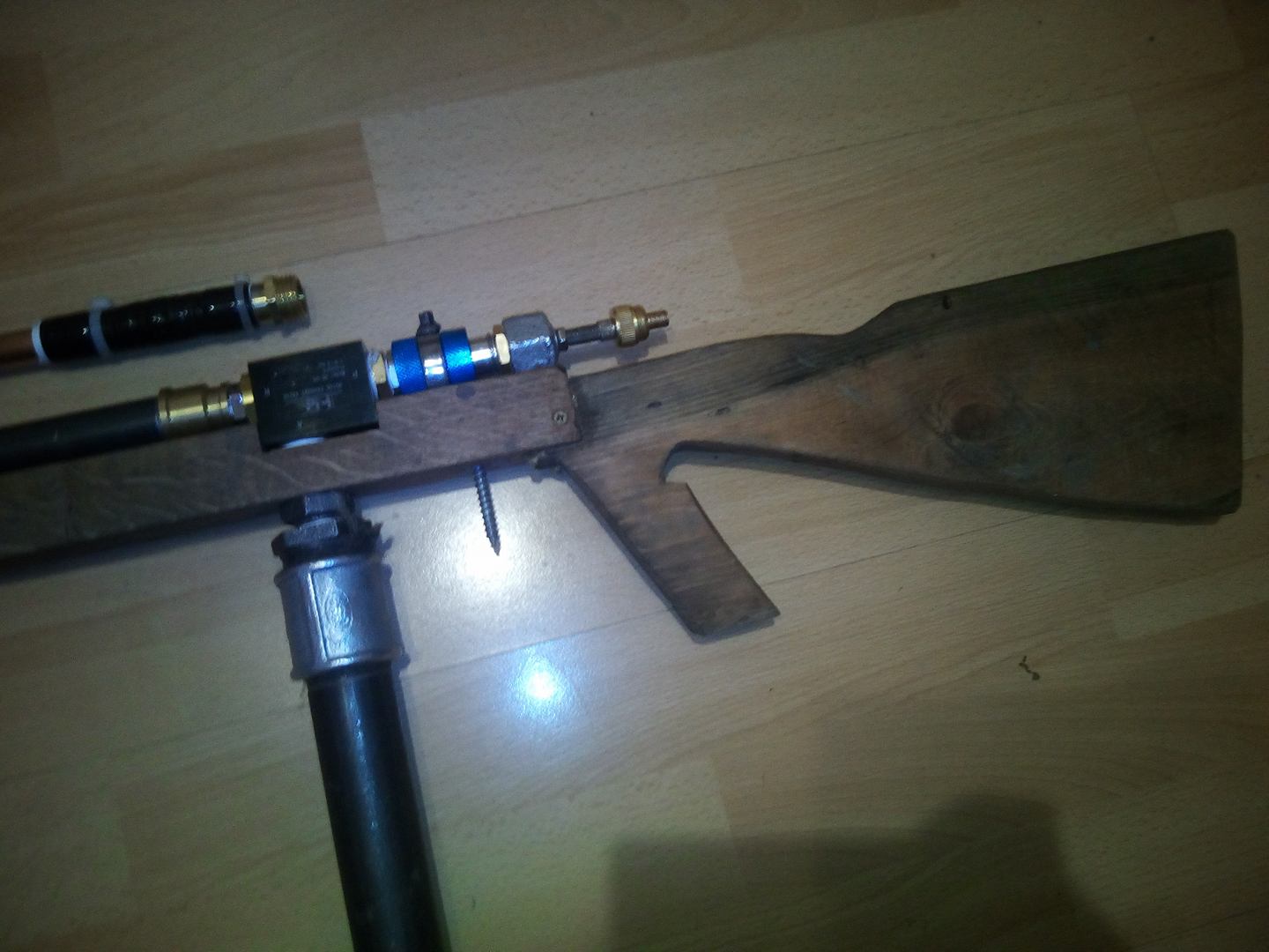

i wanted to make something similar to this , if i will do that it will work? It will be multi shot? I want to use 8 bar pressure
Picture: https://zapodaj.net/2c9fa8a553649.jpg.html
Posts: 26220
It will work, but are you actually planning on using a plastic bottle as a reservoir? You're better off locating a paintball bottle or fire extinguisher, something that will take higher pressure and possibly including a regulator to give you more shots per fill.

I think i will use fire extinguisher , i want only to get 3-4 shots like him

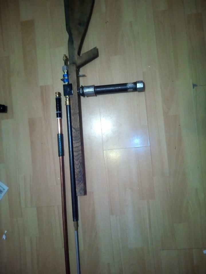

So i came up with this :D I think it is good , i can hit the can of pineapple from 20 meters ;D
farcticox1
Canada
Posts: 1089
Has thanked: 69 times
Been thanked: 106 times
I like it :D maybe something over the screw/trigger :idea:
Reminds me of a Thompson, that's a good thing.

Thanks guys for help :D
Posts: 26220
Good job! Now find yourself a high-pressure pump and do some real damage :D
