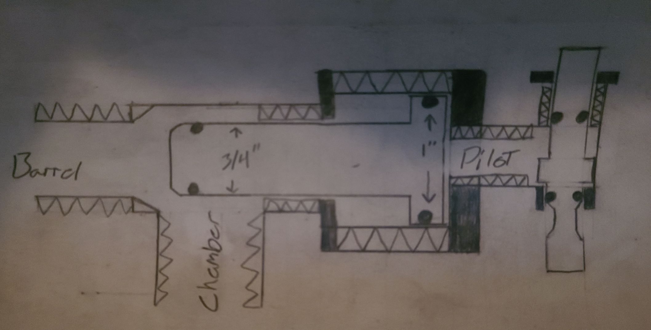

Also it is a barrel sealing piston. The "face" sits inside the barrel instead of pressing up against it. The rear oring is a "floating oring" so air passes one way to fill the chamber. It cannot flow in reverse.

PracticallySane wrote: Sun Dec 27, 2020 10:42 am Also it is a barrel sealing piston. The "face" sits inside the barrel instead of pressing up against it. The rear oring is a "floating oring" so air passes one way to fill the chamber. It cannot flow in reverse.
His drawing is very clear, which is worth ten thousand words! THANKS! :)
The barrel side oring is what seals. I like the concept, because it is simple.
The "floating o'ring" lets air pass from the exhaust valve on the right to the main air chamber on the left and below.
Thanks for the drawing. In the future I will try to do something with this idea, a hybrid for sure.

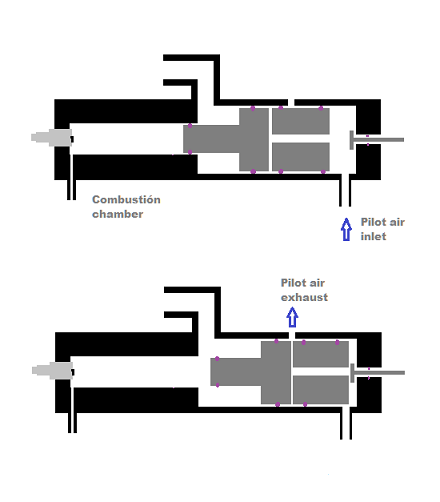

I built a valve like the one you use, but very small, it is for a future hybrid short gun. It works wonders and I no longer have the problem of burning the front seal, nor doing it, nor aligning it absolutely perpendicular to the barrel so that it seals. The smaller diameter is only 6.35mm and the larger piston is 8mm. I only bought about 50 6mm o'rings, which are what I used in the part that seals the combustion chamber. Add a system so that the pilot is open after the shot, because I need air to be able to come out of the barrel to clean the chamber immediately after the shot. It has a stem to close it before pressurizing with butane and air. When I can, I'll leave some photos here.
Argentina
Posts: 1064
Location: Argentina
Has thanked: 274 times
Been thanked: 276 times
válvula de sello con oring.png (16.95 KiB) Viewed 11456 times
This is the drawing of what I built.

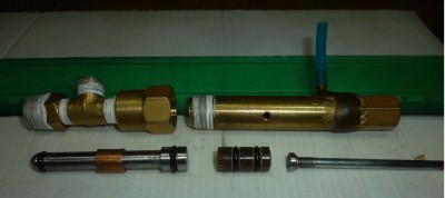

A photograph of how it was. I am building a mechanism so that it closes automatically. The small piston with two o'rings and the hole in the center is for decompressing. It is fiberglass because it only supports 6 or 7X pressure. The hard part is the one that seals the chamber.
I leave here in this publication what I did, because I think it is not necessary to make a new topic, it is a comment of the same.

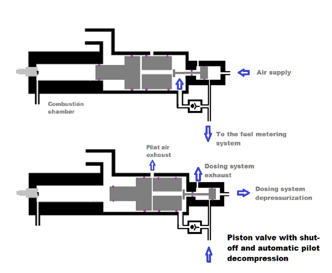

Add what was missing to get the valve closed automatically. It works correctly, luckily. The valve closes when you let in compressed air and the pilot depressurizes immediately after firing.
The dosing system that I am testing needs to be able to decompress to measure the right amount of butane, it is of the volumetric type. I'm thinking of adding a 60cm firing cannon, with 12 microstriae that I bought a long time ago, caliber .25, and firing ordinary pellets 8-)
