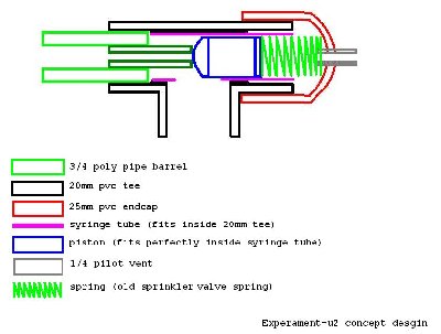

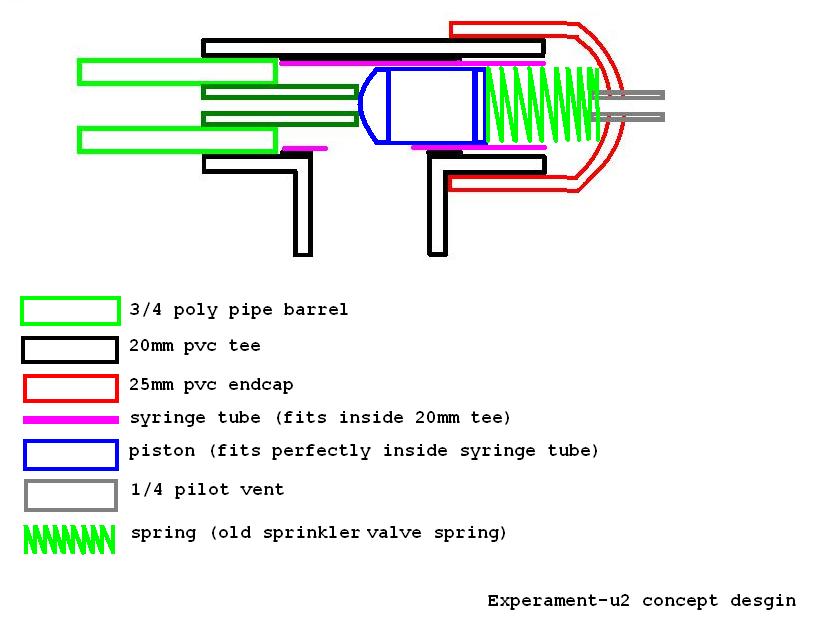

i never thought of that being the problem il open her up soon and take a look and do some measuring but here's a concept iv being working on
(the dark green tube not labeled in the diagram is 1/4 300psi bit of air hose)

there u go that should work...how r u keeping the air hose firm? hope uget it working!

spudthug wrote:there u go that should work...how r u keeping the air hose firm? hope uget it working!
the air hose is pretty thick and in a short length stays pretty straight and firm

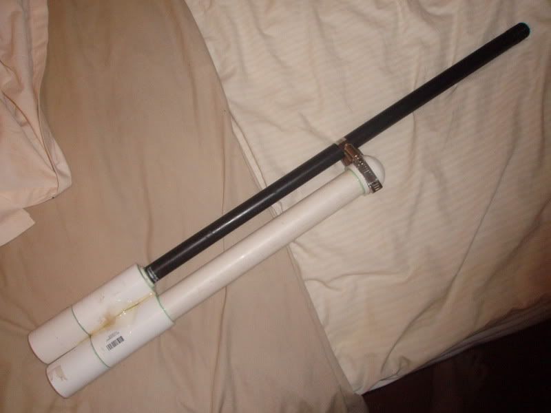

this is my second piston gun, my first was a little bb gun that rocked until the oring on my piston broke and iv being unable to find another one the same size (oh and yes that is 2 tee's epoxied together)
heres a pik of it without the trigger system on

chaos
Posts: 1205
That BB is sweet U2, man i hope ya get ya piston problem solved mate it will be another great aussie piece (as always :lol: ) when its done :D
to bad ya o-ring broke on ya bb that is a great little gun ya got there i hope you fix it soon 8)

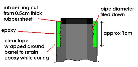

Nice to see someone else veering away from standard parts and getting their hands dirty with epoxy, looking good U2 :)
If I could make a suggestion though, this is how I put the seal on the barrel of my small 3/4" pistons (making another one at the moment ;) )
The diagram should be pretty much self explanatory.

jackssmirkingrevenge wrote:Nice to see someone else veering away from standard parts and getting their hands dirty with epoxy, looking good U2 :)
so the sealing face is on the barrel not the piston?
or is there one on both?
oh and off topic what is your display picture jack?
EDIT: i just noticed its a tablet of some kind
the sealing face is on the barrel only, a bit like my pengun project.
My display picture is a pistol cartridge in a pill packet, made it from a photo entitled "sleeping pill".
