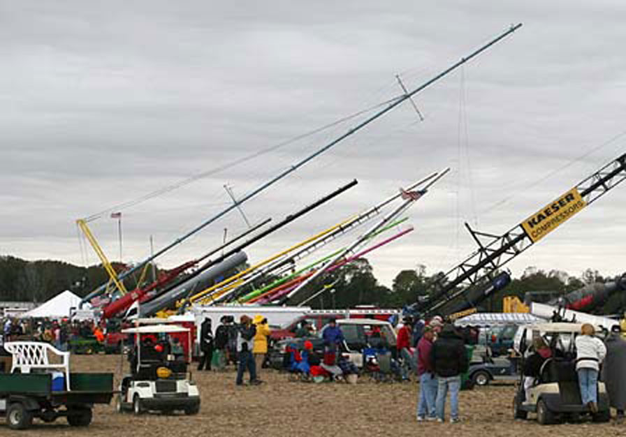

Another interesting thing I noticed when reviewing videos this weekend, is that they seem to be firing at more than optimal angles, 45+ degrees, which may be because there are serious air currents at 600+ft..., or maybe they subscribe to the fallacy that 45 degrees is the best angle...
jeepkahn wrote: Another interesting thing I noticed when reviewing videos this weekend, is that they seem to be firing at more than optimal angles, 45+ degrees, which may be because there are serious air currents at 600+ft..., or maybe they subscribe to the fallacy that 45 degrees is the best angle...
This is most likely an illusion. Many shots from behind the cannons make the barrel angle appear higher than it really is. Keep looking. Find photos taken directly down the line of fire. They are way under 45 degrees.
Shots from behind and with telephoto to try to catch just the pumpkin and muzzle blast will appear to be nearly straight up.
Side view of air cannons.
