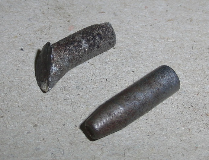

More than a couple of months ago I had fired a steel core from a 7.62 AK round at a steel plate, it zinged off and never found it... until today! Here it is next to a relatively intact example:

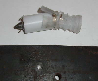

- Has thanked: 581 times

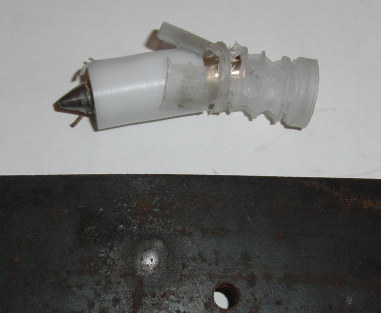

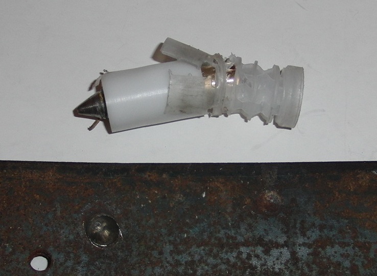

I decided to have another go at my nemesis, the hardened 1/4" plate.
Didn't quite go as planned, as a "tail" I put a push fit delrin tube, which seemed pretty tight. As always, I underestimated the forces involved. The inertia of the core on acceleration pushed it through the tube and into the shotgun wad, resulting in a very weird projectile actually hitting the plate. Still, pretty impressive damage.
